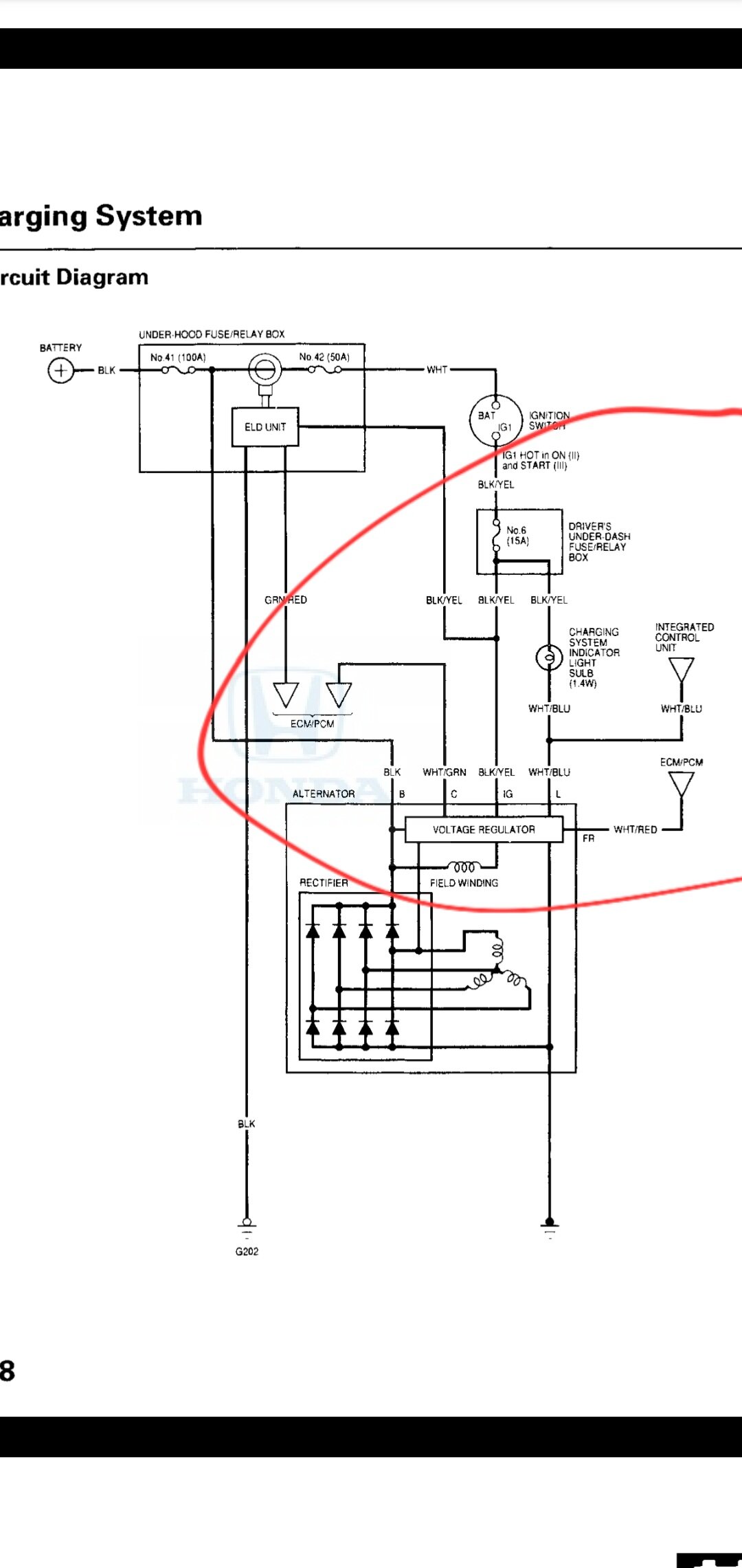

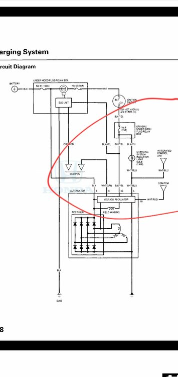

Please help identify my alternator "s" sense wire
I would like to add a diode to my s sense wire to increase my charging voltage. Can someone please help identify the wire? I think it is the white/green wire on the page of the service manual that I attached. Thanks in advance!
-Travis
What are you looking to gain by doing this? What's your current charge voltage?
This isn't so straight forward on this vehicle.  Best to contact the guys at Mechman and ask their advice.
In addition, as SD says, more voltage isn't always better.  Car batteries like 2.4V per cell at maximum.  That's 14.4V for a traditional 12V battery with 6 cells.  More voltage will shorten the life of the battery - unless we're talking deep cycle marine batteries . . .
