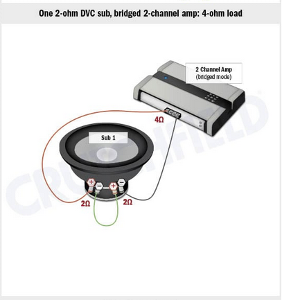

Joe X Posted November 24, 2022 Report Posted November 24, 2022 Say you have a 2 channel amp that you can bridge to a single channel and in bridged mode the amp is stable at 4 ohm. Say you have one subwoofer that is 2 ohm per coil, then you connect the coils in series so that it matches the 4 ohm output of the amp. Then you connect the sub to the amp like this: This is just an example and your sub amp may need to be connected differently, an incorrect connection may damage your sub and/or amp. Your sub should have printed how many ohms is each coil, typically for cheap subs you get 2 ohm per coil or 4 ohm per coil. Also post the model of the amp. When you connect your sub to your amp correctly you get more output and a much louder system.
