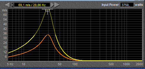

Not everyone believes in plots but the conclusion is pretty obvious:
The following is for an 8 cube net box tuned to 32Hz, orange is 100 square inches of port area, yellow is a single 8" port, power shown is per driver:
As you can see the yellow plot becomes darker at about 35 m/s meaning that port noise can occur, it's crazy out of range at tuning.

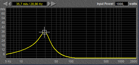

The next plot below tells you how much power you can run without issues on a single 8: port and as you can see at 1000W per driver or 2000W total is the most you can run and the 8" port will function properly.
