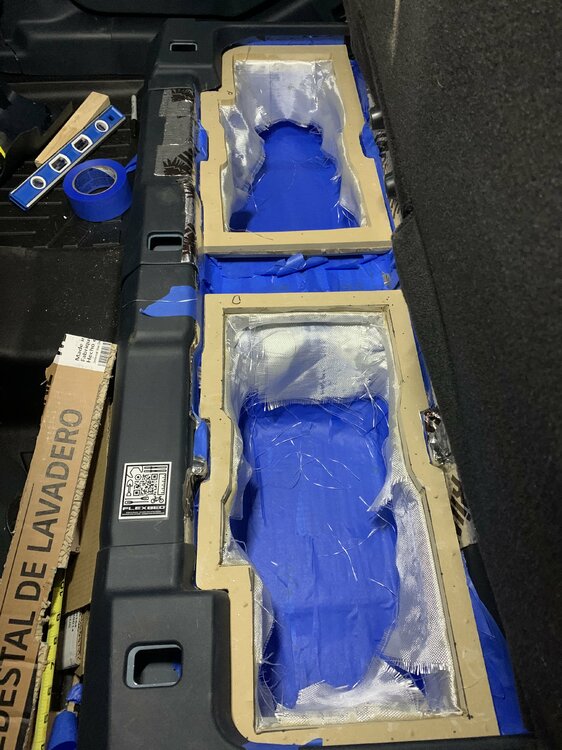

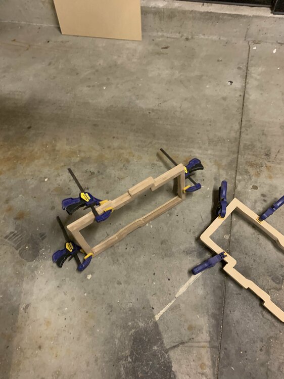

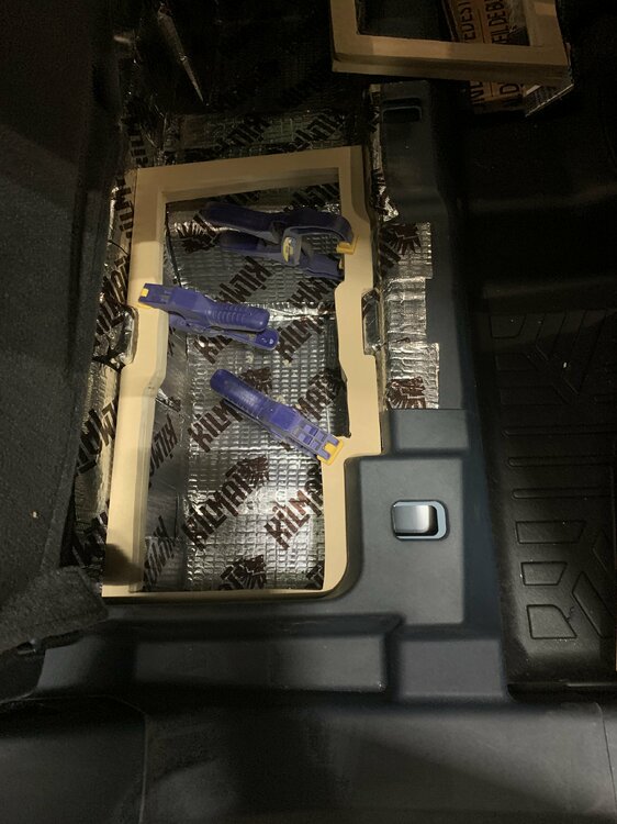

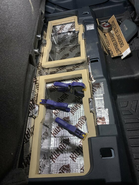

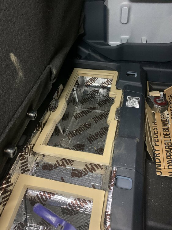

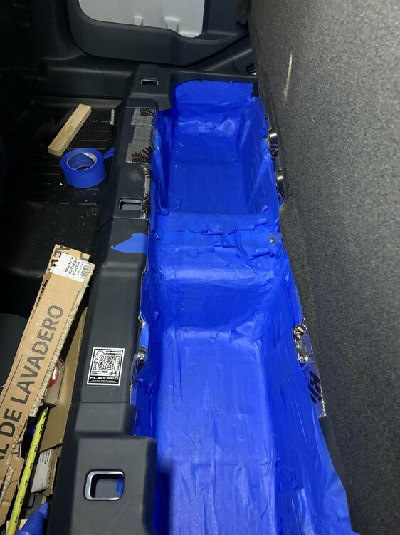

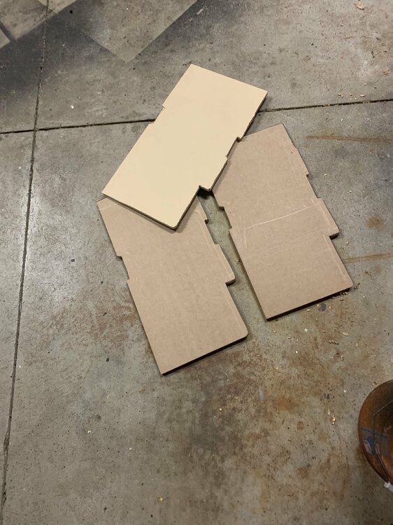

Sub stage , I know you love ported but absolutely no room here and hell no not doing 2-8’s. So box is sealed, fiberglass with SMD sunflash and that stuff is awesome resin that dries when you tell it to
Box is going under rear seat.

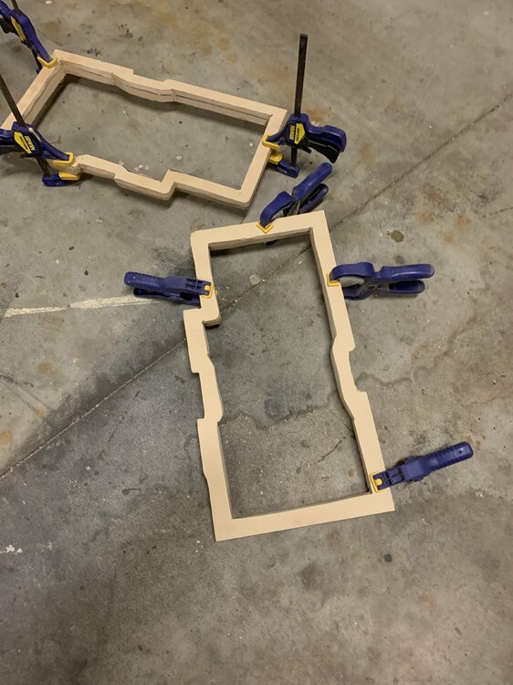

I sandwiched the mat in between the MDF so it’s all 1 piece.

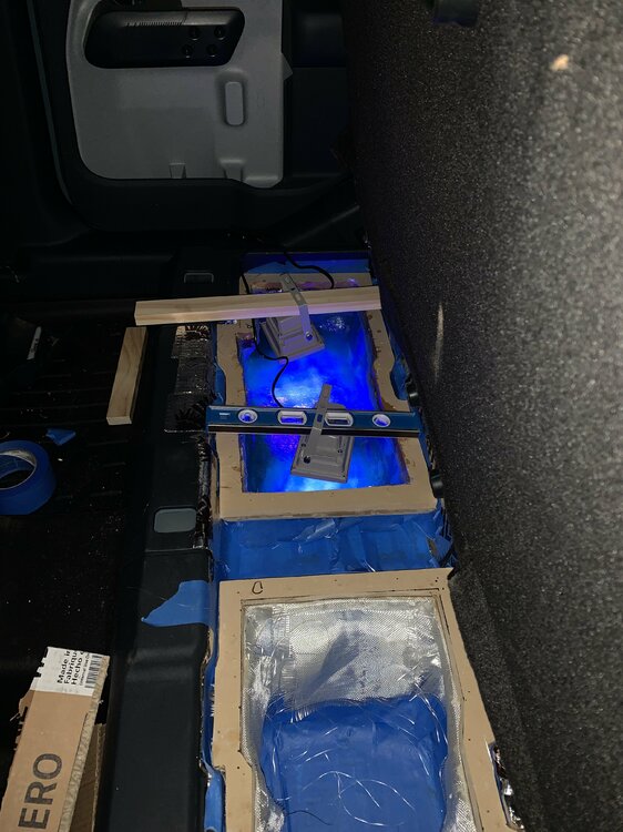

Then resin like crazy , got 5 layers and the UV lights drying everything. Used SMD Sunflash and that shit is no joke resin dries when you tell it . I used UV lights and will be making new tweeter pods for the door panels with this stuff later.

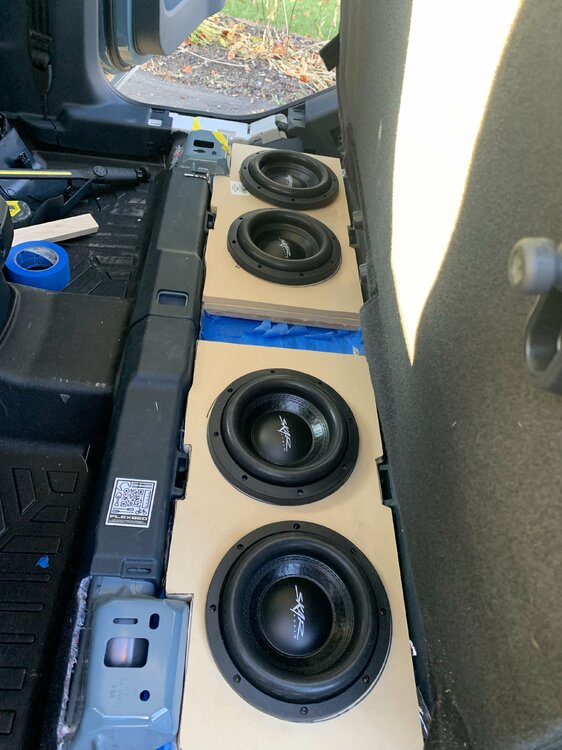

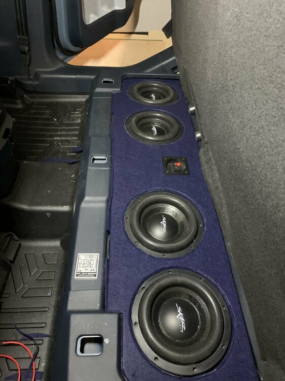

Sub's mounted and installed went with blue carpet to stick with the blue theme of the interior
Sounds good not used to 8’s but for now I’m happy, if I get bored of it I have 2 Sundown SD-3 10’s that can drop in that box. Not impressed with the Skar SKM 400.4 though. Might be putting Fosgate boosted rail 75x4 but will wait till spring it’s-10 here now.
