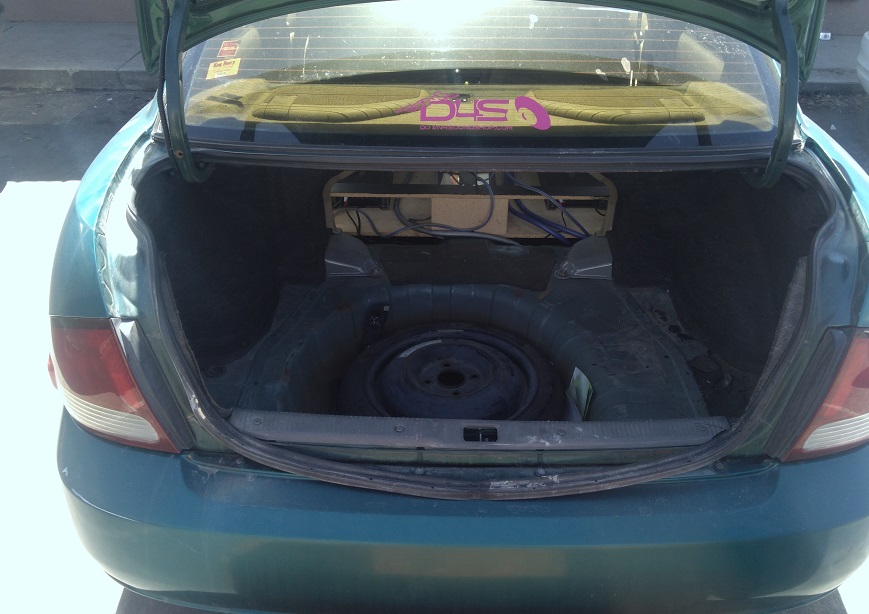

Cool build.  Just curious what are the plans for back seat area just amps or do you have other plans?
amps lithium banks and mids in highs theres a whole back section to that amp rack thats going to go with the bottom section thats im going to do a bunch of stuff with its going to cover the factory trunk to cabin opening im going to build a octagon or oval opening into it  and the mids in highs will go down the sides its hard to explain will make more sense once i get to that part and start building it , its just starting to get warm enough here now i can start doing all the sound deadner and fiberglass work , i also ordered 4x bad ass 12's that will eventually make there way into this build , i finially figured out how to get a 8.2 cf net box into the trunk of this thing

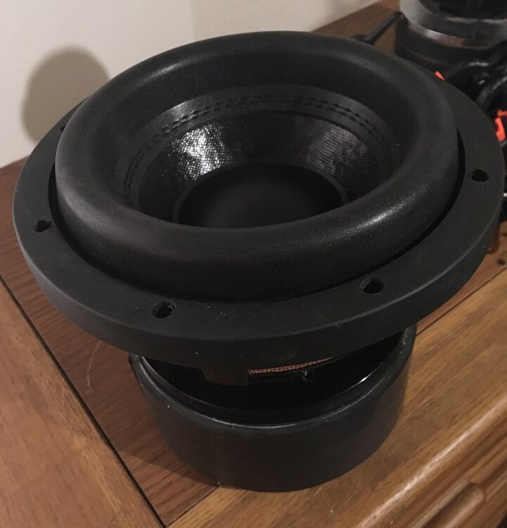

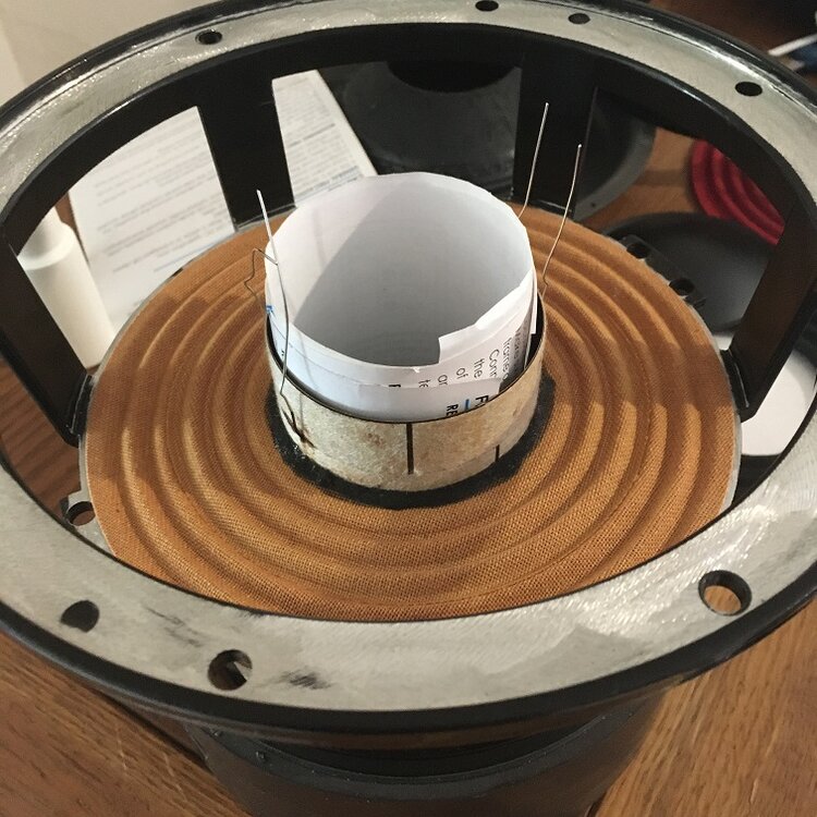

parts came for my monster 8 test build still cant decide which cone i want to use the tall roll or the mega roll cone

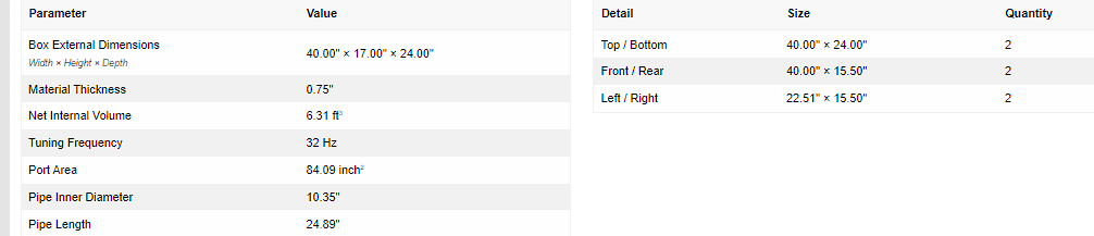

as much as i really wanted to swap to 4 12's its not possible , the box i came up with pysically fits but it has to be built in the trunk , im not going threw all that , so i ended up ordering 3 12's to go in the car and designed a 6.3net cf box that i can get in and out of the trunk of the car the only thing i may change is the port but for now i think im going to stick with the single 10 inch areo port . the 6.3 will be true even after bracing as i just calculated in extra sub displament to make up for the bracing

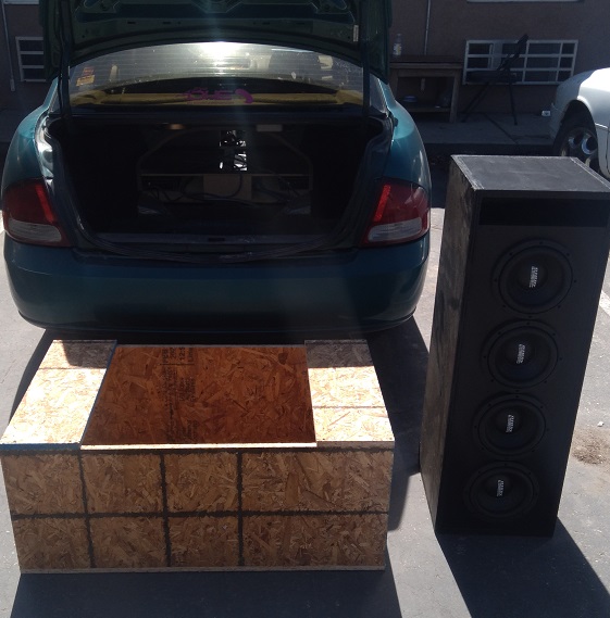

bought a hseet of osb along witht he ply to build the box , got the osb so i could mock up the box i speced to make sure it fit and didnt need to be changed without having to cut up the expensive wood first i have to slightly adjust the height and depth to be able to get the box in and out of the trunk but yup i should have those 3x 12's in the car soon
If you plan to fire the subs (or port) up that is going to turn out bad.
Also it's a great idea to build a test fit box but you do it from cardboard as if you have issues you can resize the box relatively easy and it's much lighter.
