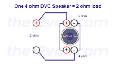

Lukis Posted March 7, 2023 Author Report Posted March 7, 2023 Maybe you have a schematic how to wire in parallel?
Joe X Posted March 7, 2023 Report Posted March 7, 2023 This is how you do it: Save as above just presented differently: Don't forget the signs, positive of coil1 to positive of coil2 to positive on the amp, same with negative as you can see in the figures.
