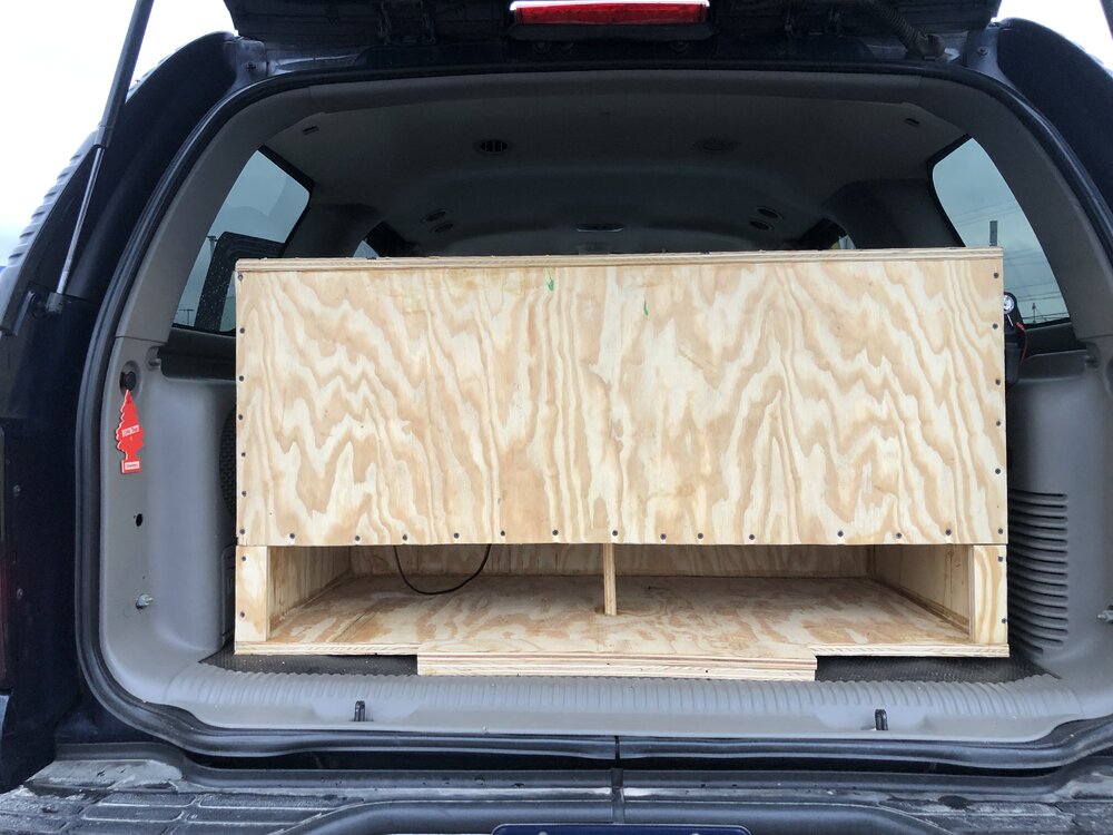

91booster Posted March 23, 2023 Report Posted March 23, 2023 Ok guys I acquired a box it measures 46 wide by 24 tall and 24 deep now here’s the kicker it has a slot port of 44.5 by 6” by 6.75 deep and also comes with a port insert that closes port down to 10 wide 6 hi 6.75 deep I just stuffed the box with 2 15” solobaric L7’s I spoke to kicker they recommend making a cover and add 4 - 6” inch round ports at 13.75 inches long each now I’m no good with this box tuning so I’m asking you guys with port should I go with and it’s for a 06 tahoe build 3000 watt amp to power then. Thanks guys for all your help and advice.
Joe X Posted March 23, 2023 Report Posted March 23, 2023 The first box is 11.6 cubes tuned to 55 Hz 267 square inches of port area (insane). The adapter tunes low but has deficient port area of 60 square inches so it is a no go. The kicker suggestion is 11.7 cubes tuned to 38Hz 113 square inches of port area. To keep things simple I would do the kicker suggestion (4 6" ports) but longer length, 16" would get you to 36Hz tuning that is more reasonable, these ports are sold in 17" length so 1 inch external 16" internal would get you to 35Hz which is pretty decent. Other modifications would be more difficult to perform. Always ask around before buying a box, that builder obviously didn't know what he was doing.
91booster Posted March 23, 2023 Author Report Posted March 23, 2023 I got the box for free thankfully and with price of wood I figured give it spin would you recommend using longer tubes or different size I have the room and I like all music the low lows and hip hop rap reggea including dancehall I have the room externally could I go longer for say a 30 hz tune or will the perform best tuned in this area thank you so much for your help this photo box without insert

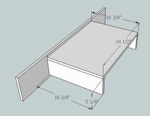

Joe X Posted March 24, 2023 Report Posted March 24, 2023 18 hours ago, 91booster said: And also where can I buy such ports can I use 6”pvc pipe pieces I guess I will recommend the following mod being the simplest solution I could come up, also the cheapest, is as long as it can be and will tune you like 32.5Hz: NOTE: It is meant to be permanent fix, if suitable after testing it should be glued and screwed. NOTE: the brace and the board above should be removed.
