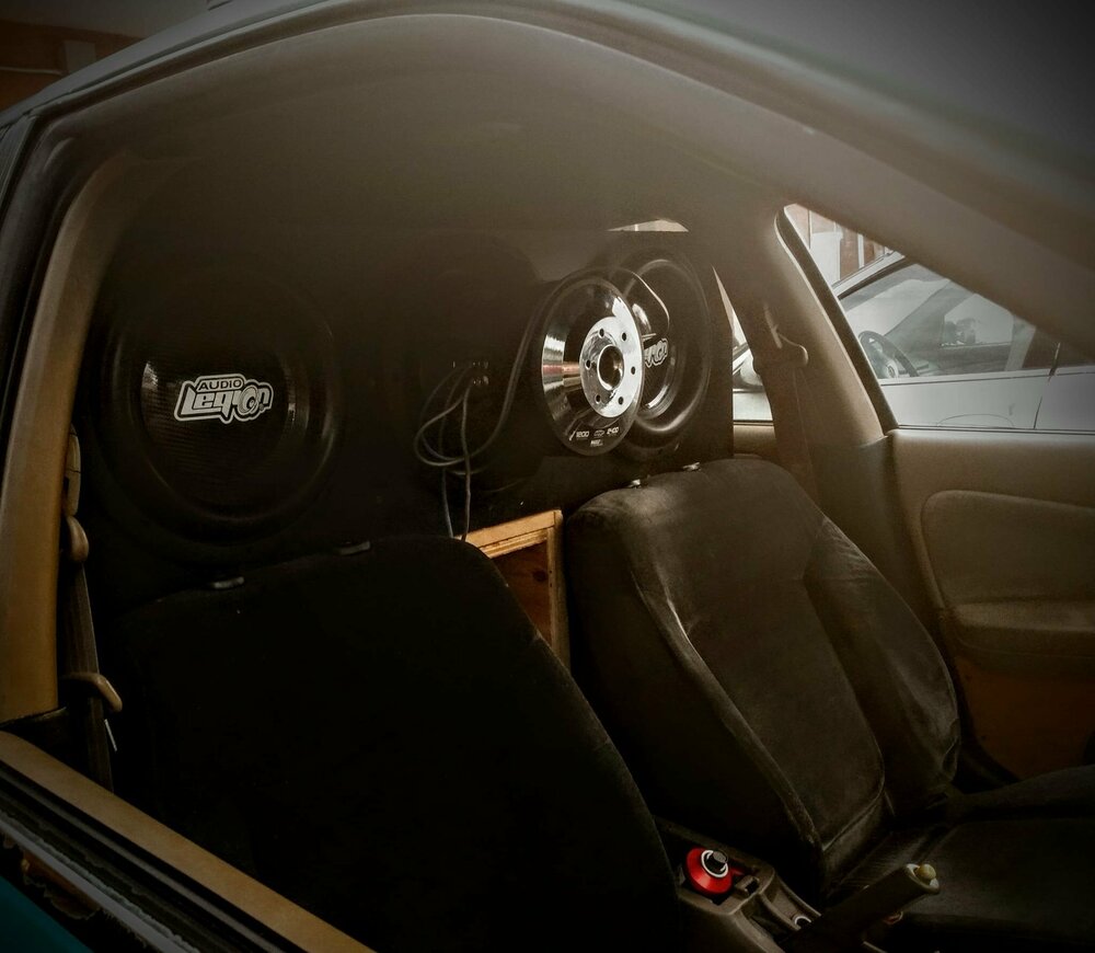

mel80 Posted September 4, 2023 Author Report Posted September 4, 2023 got all the bracing in and done and reinstaleld the front baffle its now permantly attached and sealed , while i was at it i decided to invert the top center sub just for looks , not sure if im going to leave it inverted hence why i just pulled the speaker wire out of the port to hook it up for now . the motor is dangerously close to drivers and passenger heads , im a lil owrried somone might smack there head on it in an accident or say in an panic/emergency braking situation so not sure if im going to leave it inverted, ill do some testing with it this way in 2 days when the glue and edhesives i used are fully cured

mel80 Posted September 18, 2023 Author Report Posted September 18, 2023 1st and second in classes after i broke the wall was doing some demos in the 20-30hz range before i made my runs and blew the bottom seam on the back wall , sheared the pocket screws glue and brace right in half its all dbl walled too so now i gota figur eout how to repair it
killerc998 Posted September 19, 2023 Report Posted September 19, 2023 Might be time to use some metal along brackets along the long sides along with 90s to add more surface area to glue to.
mel80 Posted September 20, 2023 Author Report Posted September 20, 2023 On 9/19/2023 at 6:32 AM, killerc998 said: Might be time to use some metal along brackets along the long sides along with 90s to add more surface area to glue to. my thought/plan atm is to cut some 2x4's to glue and screw in there , the rear wall is on a 13* angle so im thinking about rippipng some 2x4's on that 13* angle and glueing/screwing them to the floor and the back wall , and i can go 2 layers high which should be plenty.
