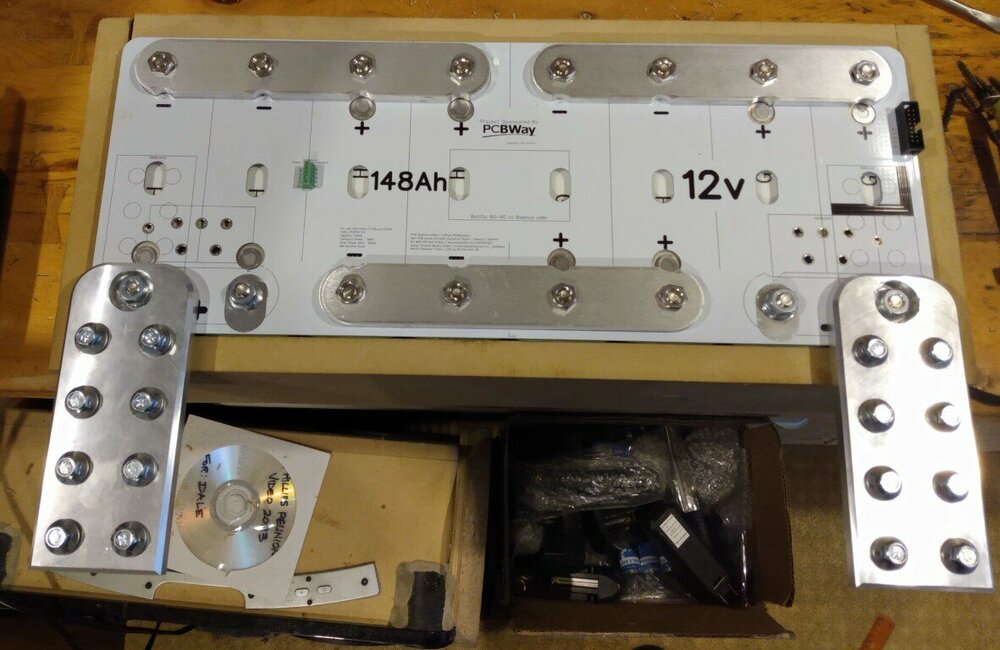

jmanjr82 Posted October 30, 2023 Report Posted October 30, 2023 Let us know how you like those cells from Jehu?!
mel80 Posted October 31, 2023 Author Report Posted October 31, 2023 11 hours ago, jmanjr82 said: Let us know how you like those cells from Jehu?! will do should be putting it to the test this comming saturday going to a comp down in nevada

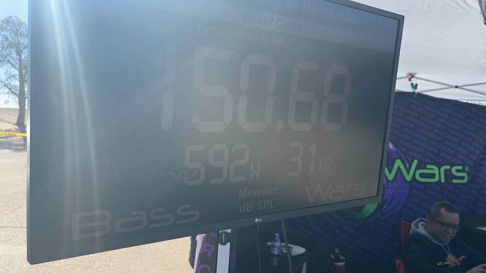

mel80 Posted November 5, 2023 Author Report Posted November 5, 2023 bank worked great only ever saw voltage drop by 1-2 tenths from charging voltage as my alt heats up it drops voltage so when cold it was charging at 14.4 and i saw 14.2/3v when its hot i see 13.8 for charging voltage and only dropped to 13.6 at the lowest
jmanjr82 Posted November 21, 2023 Report Posted November 21, 2023 Sick dude. Is that with 1 or 2 of the 148ah lev60 banks?
mel80 Posted November 23, 2023 Author Report Posted November 23, 2023 that is with single 148ah bank im going to step it up to 3 banks here soon as im switching form the five recoil 1200.1 amps to five slapz audio shock 5ks
mel80 Posted December 12, 2023 Author Report Posted December 12, 2023 big update today i went up to jones subwoofer solutions today to do some testing and learned alot first up we did some testintg to see impedance at various frequencys starting at 50 hz imp is 1.6 ohms @ 40 hz were at 2.8 ohms and at 30-20 hz were holding on at anywere from 4.0-4.4 ohms so we put this think on a meter as well 20 hz burp netted me a 150 on the glass @ 372w per sub 30 hz burp netted me a 153 on the glass at about 450w per sub some changes ill be making im currently running 113 sqinch of port at 28hz tuning im going to redo the port to around 175sq inch with the low tuning #2 need more power and alot of it recoil amps are comming out and at first im going to wire all 5 subs series parrel for an .8 ohm load on a single md12000.1 half ohm model , at some point this season im going to add a second matching md12k and wire 5 coils per amp at .4 ohm #3 need to finish sealing the wall , but along with this i am doing a wood roof as ive already separated the roof skin from all the supprt braces , while im at it im going to do a wood floor as well with theese changes ill be looking to be a solid competitor in monster and cyclone/typhone classes On 11/21/2023 at 10:34 AM, jmanjr82 said: Sick dude. Is that with 1 or 2 of the 148ah lev60 banks?

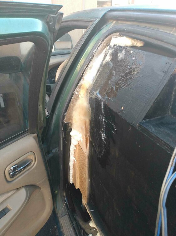

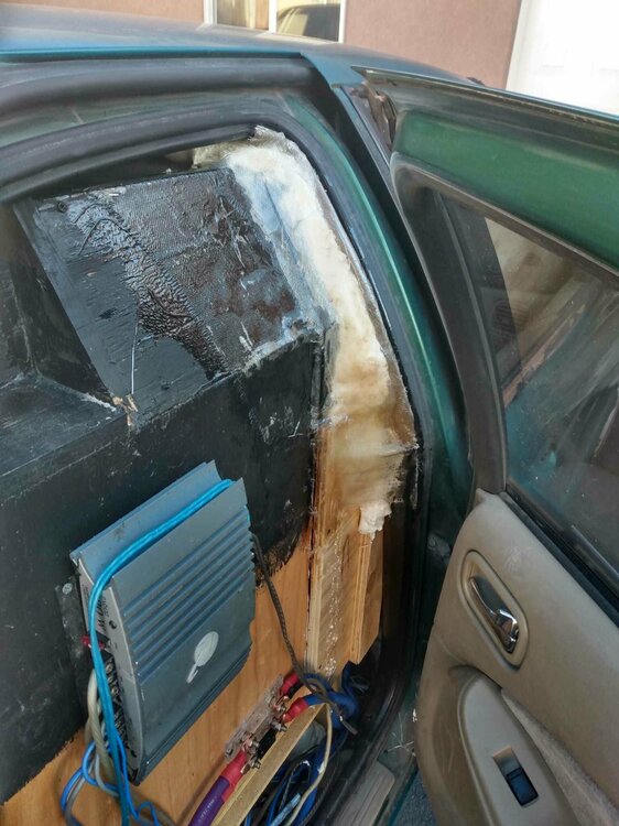

mel80 Posted January 30, 2024 Author Report Posted January 30, 2024 started to seal the wall off today so much work to do
