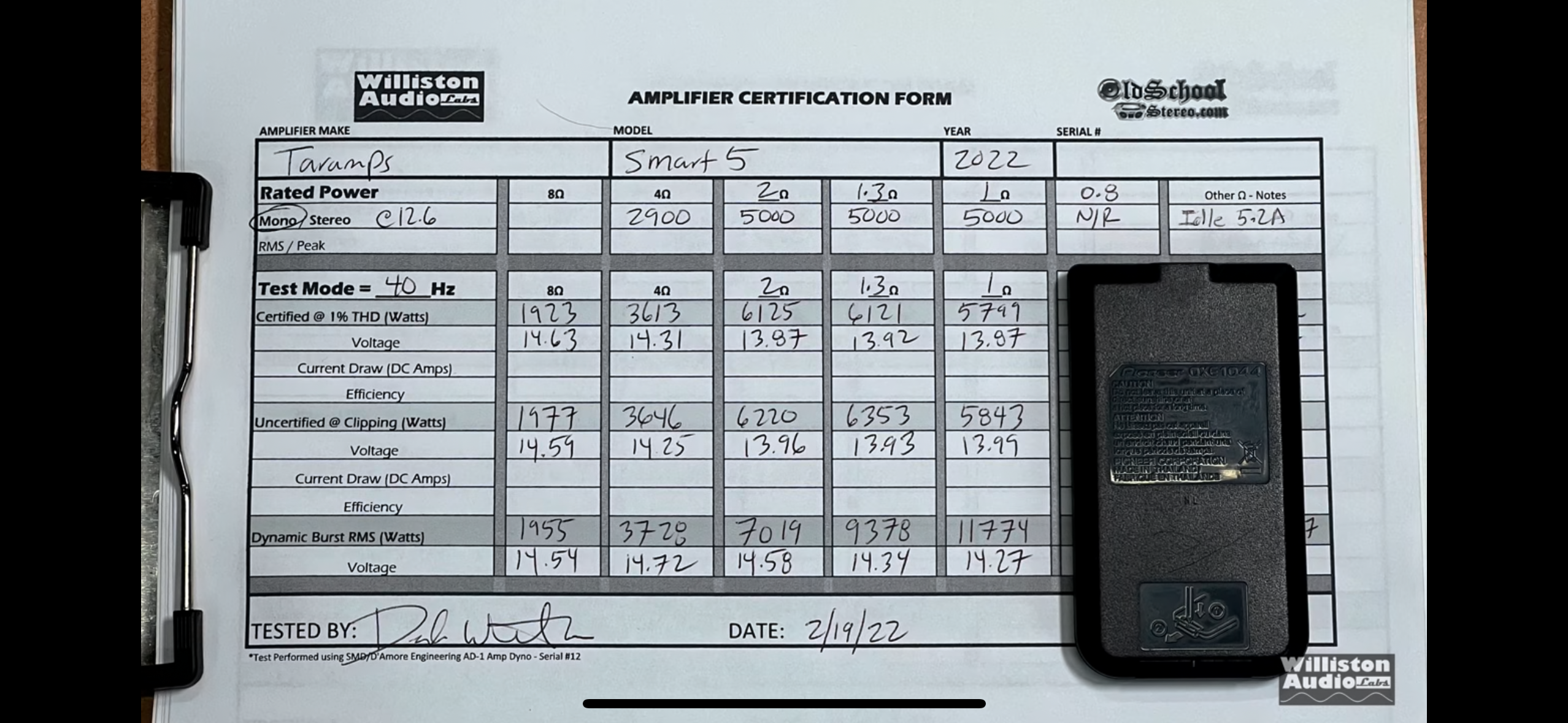

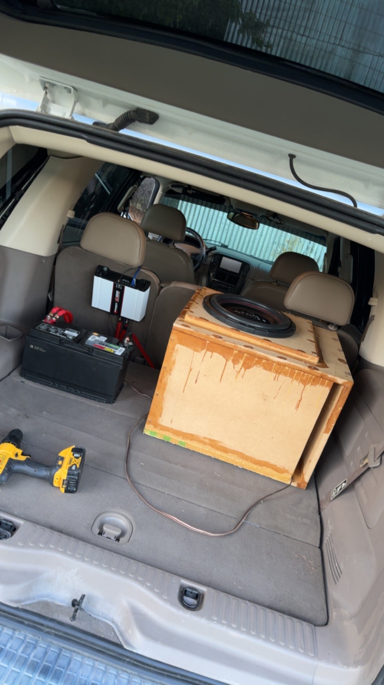

DISCLAIMER: setup is NOT pretty, I’m in the works of trial and error, as well as getting my system where I want it so it’s a lot easier to take stuff out. But, here are some vids/pics of what I’m running as of now if anyone was curious as well as the WAL dyno sheet for the amp I’m looking into.
Well, I don't think that that amp is going to pull anywhere close to 550 amps. But if that's your thinking then yeah you need the proper fusing you don't split the fuse in half or anything. You use the appropriate fuse for the wire size and if you add another wire which is the same size, you need the same size fuse. If you are going to exceed the rating of the wire then you need a thicker wire. You say that you are going to add a second battery in the rear and you want to want to wire to that.

I run a 1600 watt monoblock and I run a door speaker amp which is about 400 watts RMS the main fuse that I use is 150 amps then I have a distribution block which is fused in the rear which has a couple smaller fuses. I don't seem to have any problems sure  I could put a 250 amp or 300 amp fuse coming from the front of the vehicle but that's unnecessary I do not pull anywhere near that power.  I don't think you're pulling more than 300 amps with that setup.  The sub amp probably pulling 250.  door speaker amp probably pulling 50 at most

Your enclosure is completely and totally misdesigned and misplaced and likely the reason your system is not performing as it should.
The best way to get loud is through cone area NOT power, Get 2 15" subs in a correctly designed enclosure instead of 12s and you will see much higher output even if no extra power is added, "Cone area is King" that is no joke.
Also the quality of the subs is extremely important, use subs with strong motors, higher Xmax, higher BL not some weak mini motor subs.
The amplifier and electrical including wiring are chosen AFTER the subs are chosen not before,
The largest amplifier you will need doesn't need to be more than twice the RMS power of your subs, more than that is just wasting money.
