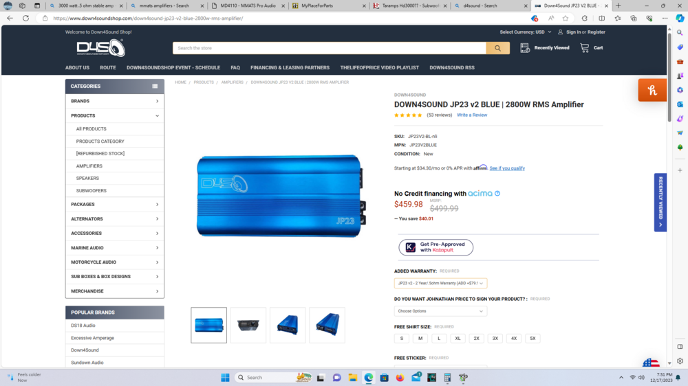

Down4Sound JP23 V2 BLUE - 2800W RMS Amplifier - Down4Sound Shop
first check box is 2 year .5 ohm warranty for $79.99

the md8k DID NOT blow, the 3 15s literally knocked the filter caps off the board! next to no hot glue reinforcing the components so vibration took it out. was less than a month before warranty was up and they drug thier feet about getting back to me so warranty never happened. any shop that would fix it was 3+ months out so chucked it into the garbage. the rp4500 that replaced ( @ .66) it ran for over a year and sold and still going on .5 ohm today. All my buddies get my hand me downs when i upgrade or change my mind. i got the d1 bc the jp23v1.5 was happy at .5 ohm. dont wanna give up more room than a single 12 in my pickup any more. figured if the v1.5 could take .5 ohm for almost a year than the newer v2 ( with a .5 ohm warranty) would be fine and net me another 500+ watts. any person would assume that im sure, i cant be a total dumbass, ill just attribute it to my garbage ass luck.Screenshot(7).thumb.png.6a832ea2de8c4137aaf9eb5d51c2a507.png
