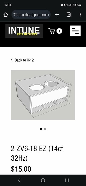

Also, I have been looking at a box design by intune designs, anyone ever used it or seen the design they have? Thanks guys. I added a photo of the design im looking at.
Cut port area when you are looking for plain SPL does not sound right, do software modeling on the power you intend to run maximizing volume and port area as possible within the space you have to work with and very important keeping proper port clearance, single box not dual boxes, the type of box you show is right for SUVs. Just bear in mind that plain SPL boxes don't sound that nice, if you want to to sound nice, you can't go far above sundown specs.

Ok just make sure that with the external dimensions of that box you still have 5 inches of clearance to the rear gate in your SUV so that the port operates properly.
Would it be a bad idea to do the subs up, port up? Or is it better firing to the rear in this case?

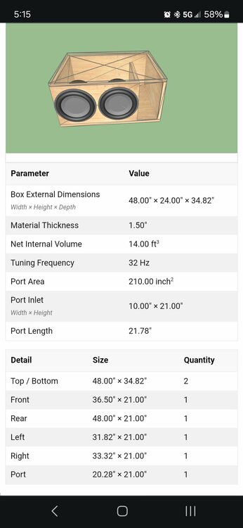

Also,  I've been fooling around with sub box pro, and I came up with this box design. Except the subs would be up top firing towards the roof, and they would be mounted diagonally. See what you think. I just put the subs in the calculation so it would counter in the space they will take up. And this program doesnt give the option to mount the subs up or change the location of the port. Also, id be doing triple or 4 baffles.
In my opinion the first design is far better as it doesn't have potential loading issues and also with the second design you need 10" of port clearance instead of 5" like with the first design.
