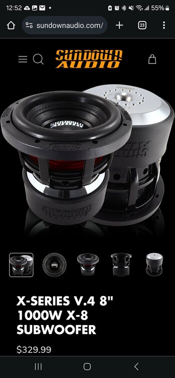

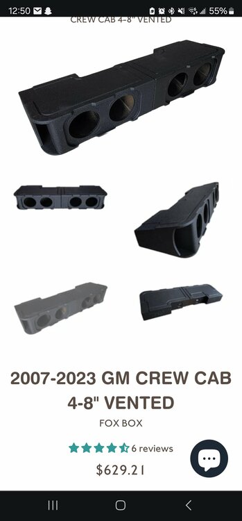

I wantwd to keep the amp and get this 4x8" sub enclosure for under my seat and throw 4x1000 watt rms 8" sundowns in there.
Im pretty sure the fox boxes are 5/8" mdf. I dont see any interal bracing. I suppose i could throw a couple in there maybe by screwing them in and then just using some liner to touch up the screw holes?

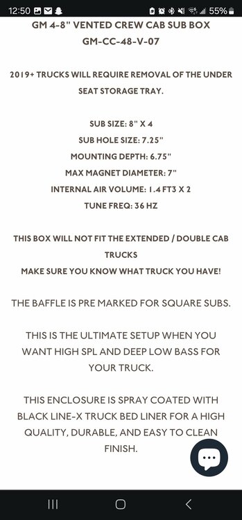

That box is designed for SA-8s as a result the X subs are going to find themselves in a too small box with low port area and tuned too high, surely above the 36Hz specified as driver displacement for X subs is larger, maybe it will get to 38Hz or more and could experience some port noise.
Used to a large box tuned very low you will definitely notice a loss in bottom octave bass.
Regarding to your question, you can always strengthen the box but if it is made of cheap thin 5/8" wood then it is not impossible.
Lastly the pre cut sub holes cannot fit X subs, you will have to work on the holes.
Overall that box seem expensive and not adequate for the subs. I would lift up the seats and do a proper custom enclosure for those subs and even then you probably have better bottom octave bass right now than you will ever get with some 8s.
