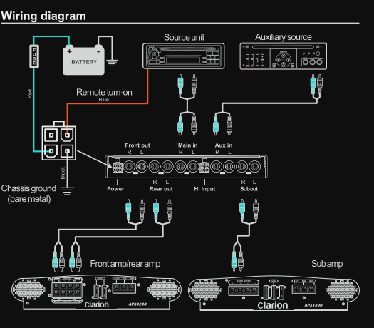

If you want 4 channels fo speakers you ca go 3 ways:
1) use splitters as mentioned above if you don't need FADER.
2) install a cheap LOC in the speaker outputs of the head unit and use that as outputs for 2 channels and use the head unit RCA for the other 2.
3) Get a signal processor like the old clarion EQ7 it goes by many names like this:
https://www.skaraudio.com/products/ska7eq-7-band-half-din-car-audio-pre-amp-graphic-equalizer
You get from it all your outputs for sub and 4 speakers plus AUX for a bluetooth receiver or whatever other player.
It was made by the millions and I am sure it can be had used for cheap like $20-30.
See what I mean:
I might go that route or like you said I could just get a newer Sony for like 70-80 bucks and it will do everything I needed to do but it will still not have the preouts and we'll have limited preouts Yeah a guy did tell me I could pick up a DSP and it would handle everything
A higher end head unit will have 3 sets of RCAs but that would be a different game, you are looking to a $100+ unit, new at least, DSP that let you change settings while driving would be also pretty expensive.
