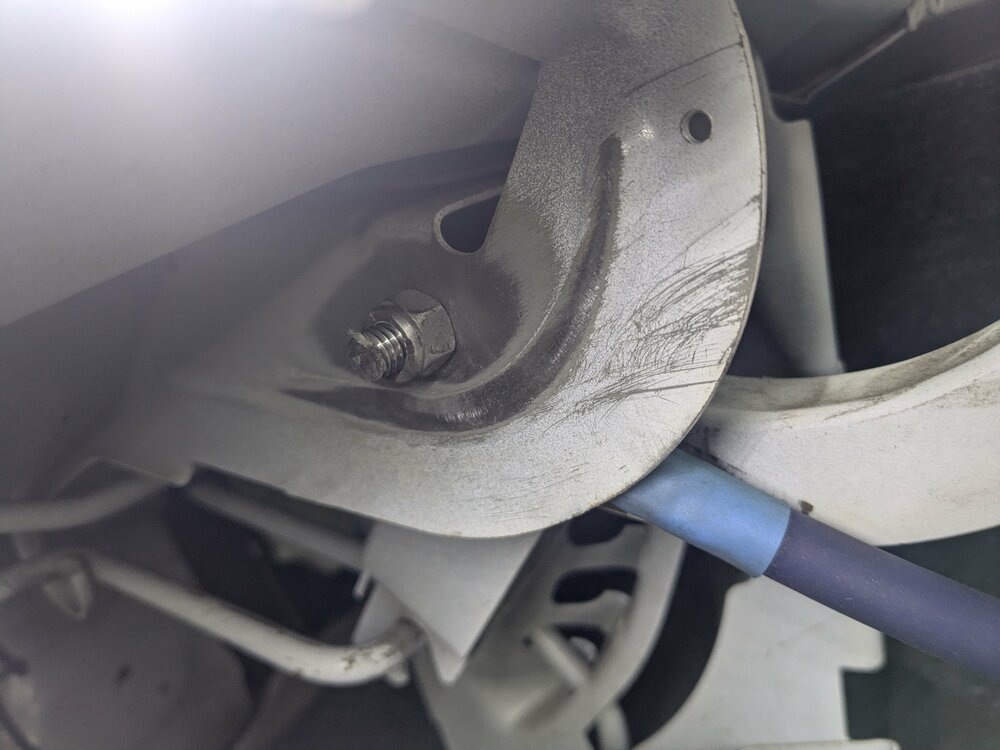

jgi420 Posted February 24, 2025 Report Posted February 24, 2025 So I've had a new system for about a year. I have skar evl12s two of them and I have the rp2000d amp I also have a small door speaker amp. I noticed at night when I'm driving around In the bass hits my headlights dim. Now I know the maximum level of playing volume is different for different head units different people ect. My head unit seems to like to play clean around 21 to 24 volume. It was like this on the last two amps. The skar doesn't have a clip light Like the nvx amps do. I have the gain on the amp set at about 3/4 of the way up. Now a few of you might have seen me post in here and might remember What? I had going for a system and specs but some probably do not so I can briefly go over my setup. One of the first things I did even when I had a stock alternator was the big three I ever since upgraded and did the big four and now I have an aftermarket alternator. I have a 250 amp js unit I've got one of the grounds on the alternator ect. The main power wire going to the battery has a 150 amp fuse It never blows. I got a distribution block in the rear which is fused and that never blows either. I have a piece of 4 gauge ofc silver tinned Going to The monoblock subwoofer amp. I have recently replaced my battery because my original battery was 5 years old and failed. So around 2 months ago I picked up an EverStart Max Which is 800 cranking amps nothing super fancy but it starts the car. So basically my main concern is that I might not be receiving full power from the amp or that the sound quality might not be as good. Seems like with the Alpine head unit I have I turn the volume up to 18 or 19 and with certain songs and music, the headlights start dimming when the bass hits. Now I have general knowledge about electricity but I'm no electrician. I've had a few systems hadn't dealt with dimming too much. I have a Grand Marquis Now I do realize that some of these cars have a lot of electronics and if you have a lot of things running You could be taxing your electrical system. I don't always crank my heat and I don't always crank my air conditioning when it's hot out yet I still get the dim. I thought about maybe turning off daytime running lights so my headlights wouldn't stay on during the day when I didn't need them and maybe that would help. My vehicle draw less but I haven't messed with that. The only thing that I can think of is maybe the position of my subwoofer amp ground Is not in a good location or running my heat When it is cold out or using the AC when it is warm out cranking everything maybe the alternator can barely keep up. I have always been told that a vehicle is never going to use its full amount of alternator power all the time. The only way I could see my alternator being fully taxed is if the car is trying to draw 100 amps itself without the stereo running and then when you turn on the stereo that is requiring around 140 amps. Then maybe I would be close to exceeding my alternators output but I'm just not seeing anything that's adding up. I was considering grounding my amplifier to the frame which would mean I would have to drill a hole in my trunk somewhere and try to get my ground wire to reach to the frame. Then I would have to clean the area on the frame to get a good connection. But I was also thinking that you now have 4 ft of ground wire instead of two which would cause more resistance. I would also need a new piece of wire that is longer. I will post a picture of the ground wire and the way it's set up now as you can see, it's located right next to the passenger side trunk arm

jgi420 Posted March 4, 2025 Author Report Posted March 4, 2025 Well I guess that's pretty much probably what I've got going on. Just you know what a lot of people have said when you start running a lot of power your headlights will dim. Especially if they're old halogen bulbs like a few people said here. You know the only thing you can do is put in LEDs. And yeah I agree with the last poster. I'm probably I am probably not drawing that much. I don't know why though. When you watch some of these amp Dino videos they show RMS powers and on some of them it looks like they're pulling upwards of 200 to 240 amps Like on one video that I watched of the skar audio amp I saw where they showed an RMS burst at one home and it was pulling 240 amps. I don't seem to be drawing that much power. So from what's being implied here I should expect headlight dimming . So far the only thing I did was turn down the gain level on the amp a little bit and now my headlights don't dim that much. I also tried to run the ground to the frame like someone suggested that I talked to and when I did that I had worse of a connection. I had resistance and I couldn't get the subs to play any music. So I put the ground wire back where it was by the trunk. And yes, when I checked the power going to the alternator before everything looks solid. It was almost no resistance and almost no voltage drop. So I guess for now I'll just leave everything alone
jgi420 Posted March 4, 2025 Author Report Posted March 4, 2025 On 2/24/2025 at 5:21 PM, Joe X said: You need a HO alternator and a deep cycle battery to run a 2K amp, big 3 and proper wiring to the trunk are also necessary. Otherwise you are going to keep blowing batteries and at some point the stock alternator will blow as well. One trick to reduce current draw is using the amp subsonic filter setting it to 30Hz, this does not fix the issue, just lessen the side effects. Yeah I got a big ass OFC 1/0g power wire going to the back to a distribution block and then I got a 4 gauge ofc piece of silver tinned going to the amp from the distribution block. And the alternator is either 240 or 2 50 amp from JS alternators. It's an aftermarket So I've already got an updated alternator. It's not stock. I haven't had stock in about 3 years and I just replaced The main starting battery 3 months ago I went from a Napa legend to an EverStart Max.
