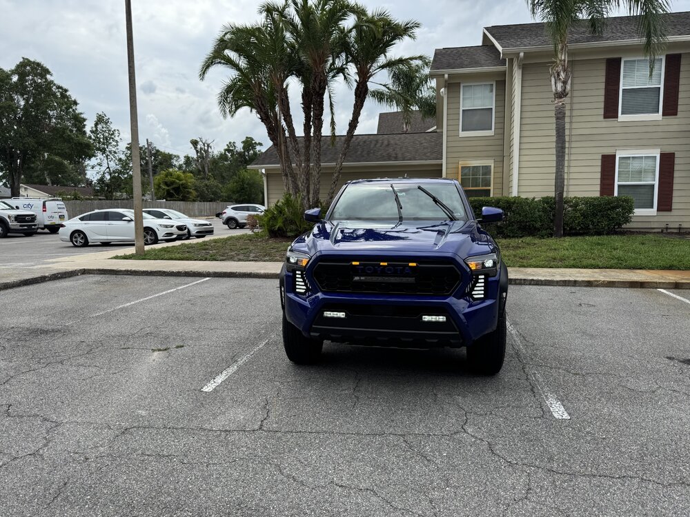

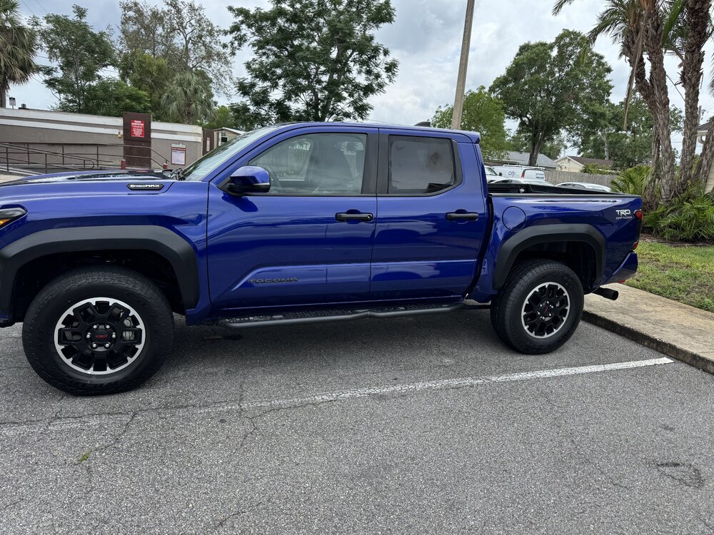

Hello I have a 2024 Toyota Tacoma trd or with iforce max hybrid engine. Is there a possibility of adding an alternator to my engine. The jbl sound is lacking. Want to eventually do major upgrades .anyone up for the challenge. I have ideas for truck in head just need help getting it to the physical thanks
