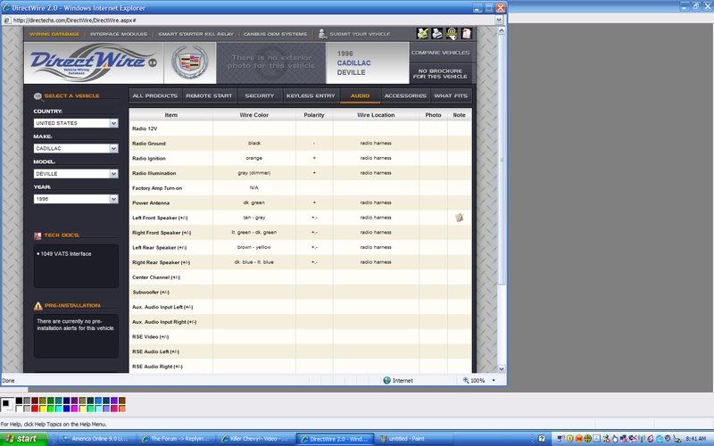

directechs you need an account....so i took the liberty to pull up your info and post it up
NoFearX18 said:
trainman0978 said:
Left front (+/-) Tan/Gray
Right Front (+/-) Light Green/Dark Green
Left Rear (+/-) Brown/Yellow
Right Rear (+/-) Dark Blue/ Light Blue
(incase you cant read it)
