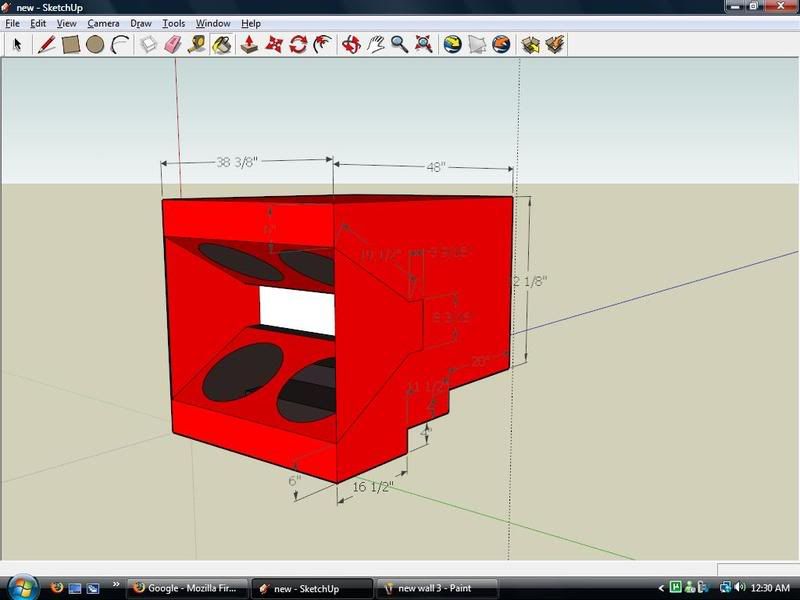

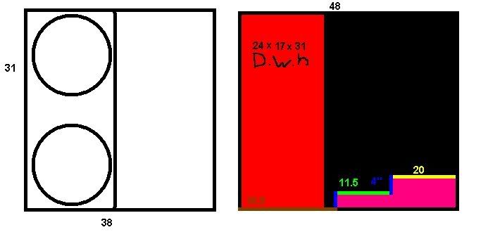

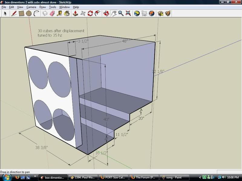

i currently have a wall with 2 15" atomic apxx's in it and I'm looking to upgrade to 4 15 apxxs my current wall looks like this
and the measurements are here the walls around 30 cubes and its tuned to 33hz at the moment

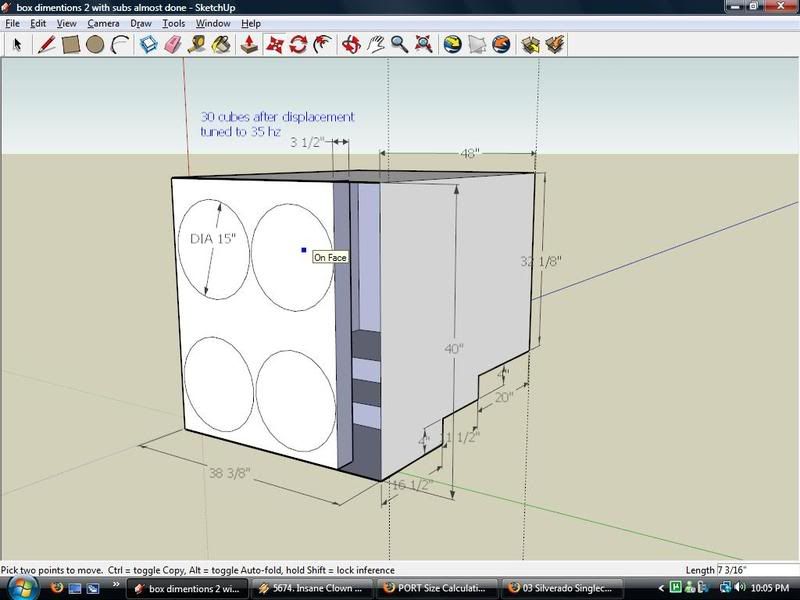

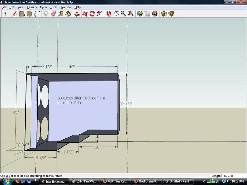

I'm looking to do the wall like this and was wondering if someone could do a sketchup version for me if anyone has any suggestions or anything all help and comments are welcome

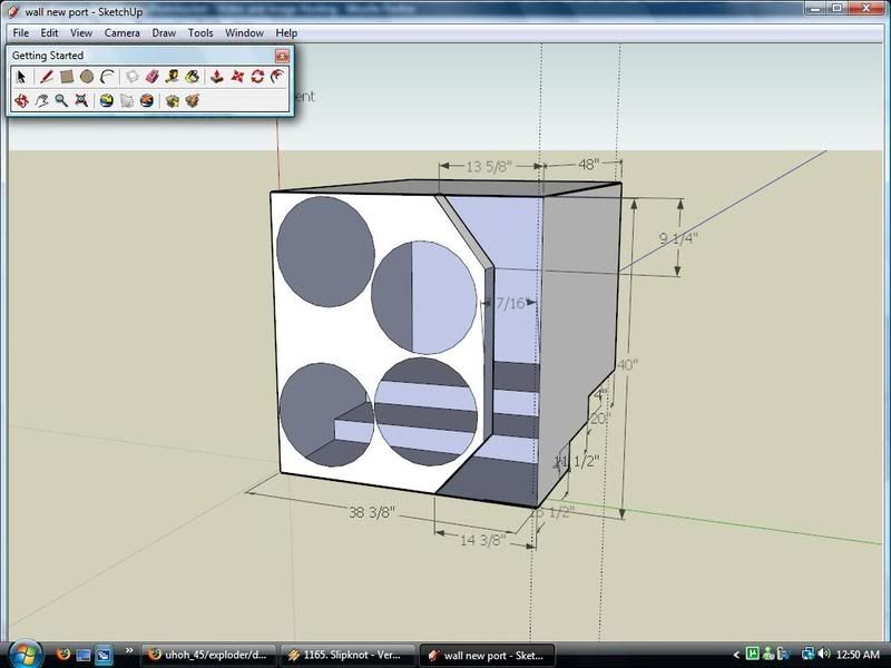

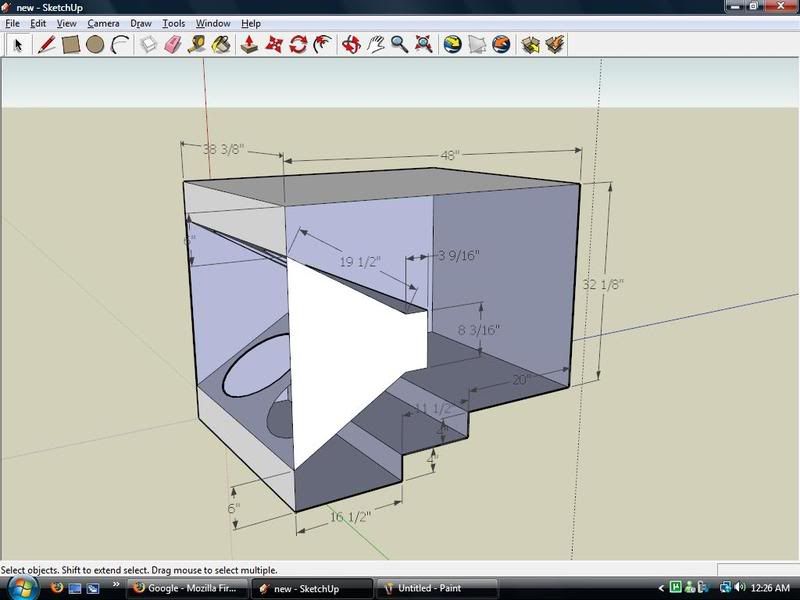

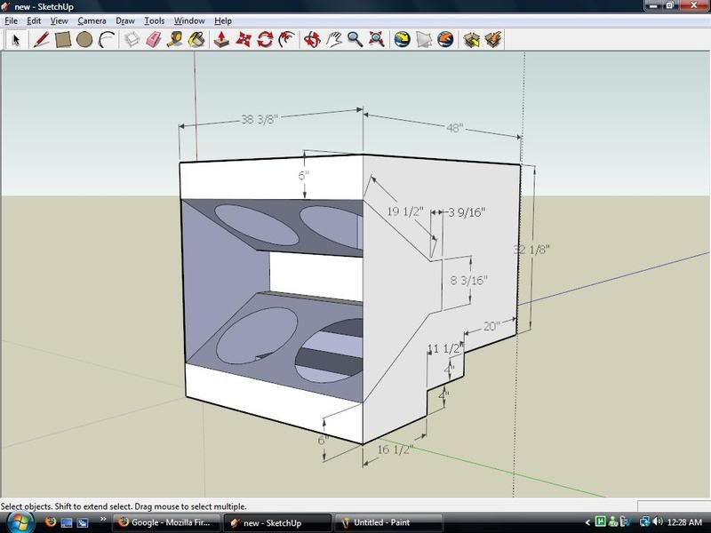

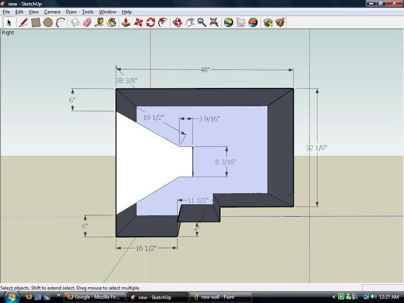

this is what i came up with only problem i see is i donno if there is enough port area

No stress on the ports mate.
You can always stagger the subwoofers for more port area and it also helps out numbers, and if that ain't enough you can do it like the design on the right.

yeah i thought of that too but this is all i could get
im also lookin into a clamshell

I've always been a fan of the humble clamshell :)
But you can stagger/tesselate those four 15s into a flat wall more than you have.

Don't have steps in the box. You'll load the cones wierdly and either get cone rocking (shags the coils when they smash into the sides of the gap) or you'll blow the cones out. You'll also get funky impedance rise on those subs. Make the bottom of the box a ramp.
