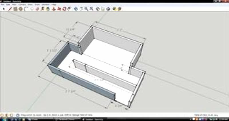

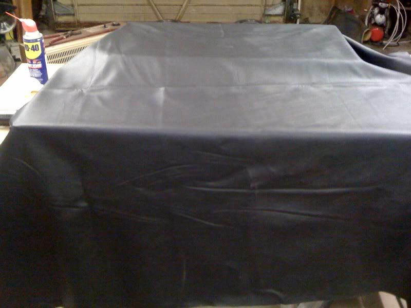

frozenevolution Posted October 10, 2009 Report Posted October 10, 2009 Hey all, thanks for the replies about my stealth . As you can see the box design changed from the original one due to the wiper motor coming too low and hitting it. Decided to take the subs out today and leather the box. P.S. Sorry about all the crappy photos - they were taken from a phone. I've got this whole build on a camera, I'll upload a lot more photos tomorrow afternoon. Design of box: Starting to bondo the drop for a "smooth" transition & port sprayed black Just draped the leather over it to give a preview, finishing it tomorrow

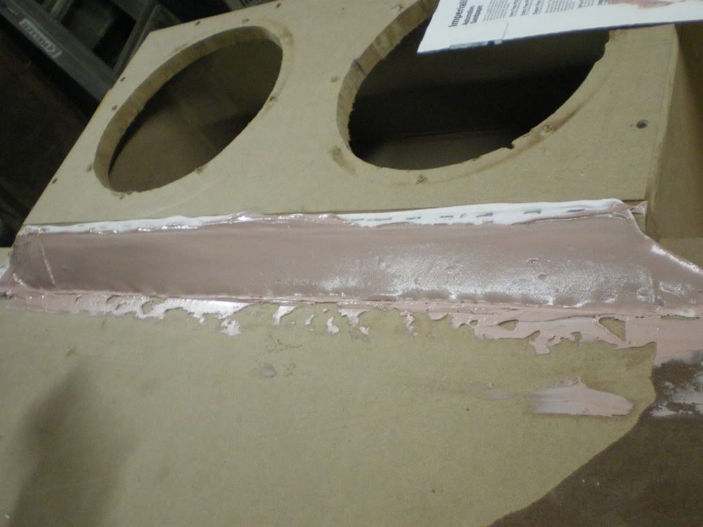

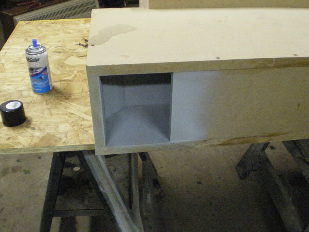

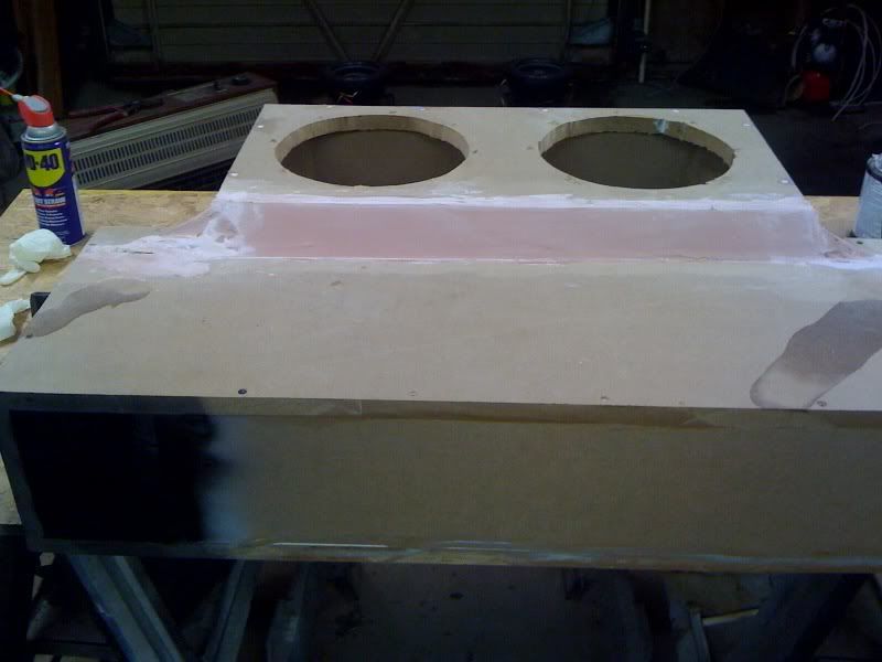

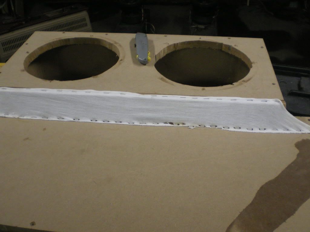

frozenevolution Posted October 10, 2009 Report Posted October 10, 2009 Finishing the box today. Better pic's of last night: Primed the port Part of a t-shirt First coat of bondo Smoother coat of it And finally the black port, used some paint from my old 89 trans am
lanman31337 Posted October 10, 2009 Report Posted October 10, 2009 The bondo is going to crack in no time flat. Use a fiberglass resin. 2 - Audiopipe AP30001Ds 1 - Lanzar Opti Scion 600.4 4 - Lanzar Optidrive 1232D's 1 - Lanzar Opti 5.1 1 - Lanzar Opti 6.1 1 - Lanzar Opti 6C midbass 1 - Alphasonic PCT6551 1 - Lanzar VX830 1 - JBL 22 band EQ 1 - Lanzar SDBT75NU 1 - AudioControl Epic160
