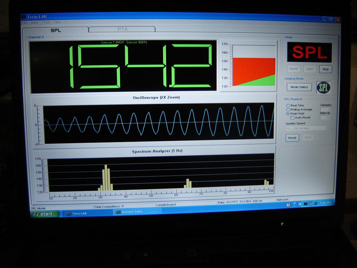

So I got a new score today. Did a full charge and a little testing. This score was on the dash with driver door open. (Bass boxing peak hZ test).
My results for peaks are as follows:
Volume 50 - 0dB tone
136.4 @ 32hZ sealed
138.5 @ 36hZ driver door open
132.5 @ 51hZ both doors open
So I decided to just see what the max score would be for door open and I tested 30, 32, and 34. Somehow, the louder volume changed the peak of driver door open back to 32hZ (?)
Since I don't have access to Photobucket at work, the picture is attached.
Here's the photo from my computer.
