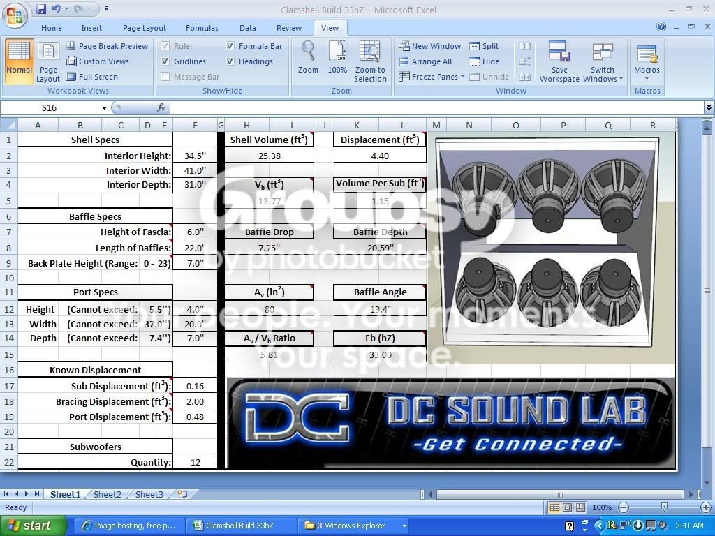

Neo_frog Posted April 9, 2010 Author Report Posted April 9, 2010 I guess you can consider this next one a teaser pic... I wrote myself a nifty little Excel sheet to do automatic calculations for a ported clamshell.. This thing saved me tons of time. I even added comments on each box and added conditional formatting to show anything that goes out of range while making adjustments. If anybody would like to see a copy of it to mess with, let me know. It only accounts for a single stage baffle. Credit to uhoh_45 for the picture and Rusty for the DC banner. Need an install? Hit me up.[email protected]Got car audio questions? Check here first!Everything you need to know. =]http://www.stevemeadedesigns.com/board/topic/83029-everything-you-need-to-know/
uhoh_45 Posted April 9, 2010 Report Posted April 9, 2010 shit i seen that picture and thought it looked familiar great job on the excel this should be your loudest setup R.I.P! (Nov-29-2009) 92 explorer - 4 Atomic Apxx 15s duel .7s - 4rth order bandpass wall -4 powerbass XA-3000D's - 16 8volt batts wired to 16 volts - (9+/9-) runs 0gauge - 152.3 Db @ 29hz BUILD LOG current build 97 chevy lumina4 - 1 Atomic Apx 18 - 6 cube slot port trunk sealed off - 1 powerbass XA-3000D - 2 optima G31s in spare tire18 1 run 1/0 lumina build log
