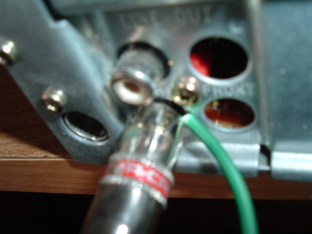

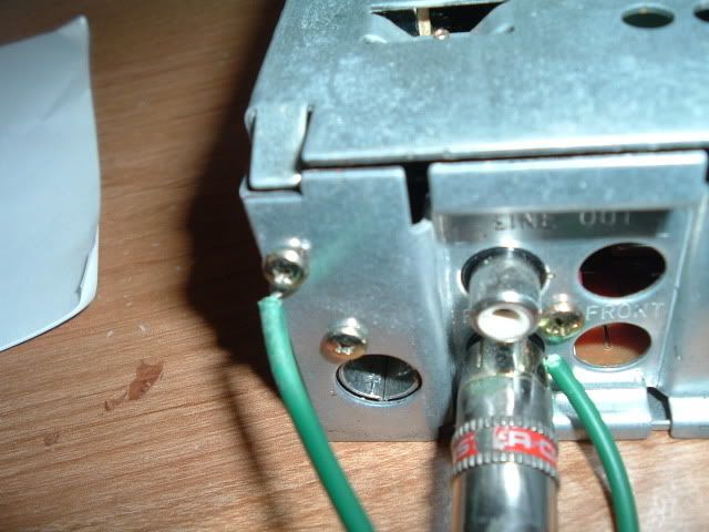

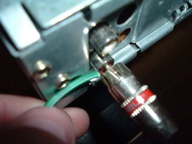

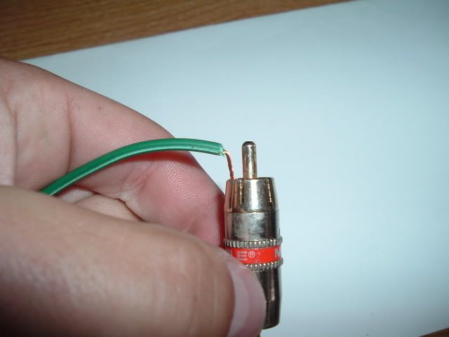

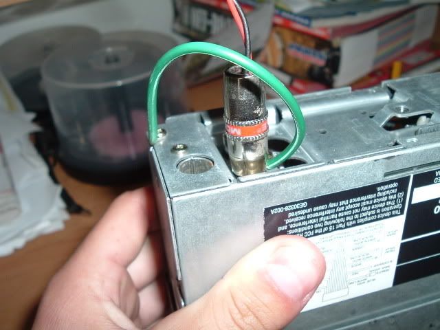

I have to say that i havent had any problems with pioneer but a couple people i know have to try this because of how bad of noise comes out of the subs thanks for the info man
np man ive been playin around with home/pa/car audio video sence i was 7 or 8 and just learn something new everyday, and x10 on the 250 for a 6900 i was gunna get the 9800 for $375 but if i gotta do this its gunna be out of the question but ive always had eather pioneer or kenwood, does kenwood have a nice new line for 08 and pioneer also i want soemthin cheap priced that has multi color display and can run an ipod without interface like has usb input on back, i think the 9800 does or it was kenwood i dotn kno <_< , but glad i could have helped yall, and its alot cheaper n faster to do it this way than waist $15 or so on noise filters that basicly dont do nothing for u, lol B)

yeah i have some noise...I think its because of the temporary crappy lanzar amp. Also another trick is to get use a 18 gauge length of wire and grounding one end to the HU chassis and the other to the amp that is causing the noise...works most of the time

nice write up! I have a couple pics of the same thing. It needs to be dont to both rca's if its done.

ya i only do one side of the rcas not both and ground it on the outside part not inside, the 6 channel shouldn't need all rcas grounded maby 3 if its that bad but most sub rcas dont have that bad of ground noise, mine wasnt an install error it just came from time and wires vibrateing around(even tho i got cable clamps on em bout every 6'' or better, it the rcas are close to each other ied just jump it from one to the other to the other and just ground from there to headunit should work, this is just another thing to check into when u get ground noise, and ya i love my pioneers but im thinkin of switchin to alpine or kenwood with usb input in teh back
