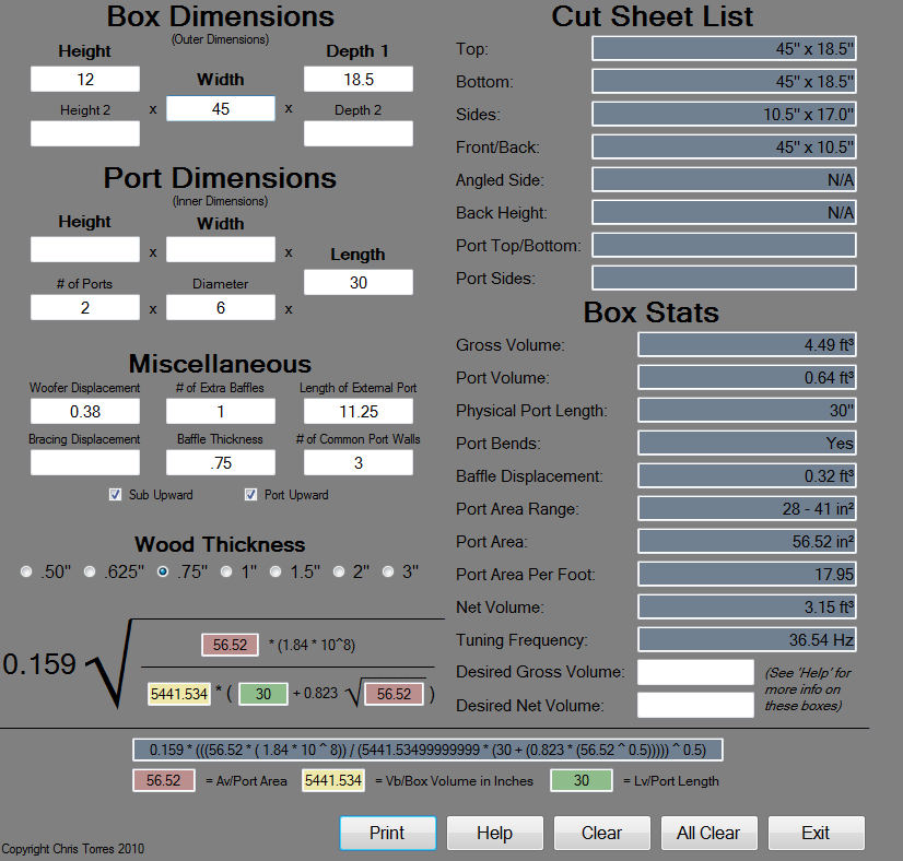

C.Sanchez.A Posted May 1, 2011 Report Share Posted May 1, 2011 (edited) I'm at it again, but this time I'm making up my mind. I'm building a box for 2 DC Audio XL 12'' running off a AQ2200 each. It's going in a '94 Mazda B3000 ext. cab (Link To Build). I was going to go with a complex box (Figure 1), but decided to go with something a little bit easier to make (Figure 2 & Figure 2.1). What do you guys think? Figure 1: Figure 2: Figure 2.1: Edited May 1, 2011 by C.Sanchez.A Quote Click Links To View Build Logs 1994 - Mazda B3000 (Daily/Toy/Show) 2002 - Mazda Protege (Daily) 1995 - Hyundai Accent (R.I.P.) 1984 - Bronco II (Restoration Project) Youtube Channel Link to comment Share on other sites More sharing options...

fecupe2001 Posted May 2, 2011 Report Share Posted May 2, 2011 I really like the port area, but damn, that box ended up been small doesn´t it? maybe i would ditch the second baffle, that way, you can gain a lot of internal space and just use a couple of good old threaded rods to brace that shit out, i´m telling you this because if you are tuning it @ 36 hz then you are looking to play some nice lows wich are a little bit too difficult with only 1.5 cubic feet per sub hommie, i do think the box should work nice but it can work even better if it´s bigger, just my opinion Quote I´m the SPL Gains topic creator!! wanna get louder?? check this: SPL Gains. Panamenian 2009 & 2010 & 2014 Bass Race 149.9 Champion! 2 15" subs and a 2K wired at 1 ohm, http://www.stevemeadedesigns.com/board/topic/167788-fecupe2001-2-15s-on-a-2k-video-on-page-3/ 8 Massive 15" subs and small power, http://www.stevemeadedesigns.com/board/topic/179296-fecupe2001s-8-15s-4th-order-bandpass-wall/ Link to comment Share on other sites More sharing options...
C.Sanchez.A Posted May 2, 2011 Author Report Share Posted May 2, 2011 I really like the port area, but damn, that box ended up been small doesn´t it? maybe i would ditch the second baffle, that way, you can gain a lot of internal space and just use a couple of good old threaded rods to brace that shit out, i´m telling you this because if you are tuning it @ 36 hz then you are looking to play some nice lows wich are a little bit too difficult with only 1.5 cubic feet per sub hommie, i do think the box should work nice but it can work even better if it´s bigger, just my opinion People for DC said that the 12'' XLS like 1.5... but from working with my current system I do realize the bigger box would get lower. As for making the box bigger I have more room to make the box taller. This is where my problem is I can't make up my mind. Grrrr. Quote Click Links To View Build Logs 1994 - Mazda B3000 (Daily/Toy/Show) 2002 - Mazda Protege (Daily) 1995 - Hyundai Accent (R.I.P.) 1984 - Bronco II (Restoration Project) Youtube Channel Link to comment Share on other sites More sharing options...
AI James Posted May 2, 2011 Report Share Posted May 2, 2011 may as well went with slot port honestly Quote Link to comment Share on other sites More sharing options...
fecupe2001 Posted May 2, 2011 Report Share Posted May 2, 2011 Rusty really recommends that small? Damn, i dunno about that then, try asking skittlesaregood, i need he have tested a lot his DC´s but they are level 4´s if i´m not mistaken... Quote I´m the SPL Gains topic creator!! wanna get louder?? check this: SPL Gains. Panamenian 2009 & 2010 & 2014 Bass Race 149.9 Champion! 2 15" subs and a 2K wired at 1 ohm, http://www.stevemeadedesigns.com/board/topic/167788-fecupe2001-2-15s-on-a-2k-video-on-page-3/ 8 Massive 15" subs and small power, http://www.stevemeadedesigns.com/board/topic/179296-fecupe2001s-8-15s-4th-order-bandpass-wall/ Link to comment Share on other sites More sharing options...
