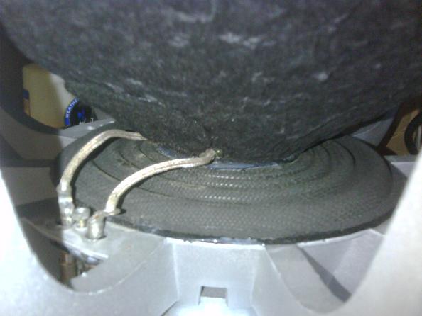

Thanks for the advice. What is the triple joint?
