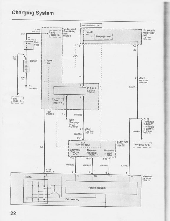

bongobennie Posted February 8, 2017 Report Posted February 8, 2017 I am doing a motor swap and wiring in a 2008 Honda Fit drivetrain in my car and the ELD is missing and not wanted, I will also have 1400watts of JL JX amps and an undetermined but upgraded battery with plenty of 1/0. The idea of a dash mounted high low (off?) voltage control switch with a voltage gauge sounds perfect. Is it safe to just get rid of the whole circuit and send a control voltage to the ECU (E15 on the schematic)? If someone can come up with a wiring solution I will PP someone for a bit of their time This is my first post, I found this forum on google and joined for this post, I've been snooping though, car stereo has come a long way since my HK TC600 2002 Honda Insight (08 Fit drivetrain), JL JX1000/360

Lupe Rodriguez Posted October 5, 2019 Report Posted October 5, 2019 Instead of bypassing the ELD can i just run an XS battery or something of similarity and run a 4g positive lead to a high output alternator and the stock lead to the fuse box so i can run my amps directly from the XS battery with a fuse of course, without damaging the battery? I dont know if a mechman HO alternator that i plan on getting has a regulator on them. i have 4g power and grounds and my voltage drops to the 10’s on a good bass note, im running the stock 75amp alt on a 98 civic.
Joshdashef Posted October 5, 2019 Report Posted October 5, 2019 1 hour ago, Lupe Rodriguez said: Instead of bypassing the ELD can i just run an XS battery or something of similarity and run a 4g positive lead to a high output alternator and the stock lead to the fuse box so i can run my amps directly from the XS battery with a fuse of course, without damaging the battery? I dont know if a mechman HO alternator that i plan on getting has a regulator on them. i have 4g power and grounds and my voltage drops to the 10’s on a good bass note, im running the stock 75amp alt on a 98 civic. I use a mechman 240A on my Honda Civic 2008 (8th gen) and my voltage with and without the ELD is basically 14.2 on load, (before I just disconnected the ELD I use to vary between 12.8 [when the ELD went into low output] and 14.2 [when the ELD went into high output] but never beyond that.) If you want higher voltage I would talk to the guys at Singer or US alts to see if you can get anything externally regulated. Not really sure what your saying as far as the battery goes but the ELD will restrict your voltage regardless if you run straight from the alternator (+) to a battery (+). If you go beyond 1k watts you should really look into 1/0 wire instead of 4ga SMD Tool Map (2024): https://www.stevemeadedesigns.com/board/topic/226545-smd-tool-map-2024/ Great Box Bracing Examples: https://www.stevemeadedesigns.com/board/topic/202148-best-way-to-brace-a-box/?do=findComment&comment=3055002
Lupe Rodriguez Posted October 5, 2019 Report Posted October 5, 2019 42 minutes ago, Joshdashef said: I use a mechman 240A on my Honda Civic 2008 (8th gen) and my voltage with and without the ELD is basically 14.2 on load, (before I just disconnected the ELD I use to vary between 12.8 [when the ELD went into low output] and 14.2 [when the ELD went into high output] but never beyond that.) If you want higher voltage I would talk to the guys at Singer or US alts to see if you can get anything externally regulated. Not really sure what your saying as far as the battery goes but the ELD will restrict your voltage regardless if you run straight from the alternator (+) to a battery (+). If you go beyond 1k watts you should really look into 1/0 wire instead of 4ga You’re right because i forgot about that wiring harness that goes to the ELD. Well from what you say i guess i should be ok with just doing the HO alternator upgrade and going to 1/0awg. If i still get voltage drops beyond 2v after that ill just tap into the ELD with the relay and switch method.
