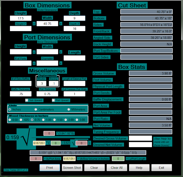

Had an Idea, I could build the box I designed, but I would change the port, so it would be 7.57 cubes for the box with .15 for bracing, the port would be 15H x 6.5w x 27L (internal size of port), giving me 100.75 sq inches of port space, 13.31 per ft, and the port would be 100% external, going through the back seats in the middle, up almost to the front, then I would mount the amp to the back of the hatch, so when you open the hatch the amp will be suspended in the air :D what do you guys think?
Box 7.57 cubes box (incudes .15 for bracing)
port 100.75 sq inches (13.31 per ft)
tune freq 31.88 with sub inverted
tune freq 32.8 with sub in normal
let me know what you think, also since the port would be mounted to a slanted side of the box, would I simply calculate the port area by sq ft of the port I designed, and calculate that into a port thats straight with the connecting edge being angled to be the same sq ft, so it would change length a little bit?
Or I could do all of that, but mount the subs in the box facing the back in the angled part, and I would build an extension of the box that goes up on top of the box, so something thats like 6h x 31w x 10d, and this would add another 1.5 sq ft to the box, getting me to like 8.8 cubic ft, and the amp rack could be built on top of that
how would it sound with the subs firing back at the hatch, they would have 3-4 inches of clearence between the box and hatch, its all rounded back there so I would think the bass would carry up front really well

ok designed a new box with great specs, let me know what you think, I have to measure to make sure the port depth will fit in the hatch, if its too deep I will make the port like 4-3.5 inches deep and widen the port to 24 inches or so :D
Box is designed for 2 DC Level 4 15" subs that I will buy in the spring, will put 2 kicker cvx 15" subs in there for now taking 2000 rms total, they should enjoy it
There will only be 3-3.5 inches between the sub and part of the port, hope that doesnt effect the sub too much, I will have dowels in the middle from the port to the box for support, I am building the box soon, so I want to finalize my design, any input is very appreciated!!!!
Since the port will be up by the ceiling and facing the front I will be lighting the inside of the port with red lights, this box is very different then anything I have seen before
I was recommeded by cj18 to do 30 hz tuning, 14 sq inches per cubic ft, and 3.5 cubic ft per sub, for 7 cubic ft total, here is what I made

Design doesn't look too great to me, sorry to hate. I don't know WHYYYYY you're so hell bent on 15s in that car of yours. DO 2 12's ported, quit manipulating all types of designs to try to fit 15s. I promise, 2 12s ported PROPERLY will blow you away and you'll wonder why you didn't trust it sooner.
Im not the one you want to try to troll. Just a fyi for you.
Dude, here is my situation, if I do 12's I might as well not come to the forum for the next 4-6 months, cause I wont have the money to buy these ridiculously expensive dc subs, which are worth it, but still fucking expensive. I wish you would explain why this box isn't so great, its to spec of everything that the subs want, 7 cubes total, 100 sq inches of port, around 14 sq inches per cube, 30 hz tuning, the port is fluid in its bends. The subs dont care if the port is internal or external in design, thats why im hell bent on these 15's, cause 15's hit lower, move more air, and its what I have for subs right now, and they are 2 pretty awesome subs (my cvx's). Don't take this as not being appreciative of your help, cause not many have even put there 2 cents in to help with this, they look at this thread and move on, so I appreciate your help a lot, I just am in a fuckin shitty situation :/ I dont wanna go 4-6 months without bass, I finally got the money to build a nice box, and the one I designed is to spec and should fit in the vehicle, plus I think it would look pretty insane and cool (cause its different), but idk, fuck me.... I'm about ready to just say fuck it and forget about the whole damn thing till next year
