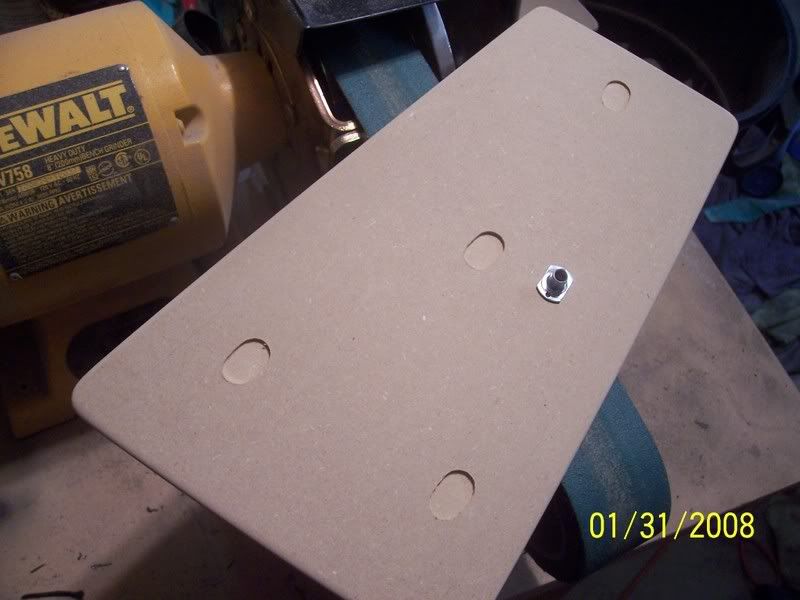

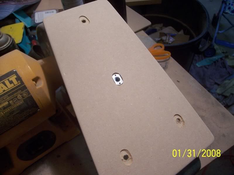

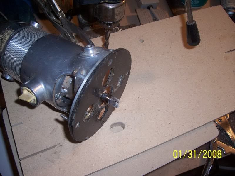

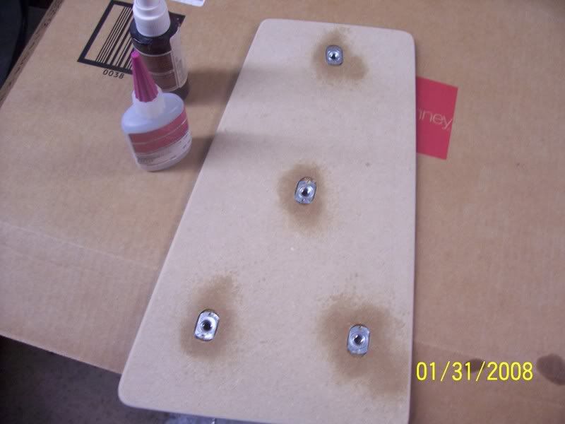

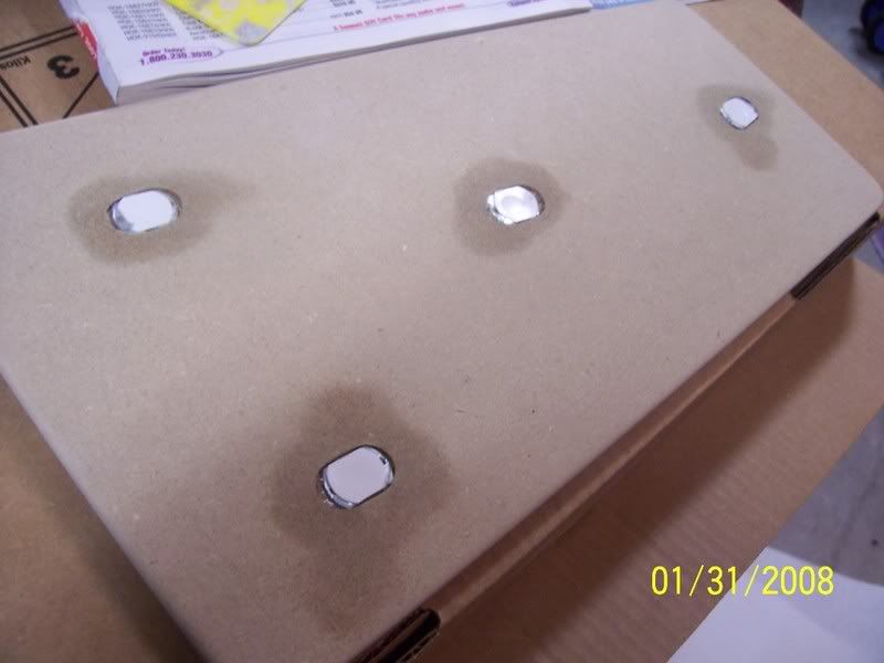

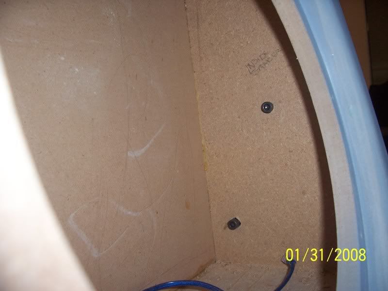

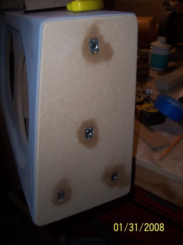

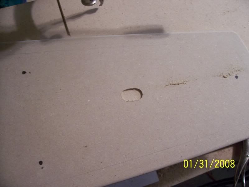

BAGGEDBIRDS.com Posted February 1, 2008 Author Report Share Posted February 1, 2008 attaching the end caps now. They will be vinyled serparately so they need to attached firmly. Going thru OSH the other day i saw some T nuts, so i used those. i had to make a little jig (sort of) to router a recess for the t nut. all routered - ready for t nuts CA glued them in with some accelerator Bolts inside of the box attached I had these sticker screw covers from a cheap cabinet i have in the garage. so i used them to put over the hole so the filler doesn't get on the threads. Quote 1st SMD "System of the Month" Feb. 2007 Zapco Studio 500 (2) Zapco Studio 300X Zapco Studio 204 (2) (2) FI 12ssd's w/ copper coils DLS Iridium Tweeters DLS UR2.5 MidRange FI. N.7 Midbass JL Audio TWK 88 Mechman 370A Elite Alternator Link to comment Share on other sites More sharing options...

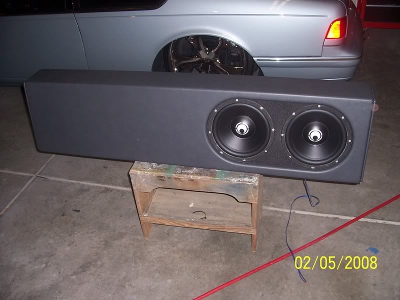

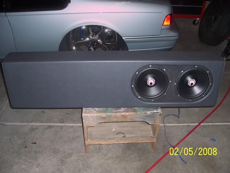

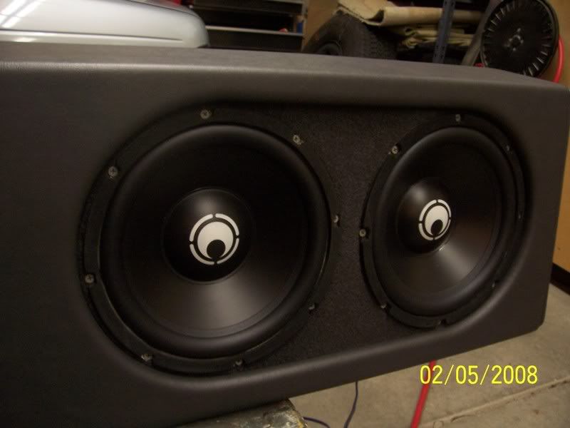

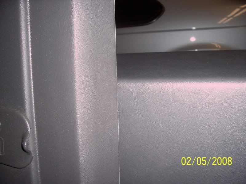

BAGGEDBIRDS.com Posted February 6, 2008 Author Report Share Posted February 6, 2008 Got my vinyl in. Finally finished it. Demo of the color match. I took some time trying to find the right match. I think I got pretty darn close. Quote 1st SMD "System of the Month" Feb. 2007 Zapco Studio 500 (2) Zapco Studio 300X Zapco Studio 204 (2) (2) FI 12ssd's w/ copper coils DLS Iridium Tweeters DLS UR2.5 MidRange FI. N.7 Midbass JL Audio TWK 88 Mechman 370A Elite Alternator Link to comment Share on other sites More sharing options...
LSN2meBoom916 Posted February 6, 2008 Report Share Posted February 6, 2008 Those endcaps came out great. Nice work man. Lets see a vid? How's it sound and how loud you think? Quote COOGLE SAID:"bro thats how we got where we are... buy making messes ...... i still learn all the time you just gota be willing to ruck up some shit" "In order to attain the impossible, one must attempt the absurd." ~ Miguel de Unamuno"One machine can do the work of fifty ordinary men, but no machine can do the work of one extraordinary man" -Elbert Hubbard"A proud man can learn humility...but he will be proud of that too" ~I forget who.I'm far from perfect and I know it better than anyone, but I hope to be good at what I do, when I do it...Installs I've done:My Integra: http://www.stevemeadedesigns.com/board/ind...?showtopic=3161The Lexus : http://www.stevemeadedesigns.com/board/ind...?showtopic=1535Law's Maxima: http://www.stevemeadedesigns.com/board/ind...ic=5568&hl=Jeff's 2500HD: http://www.stevemeadedesigns.com/board/ind...ic=5382&hl=Acura RSX-S: http://www.stevemeadedesigns.com/board/ind...?showtopic=3142Z-32 300zx: http://www.stevemeadedesigns.com/board/ind...?showtopic=34602004 Civic 4dr: http://www.stevemeadedesigns.com/board/ind...?showtopic=8190Trunk/Corner Box: http://www.stevemeadedesigns.com/board/ind...c=16036&hl=1969 Chevy C-10: http://www.stevemeadedesigns.com/board/ind...c=20319&hl=Seat-Back AMP-RACK How-to: http://www.stevemeadedesigns.com/board/ind...ic=9428&hl=Bunch of subs still for salehttp://www.stevemeadedesigns.com/board/ind...l=lsn2meboom916"It's game night...we're playin......sex."~Quagmire"When disneyland started it was powered completely by orphan children running on treadmills to generate e-lectrissty…and today, them children are New York Yankees". ~Dale Gribble"Fill it with ice...then pour it up to the top of the ice...& Shut da Fu** up!" ~Urs truly. Link to comment Share on other sites More sharing options...
BAGGEDBIRDS.com Posted February 6, 2008 Author Report Share Posted February 6, 2008 how loud of a US amp XT800.2 what 128db on a tone, maybe. I sounds good with music and its enough for the stock highs off the stock head unit I've used that cap design before on a friends box. to me it seems to be just about the only way to vinyl it without having something stitched. Quote 1st SMD "System of the Month" Feb. 2007 Zapco Studio 500 (2) Zapco Studio 300X Zapco Studio 204 (2) (2) FI 12ssd's w/ copper coils DLS Iridium Tweeters DLS UR2.5 MidRange FI. N.7 Midbass JL Audio TWK 88 Mechman 370A Elite Alternator Link to comment Share on other sites More sharing options...
