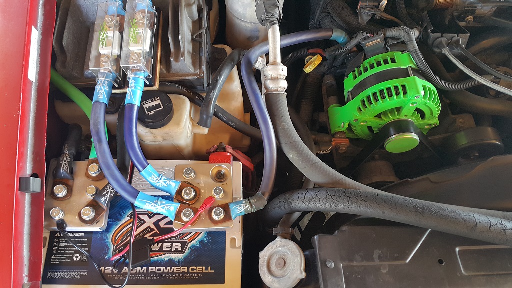

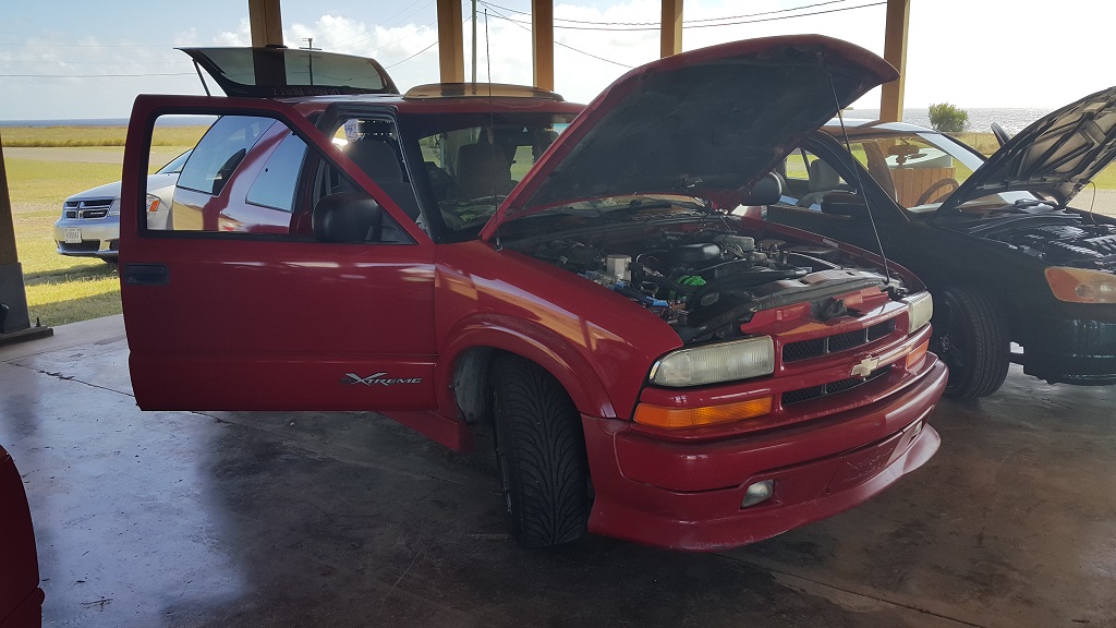

Big 3 done, and two runs (both Pos and Neg) of 1/0 from the front battery to the back bank... All Pos runs are fused on both ends...

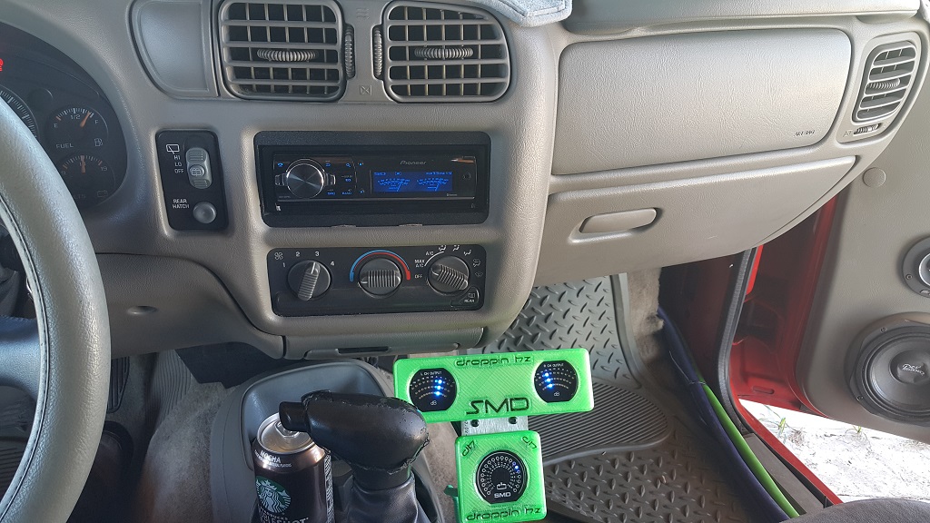

Custom 3d printed SMD Meter holders by Cody @ DroppinHz

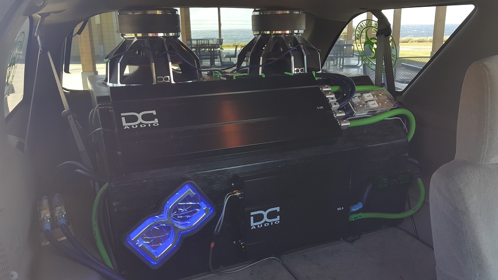

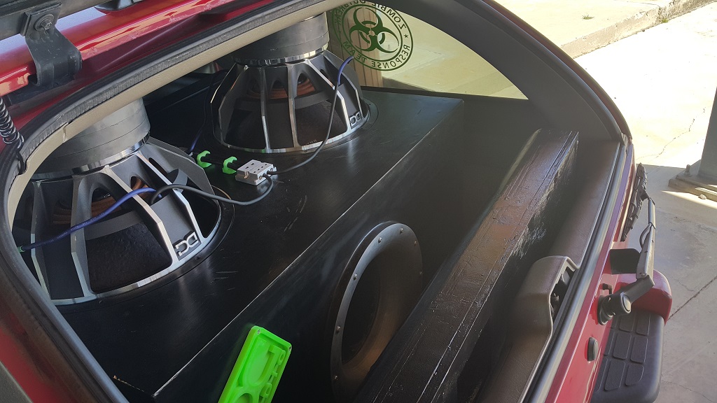

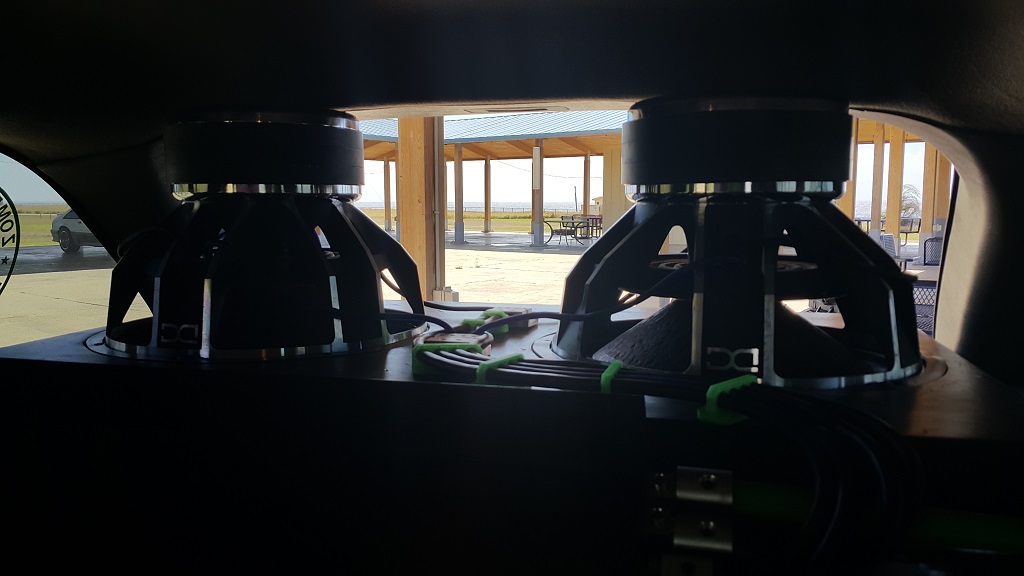

DC Audio M3 XL 15's inverted on a DC5K, with a DC90.4 for the PRV Neos and McLaren MLT2's... Toolmaker 2/0 Fuseblock with SHCA 2/0... Low Notes Garage DC Audio custom sign with blue LED's...

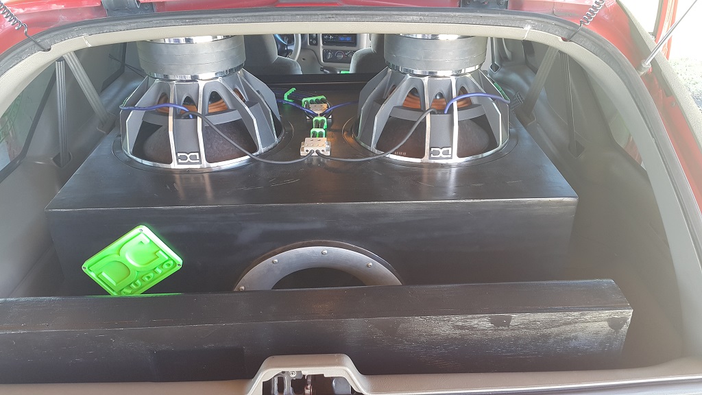

A rear veiw showing the 'loading' wall... The subs are too far forward due to the extra height on the M3 XL vs my old set of M2 XL, So I had a wall built to help with the port loading... Didn't help on the meter but did help round out the sound and also cut down the noise from the tailgate...

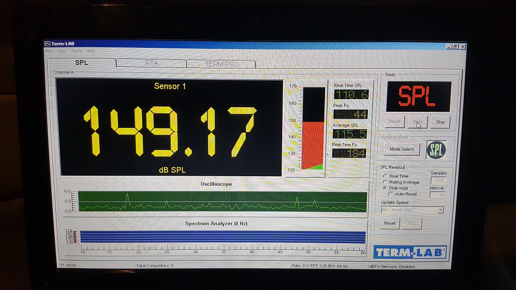

Not the Best score but not bad for what it is... Still looking for the 150+

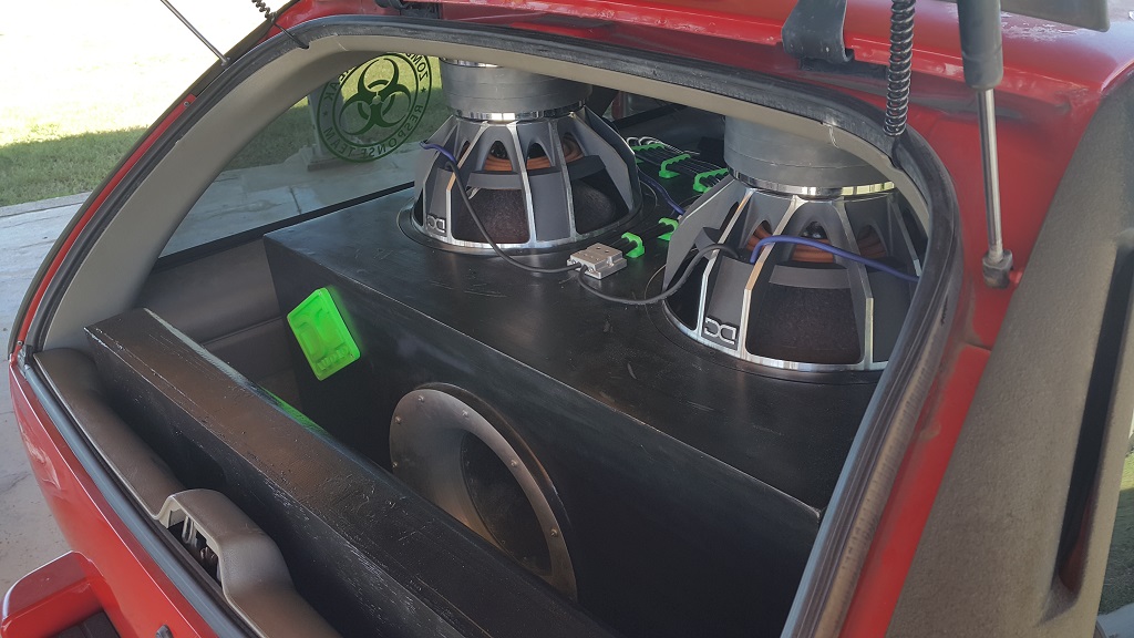

I got my subs in the mail on tuseday and here is the test fit...
