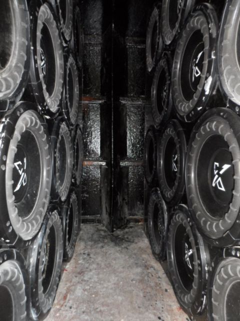

24 x3 soundstream 182 in 6 th order 100kw rms
hello la martinique

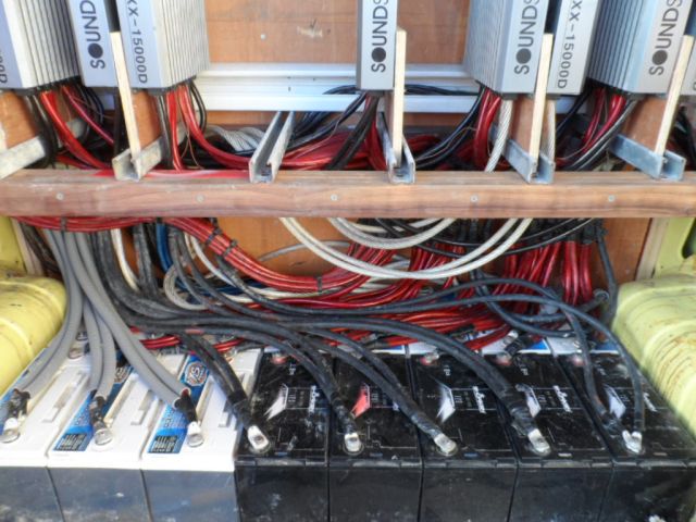

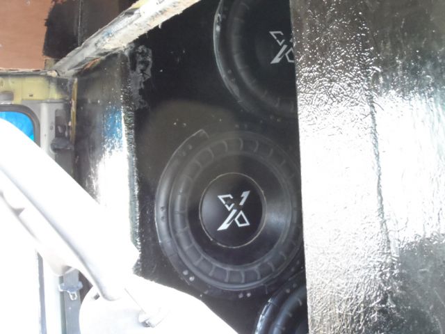

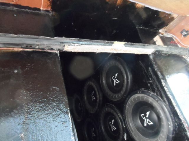

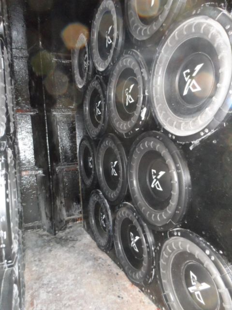

with my old box i ve a probleme with rear port too much open for demoing correctly but best score + 1.5 db on tl but in demo my woofer warm quickly and there too much power around 4000wrms on each sub one 15000D for 2 sub
so i prefer reduct port aire and lose db and reduct amplifier gain and beast demoing

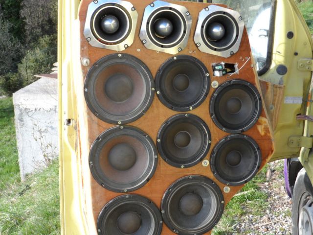

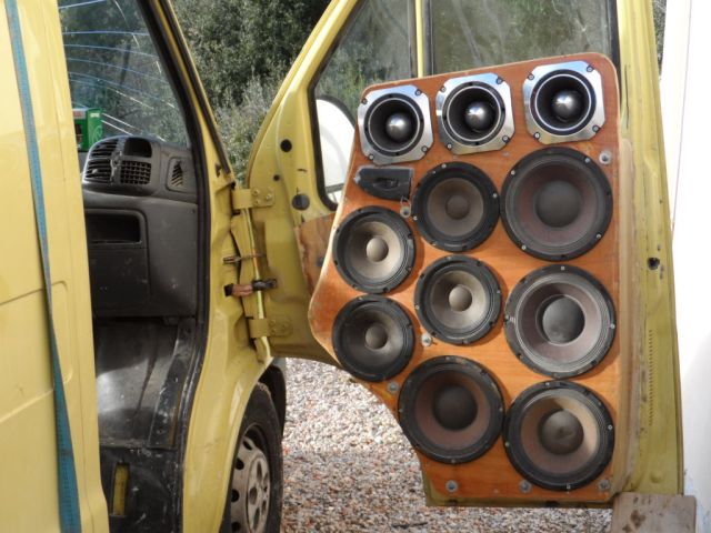

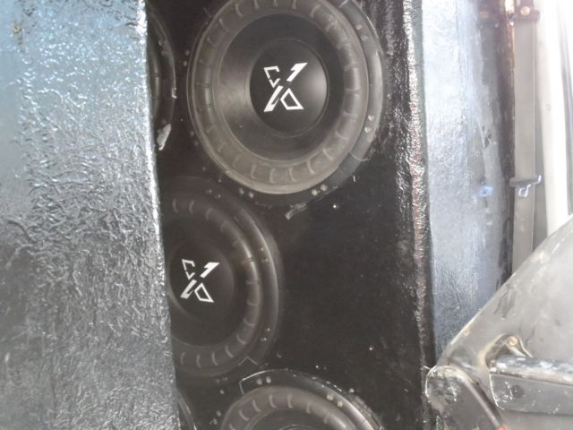

with mid in the doors like that sound is very better than mid in the doors and other in the back
it s impossible to close the doors without breaking winshield
i already do 163.4 db at 42 hertz i don t understand why i always peak at 42 hertz i hope 164/165 on burp and 162 in bass race
sorry formy language
