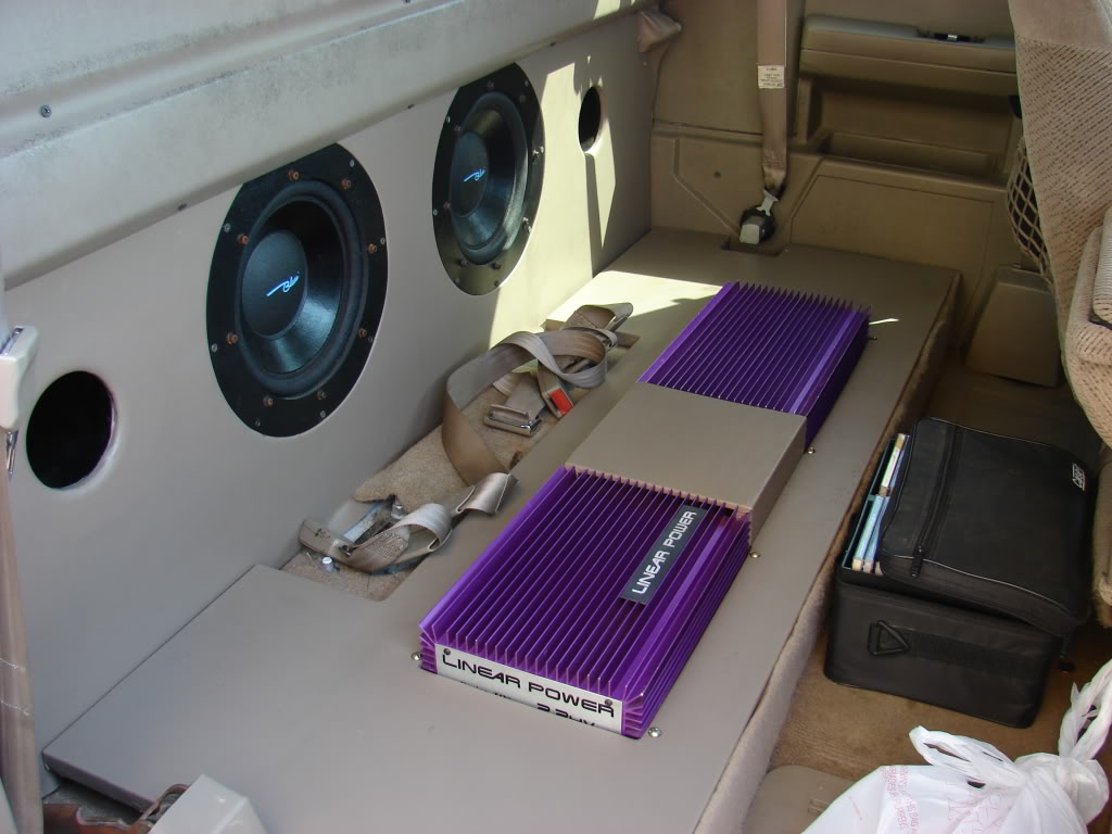

OK ... Everyone knows that I have a 1997 Chevy Silverado and it is primarily used as a Sound Quality competition vehicle ...
and this is the enclosure setup that I have now that needs to be pulled out and worked on ...
(please keep in mind that this is an old Pic of when the setup was first installed and for the most part, has not changed as far as the enclosure is concerned ...)
as it sits now ... It can do a 137.7 (windows up, doors closed, and mic up on the dash) at 28 htz ...
about the same for USACI SPL (driver door open, mic in the kick pannel, and playing a 56 htz tone) ...
