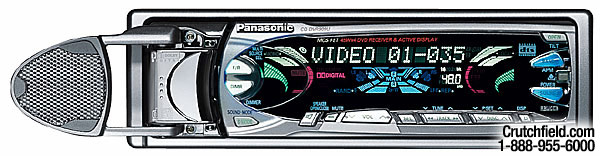

Markous Posted January 28, 2014 Report Posted January 28, 2014 This thread reminds me of that Panasonic unit with the little centre channel flip out speaker built in they came out with years ago. I think it had to be used in conjunction with a flip out DVD player but still cool nonetheless. '07 Ford Ranger - DM-608 I E700.4 I SA-CX6.5 v2 I SAZ-1500D 15th (x2) I Zv6 12" D1 I SB500-34 I JP40 I On 5/21/2015 at 7:07 PM, boom50cal said: of course he gives no fucks. it's a ford ranger. only bad mother fuckers drive ford rangers
Colin - STAPUFT Posted January 28, 2014 Report Posted January 28, 2014 ^ I still think about those every once in a while. Even then when they came out- I was like, oh no that will never do. That speaker is Way too small! 12 - 12"s in the STAY PUFT 1989 Chevy Astro Build & Comment Log Un-Interrupted Build LogYouTube Channel Chevy Trailblazer 5.1 Dolby Digital DTS Install You have a beard of a mysterious sea captain. I would follow you to hell and back.
