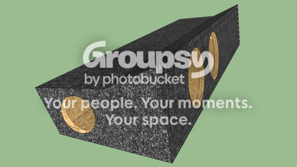

Might be a little late, but here's a design I came up with. Hoping it helps others. I've built 2 of the same and both sound pretty damn good. Yes it's minimal airspace and port but it gets down. Subs are e8v3's. Let me see if I can find picture of it installed. Fit perfect, only thing is front corners stick out beyond seat, but this is biggest box I could fit without seat lift.

Looks pretty sick. I wanted to do 4 sundown 8's in my ext cab Silverado but there just isn't enough room..... :shrug:
That's really good work man, that kerfing would be pretty difficult and it turned out really good. I don't really want it sticking out as much as the 10" height and 14" depth would make it but I'm also not gonna use 4 8s.

Nice looking box Juan. Pro7, if you have a table saw kerfing isn't that bad, just have to measure right. I believe JL has some three bar grills I like the looks of I might go with. Honestly everyone that rides in back is respectful of my truck so unless it's a complete accident I don't plan on my subs getting kicked.
This is slick work bro! Hopefully this helps OP.
Yeah I tried kerfing my last box and I got the cuts right or so I thought. It would always crack from not bending or being too thin. I think I had some crappy mdf or something.
I'll check out the JL grill and the ones on parts express, thanks for the recommendations. How'd you guys figure the volume of these crazy shaped boxes? Idk how I'm gonna figure tuning and net volume.
