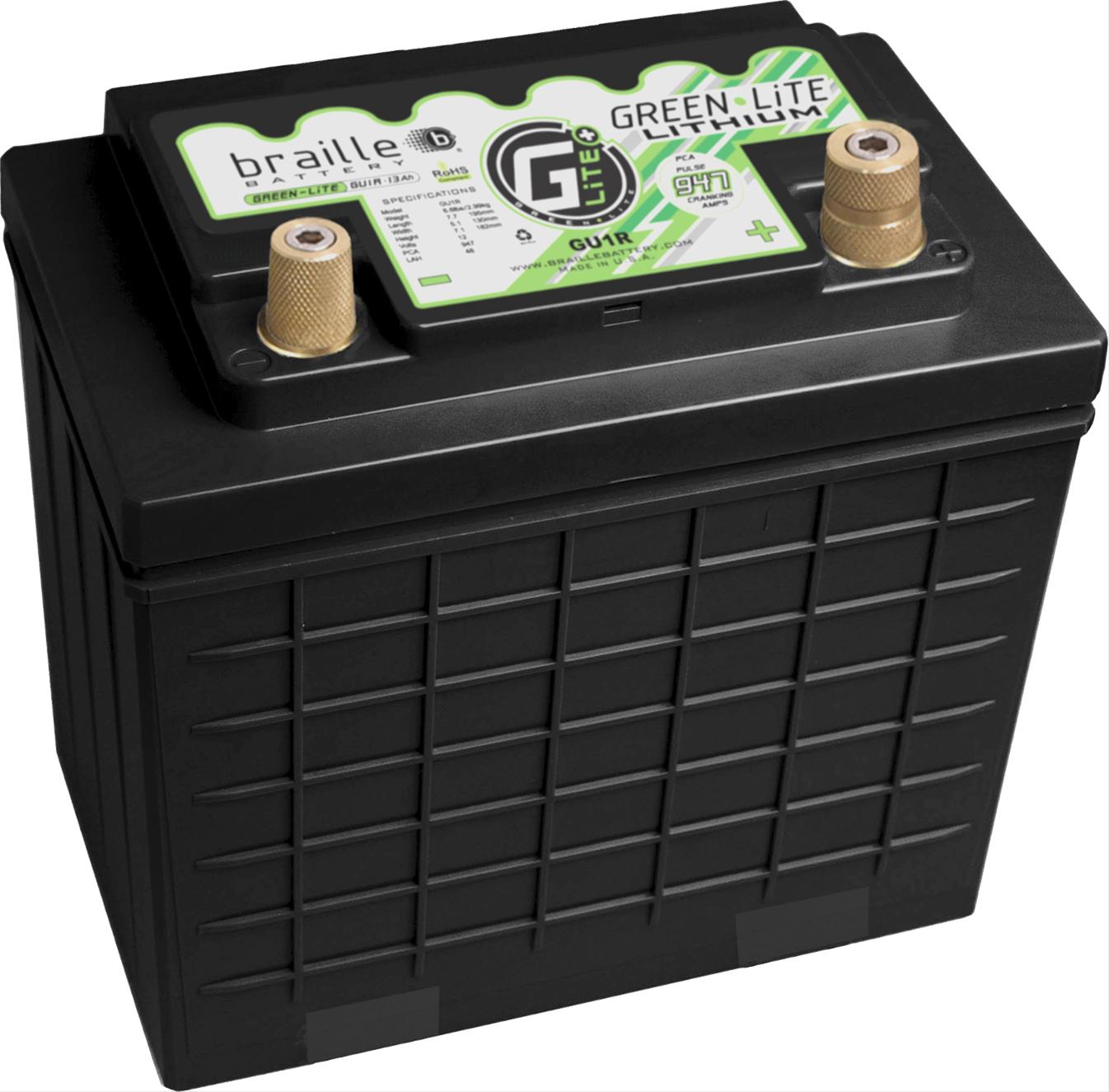

That battery looks interesting. What can you tell us about it?
I couldn't tell you detailed specifics but I can tell you that they're 40ah lipo batteries rated for 7kW. They're also SUPER light. I couldn't believe I was holding a battery when I picked it up. That's all I got on info though.
He summed it up. A 100a charge (50 continuous) and this battery would be fine on a 5k amplifier. it weights about 20 lbs if that.. at heatwave i struggled to hold it up by 1 finger for a picture. and im pretty comfortable with 3 fingers holding it. It will rest 13.6 or so... so it will force the northstar up some and will be dragged down some. It won't matter as long as i don't leave the car sitting for a week + and i plan on addressing that for easy access incase i do. This is a great choice for me because i wanted to keep my stock alternator and cut down on weight but still have a decent amount of power. Win win win.
