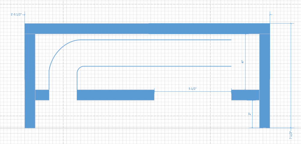

Jpshockster Posted February 10, 2017 Report Posted February 10, 2017 Can someone please help me with my box design? I built one box with a slot port that was 1" x 4" x 21" long but because of my enclosure size it had to fold back and fourth to get the length. the box seems to have a lot of port turbulence. I'm now considering a round port however the spec for the sub recommend 4"^2 at 32hz using a 3" port consumes too much volume and raises my tuning and using a 2" gives me the desired tuning but is under the suggested 4"^2 by .86"^2 will this cause a windy port? My outside dimensions are 6" tall x 17.75" wide x 10" deep ( the depth can increase by 1" at the top and 2" at the bottom if absolutely necessary. I am trying to tune around 45hz as this is going into a golf cart with the sub and port firing down. (there will be 1.5" between the bottom of the box and the surface the box sits on) so 1.5" from port face to surface and .625" from surround to surface. I am open to suggestions in any direction Note: sub and port fire down so they are protected form moisture and people.

kam311 Posted February 11, 2017 Report Posted February 11, 2017 I squeezed out a little more port area and the measurements seem to work. Its a bit more of a square port idea. This is a rough idea but maybe you can make it work. I also used .5 in wood which makes the difference in this case. so far... HU- pioneer DEH-P59001B Amp- crescendo BC2000D Wire- 1/0 awg welding lead Electric- Big 3 ^same wire Subs- 2 Obsidian Audio 12 d4's Box 4ft^3 ported at 33hz. designed by Ram-Designs

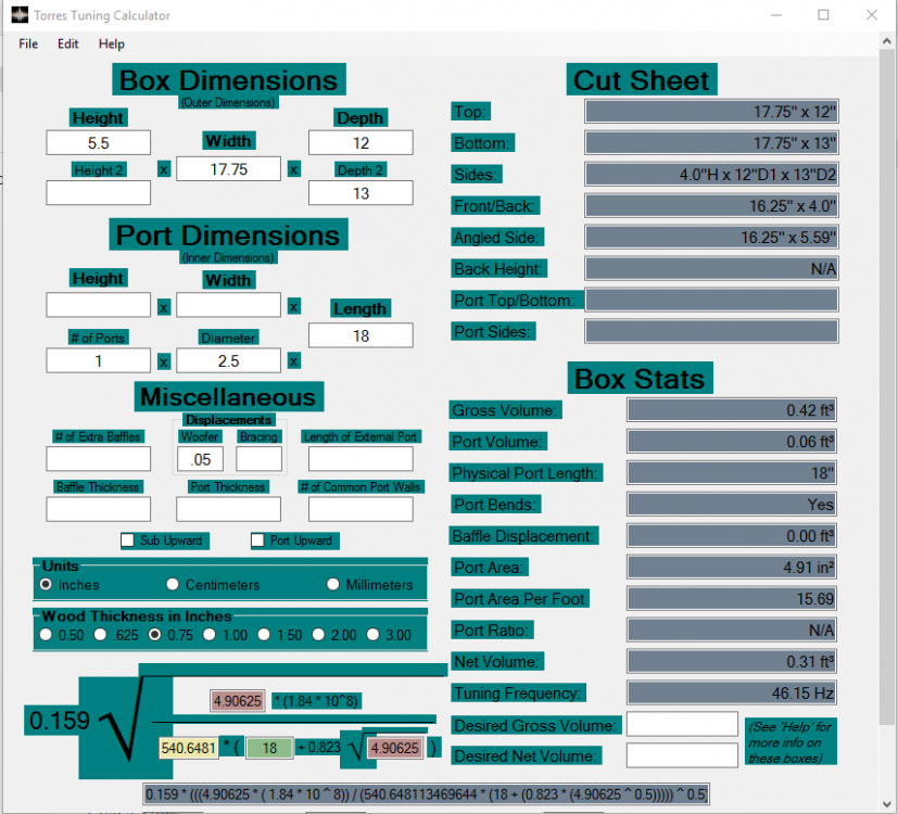

Jpshockster Posted February 22, 2017 Author Report Posted February 22, 2017 On 2/11/2017 at 2:49 PM, kam311 said: I squeezed out a little more port area and the measurements seem to work. Its a bit more of a square port idea. This is a rough idea but maybe you can make it work. I also used .5 in wood which makes the difference in this case. Thanks for the reply Kam311, I ended up making the box a little deeper and using 2.5" pvc pipe. .31^3 @ 46.15hz and it sounds much better than my first attempt
