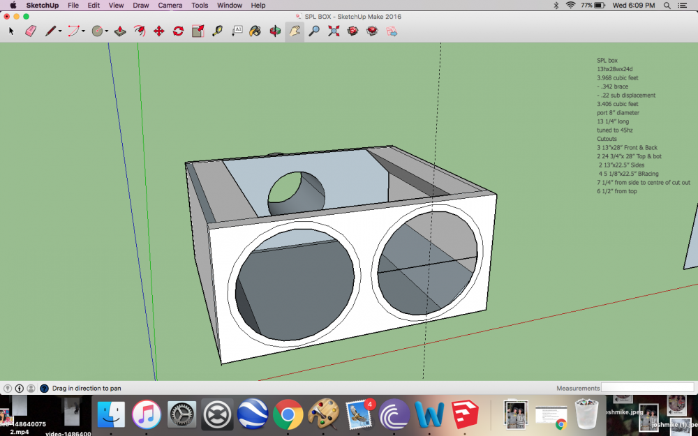

bigmacjack Posted March 30, 2017 Author Report Posted March 30, 2017 8 hours ago, fecupe2001 said: if i design you the box, would you actually build it? not trying to be a dick but i've designed many boxes straight for spl comps and spent time doing it on this forum and almost no one build them, i've had few good scores in the past btw yes i would definitely build it but i talked to a few other people and i have a design i am going to try. ill upload some pictures and id love to hear any tips or suggestions you might have for me.
bigmacjack Posted March 30, 2017 Author Report Posted March 30, 2017 Just now, bigmacjack said: so a couple changes i have made: i have taken off an 1/8" too save on wood i have decided to add 1" dowels between the sub going to above and below the port now doing those things has lost me some volume and i am at 3.33 now. i am a little concerned that this is going to be too low for the subs. I'm using 2 12" AA Havocs that i reconed with a couple of upgrades
fecupe2001 Posted March 30, 2017 Report Posted March 30, 2017 box is too big tuned to low, specially for that specific cabin, try a 15x15x15" external dimensions box, one sub up and one sub back, 8" aeroport facing to driver´s side about 16" long, should do around 148 dbs on 1k and close to 150 on 2k I´m the SPL Gains topic creator!! wanna get louder?? check this: SPL Gains. Panamenian 2009 & 2010 & 2014 Bass Race 149.9 Champion! 2 15" subs and a 2K wired at 1 ohm, http://www.stevemeadedesigns.com/board/topic/167788-fecupe2001-2-15s-on-a-2k-video-on-page-3/ 8 Massive 15" subs and small power, http://www.stevemeadedesigns.com/board/topic/179296-fecupe2001s-8-15s-4th-order-bandpass-wall/
bigmacjack Posted March 30, 2017 Author Report Posted March 30, 2017 23 minutes ago, fecupe2001 said: box is too big tuned to low, specially for that specific cabin, try a 15x15x15" external dimensions box, one sub up and one sub back, 8" aeroport facing to driver´s side about 16" long, should do around 148 dbs on 1k and close to 150 on 2k Ill have to try this on my next box i've already started cutting my wood, i was a little to anxious to start building haha. thanks for the info though! i really appreciate it!
