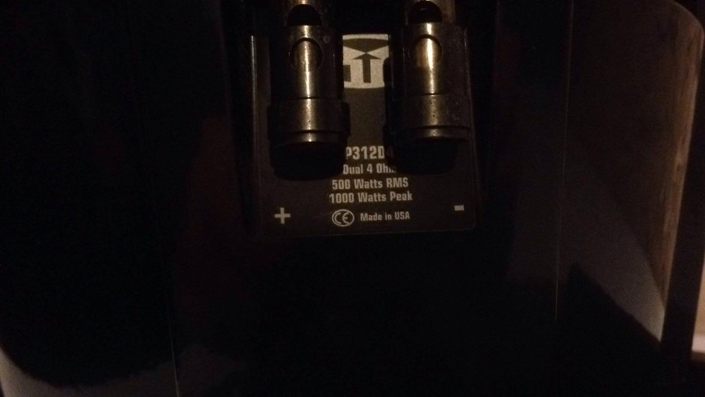

SNYPER Posted April 9, 2017 Report Posted April 9, 2017 Building a new box for older P3D4 12's.Car is 06 Malibu.After much research seems theese subs perform better in a ported opposed to sealed.I was going to go off the RF "powerhouse build" but unless i modify LxWxH it wont fit doubled for 2 subs,and from all i read the majority says RF builds aren't great nor precise. The amp i have is a budget cheapo Black ice 7000.1 and i was going to wire for 2ohm but have been told i can wire these subs to 1ohm which would be ideal.Sorry im kinda scattered right now any help/advice would be appreciated!

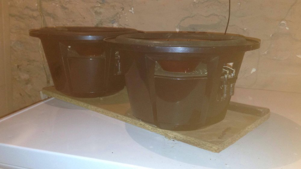

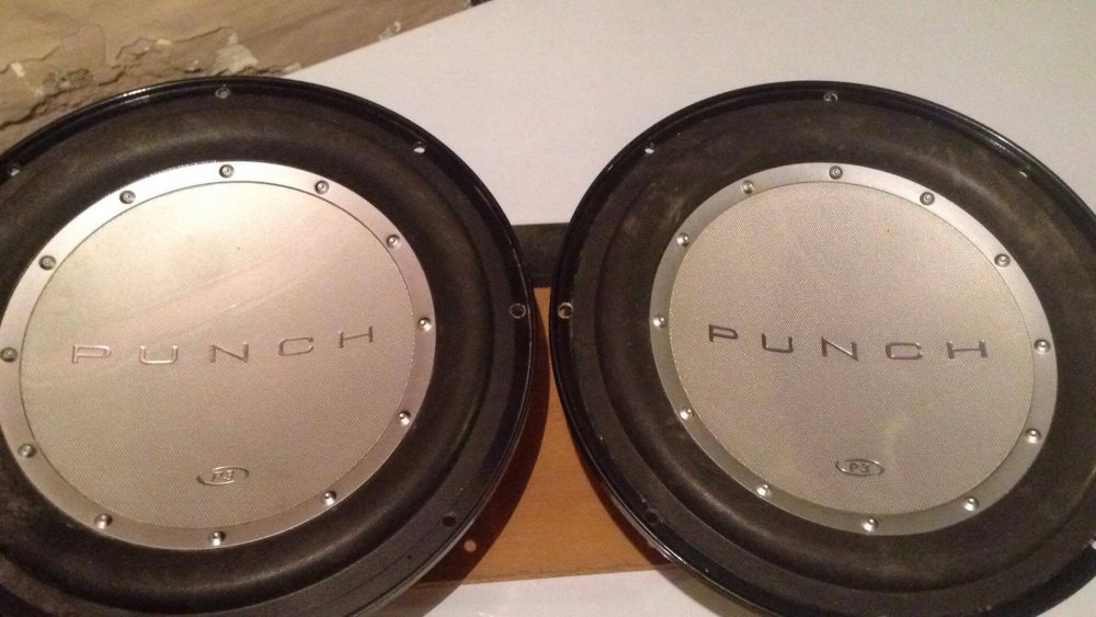

Triticum Agricolam Posted April 9, 2017 Report Posted April 9, 2017 How old are the subs? Do you have any pics? "Nothing prevents people from knowing the truth more than the belief they already know it.""Making bass is easy, making music is the hard part."Builds:
SNYPER Posted April 9, 2017 Author Report Posted April 9, 2017 ill take some one second,excuse my camera on my phone blows,their bit dusty from sitting on my shelf need wiped but all great shape,still super tight.
Triticum Agricolam Posted April 9, 2017 Report Posted April 9, 2017 That's perfect, just what I need. Here is the specs on those subs: http://www.rockfordfosgate.com/rftech/library/2004/5_subwoofers/p312d2-p312d4-ts.pdf So looks like RF recommends anywhere from 1.75 to 2.5 cu ft of net airspace per sub. What will be best for you depends on how much space you have to work with, what kind of music you listen to, your goals for the system, etc. A general recommendation would be for 4 cu ft total for the two of them, tuned to 30-32 Hz, with 60 sq in of port area. This should be good for up to 2,000 watts. "Nothing prevents people from knowing the truth more than the belief they already know it.""Making bass is easy, making music is the hard part."Builds:
