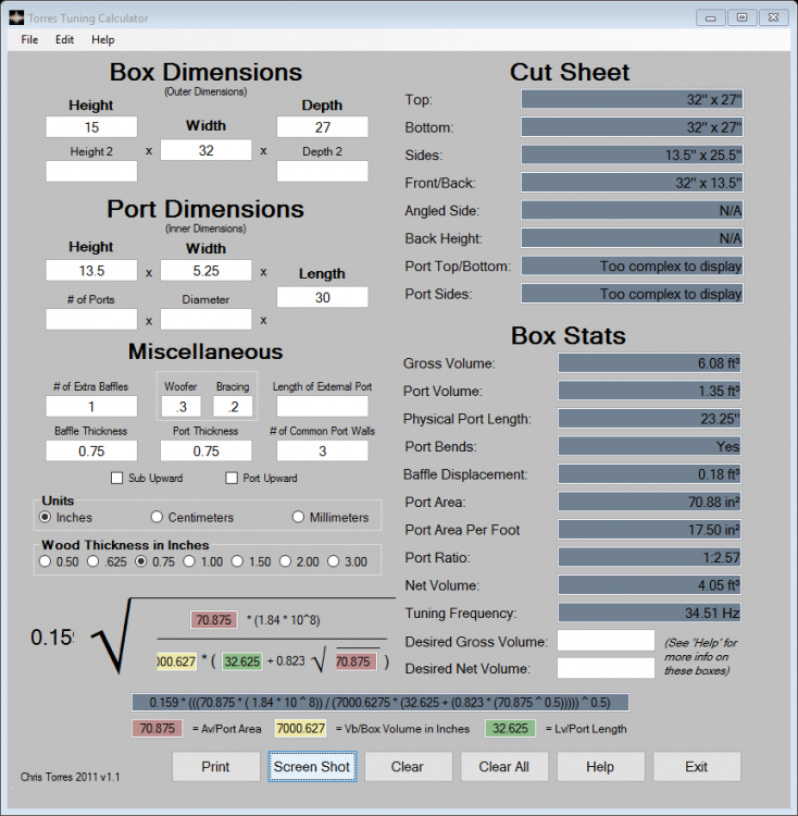

Triticum Agricolam Posted June 29, 2017 Report Posted June 29, 2017 15 minutes ago, Aaskia said: I have 32x32x15. I can just mount the amp to the box. That will work. Here is my suggestion. You should have just enough room to fit two 12" subs and a 5.25" wide port along the front. "Nothing prevents people from knowing the truth more than the belief they already know it.""Making bass is easy, making music is the hard part."Builds:
Aaskia Posted June 29, 2017 Author Report Posted June 29, 2017 Thank you so much. I'll be sending the 10s back today and ordering the sa12s.
