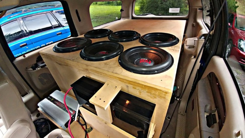

sencheezy Posted August 16, 2017 Report Posted August 16, 2017 High Voltage Lithium Initial thoughts and overview. 1 350 volt Michigan Solar Energy High Voltage lithium battery. 1 Taramps T60K wired at .5 Starting voltage: 307 Final Voltage drop: 266 ~220vac 92 amps output ~266vdc 82.7 amps output 92% efficient 20,000 watts rising to 2.4 ohms clamped. The battery FYI is 6ah. Cost between 3-5 grand. Weighs 60 pounds. And the amp is $1700. 307v is less than 20% charge. Battery is 1.8kwh. 1c rate is 1,800w for 1 hour 2c rate is 3,600w for 30 min 4c rate is 7,200w for 15 min So far, I'm extremely estatic about the results and the future possibilities using these technologies together. Just think, you can literally burp 20,000 watts, out the trunk of a BMW or smart car haha. Where this cost would be justifiable, would be for applications that requires a lot of power, low weight, and space savings. This battery is only 27"x17"x4". So the power density per space is truly unmatched. I will be posting more of my findings, so stay tuned. Also, you can add as many as you want in parallel to get some really stupid power levels. *BONUS* The excursion did a 157.x outlaw @ 41hz wit that 20k. So I'm really excited about that! Rayshawn Lawrence built the enclosure. 165db with 237 DC Volts 6 15" SSA Evils 3 HV Taramps T60k @.33 18 XS Power D3400s Add me on SC, FB, IG, and YT @ Sencheezy
sencheezy Posted August 16, 2017 Author Report Posted August 16, 2017 Uploading a photo shouldn't be this difficult lmao 165db with 237 DC Volts 6 15" SSA Evils 3 HV Taramps T60k @.33 18 XS Power D3400s Add me on SC, FB, IG, and YT @ Sencheezy
sencheezy Posted August 16, 2017 Author Report Posted August 16, 2017 [URL=https://goo.gl/photos/479zkEVBdipVRhDw9]https://goo.gl/photos/479zkEVBdipVRhDw9[/IMG][/URL] 165db with 237 DC Volts 6 15" SSA Evils 3 HV Taramps T60k @.33 18 XS Power D3400s Add me on SC, FB, IG, and YT @ Sencheezy
sencheezy Posted August 17, 2017 Author Report Posted August 17, 2017 Well guys, I can't figure out how to share these pictures. Smh. 165db with 237 DC Volts 6 15" SSA Evils 3 HV Taramps T60k @.33 18 XS Power D3400s Add me on SC, FB, IG, and YT @ Sencheezy
