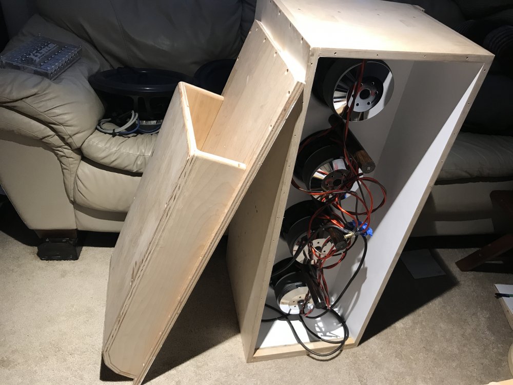

audiofanaticz Posted October 2, 2017 Report Posted October 2, 2017 Just curious if you have any pictures of the box? Also do you know what version sa-8s you have? I know the newest version (v3) says its not recommended for sealed, but the v1, v1.5, and v2 do fine in sealed. One would almost have to model the v3 (if thats what you have to see how it performs in sealed enclosures). Typically a properly built sealed box will crap all over a ported box that is either too small, to little port, or a combination of both those things. However seeing that your port is on the small side of things already your current box almost maybe be acting as if its sealed. But out of curiosity I would grab a towel and stuff it in the port and give it a listen just to see if performance increases or decreases. Im not sure on your building skills or the skills of the person your having build the box, but what a lot of people do to get the most space out of a under seat box is they will make the bottom of the box fiberglass that is a direct mold of the truck floor. This gains you a lot of extra space, but it is more time consuming and a bit of work depending on your skill set.
WalledSonic Posted October 3, 2017 Report Posted October 3, 2017 22 minutes ago, bleedingblue said: That is a big port. How wideAnd long 4.5" x 12.5" x 26" long. The port is probably a bit too long for a 4th order, but its easier to cut some port length out than to try to add it back. We may shorten it after the subs break in but we'll have to wait and see how it sounds first. Good luck man, keep at it. You'll get something to work out. I originally designed my buddy's box for (3) 3" ports, but had to change the design completely once I realized I didnt size the port right. Chevy Sonic Wall (4) 15's on 10k Build Log https://www.stevemeadedesigns.com/board/topic/209412-2015-chevy-sonicwall4-15s10klithiumlarge-case-hairpin-us-alts/ (4) Fi SP4 15's | (2) Ampere 5Ks | Active! | Arc KS600.2 & KS125.2mini | CDT Silk Domes | Silver Flute 8s | 240Ah JY | US Alts Jeep Wrangler JK (4) 8's in a 4th Order Build Log https://www.stevemeadedesigns.com/board/topic/209841-shadow-2016-jeep-wrangler-jk4th-order4-8sdc-35klarge-case-hairpin-us-alts/ IG @walledsonic
