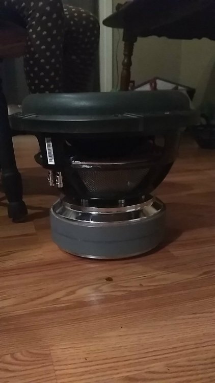

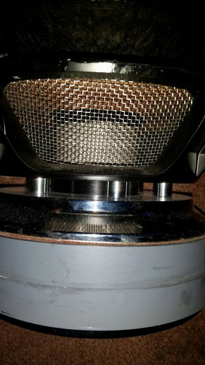

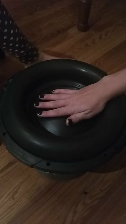

Cmac433 Posted November 17, 2017 Report Posted November 17, 2017 Hey guys, im new to the site..been in the car audio scene for years though. I have a custom built t3 t2000 12" sub. Has the hp500 black coil. Sundown soft parts with megaroll surround. I have been hearing good things about aeroport boxes..but can't find any specs online. Anyone have a input?
