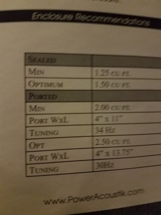

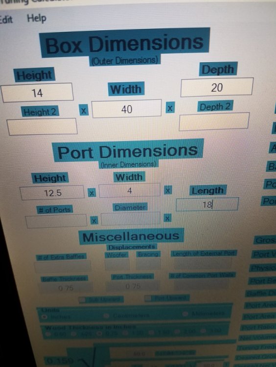

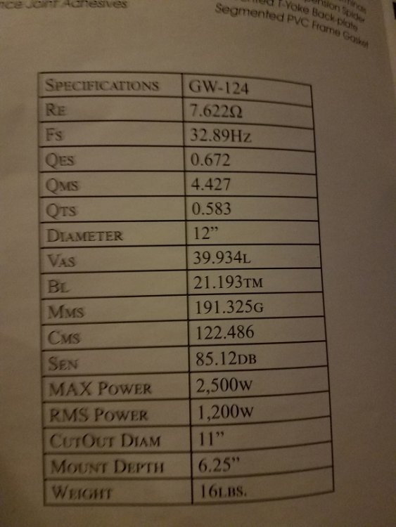

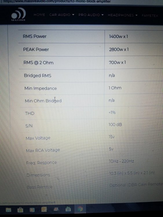

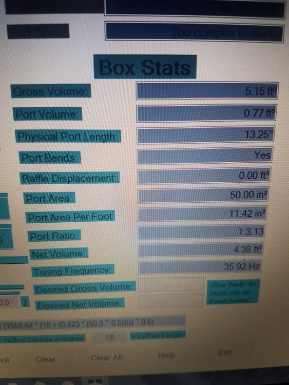

the_village_idiot Posted December 15, 2017 Report Posted December 15, 2017 So first ill say that this is my first post here. Ive been lurking reading for countless hours trying to figure out what im doing. I would like to maximize the performance of my equipment. (which, yes i know, its all garbage) So ill list all the info that i think is required and maybe someone with some knowledge can help me out. So, i have a 95 jeep cherokee, stock 90a alt. 1/0 power and ground wires as well as the "big 3". I have a massive audio class d n3 1400w rms (or so it claims) two 12" power acustik gothic drivers wired at 1ohm in a ported box. (details in pictures) My question is, is my box design even close to being right? Its already built and it sounds decent, but i want to know if theres more potential. I have attached the driver, amp and box info. Any input would be greatly appreciated. Im new to this and need help.
the_village_idiot Posted December 15, 2017 Author Report Posted December 15, 2017 my current box details
Triticum Agricolam Posted December 15, 2017 Report Posted December 15, 2017 There really isn't anything wrong with what you have now. You could make the box a bit bigger, which would get you a little more low end output, but its not going to make a big difference. It wouldn't be worth rebuilding the box IMHO. "Nothing prevents people from knowing the truth more than the belief they already know it.""Making bass is easy, making music is the hard part."Builds:
the_village_idiot Posted December 15, 2017 Author Report Posted December 15, 2017 14 minutes ago, Triticum Agricolam said: There really isn't anything wrong with what you have now. You could make the box a bit bigger, which would get you a little more low end output, but its not going to make a big difference. It wouldn't be worth rebuilding the box IMHO. Thank you for replying. Ill be honest, thats the answer i was hoping for. I have another question, but im not really sure where to post it, These drivers claim to be rated for 1200w rms each and im guessing im giving them 800 total, so 400 a piece. Would it be worth my time to upgrade to a larger amplifier?
Triticum Agricolam Posted December 15, 2017 Report Posted December 15, 2017 40 minutes ago, the_village_idiot said: Thank you for replying. Ill be honest, thats the answer i was hoping for. I have another question, but im not really sure where to post it, These drivers claim to be rated for 1200w rms each and im guessing im giving them 800 total, so 400 a piece. Would it be worth my time to upgrade to a larger amplifier? Probably not, mainly because it takes a LOT more power to make much difference in how loud your system sounds to the ear. If you double your watts that will gain you at most 3 dB. 3 dB to the ear only sounds slightly louder. With your 90 amp alt (I feel your pain, I have a '97 XJ) you will pretty much have to upgrade to run any bigger amp, which gets expensive fast. "Nothing prevents people from knowing the truth more than the belief they already know it.""Making bass is easy, making music is the hard part."Builds:
the_village_idiot Posted December 15, 2017 Author Report Posted December 15, 2017 ok, thank you for your honesty and knowledgeable insight.
Joe X Posted December 15, 2017 Report Posted December 15, 2017 If you gave 50 square inches of port area to both subs you probably have low port area, at least relative to their recommendations, 4x11 for the smaller box which is for one driver only. This would become more of an issue at higher power though,

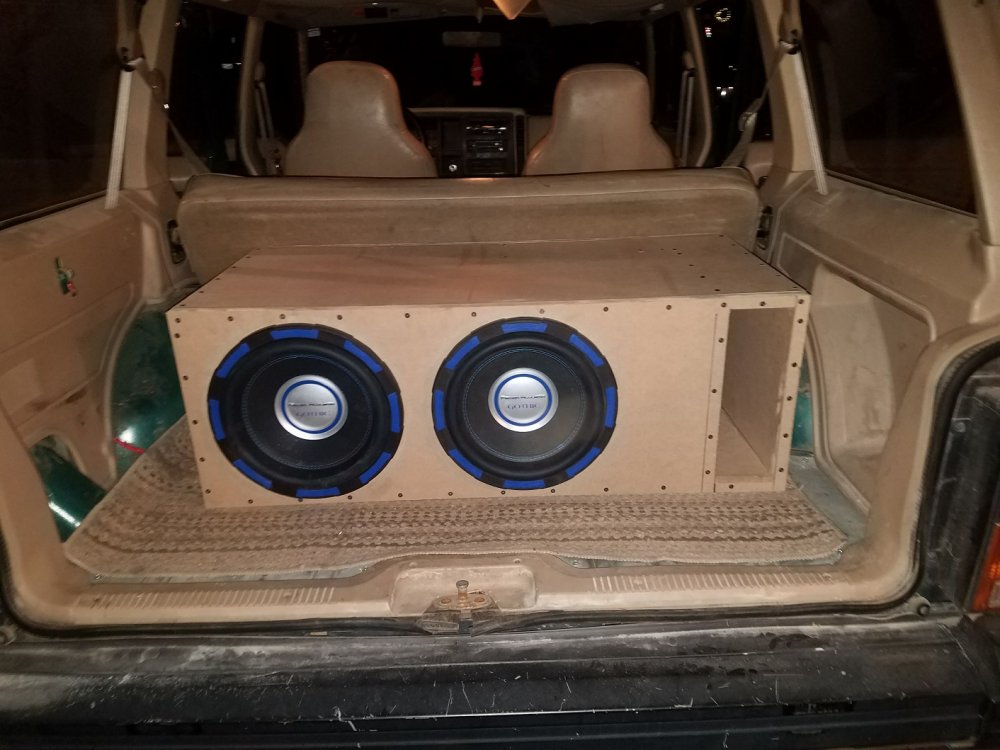

the_village_idiot Posted December 17, 2017 Author Report Posted December 17, 2017 how about some pictures..... try to ignore my crappy carpenter skills and rats nest of wires.
Kyblack76 Posted December 17, 2017 Report Posted December 17, 2017 Jesus man. Cut yourself some slack. Your doing fine. Asking proper questions, and responsive to answers. Is it playin? How ya like it? SMD SUPER SELLER The Burban Build Blazer Build sold Acura trunk build sold
Kyblack76 Posted December 17, 2017 Report Posted December 17, 2017 Also, on yoir amp output, I see, u shaped jumpers. What's going on there ? SMD SUPER SELLER The Burban Build Blazer Build sold Acura trunk build sold
