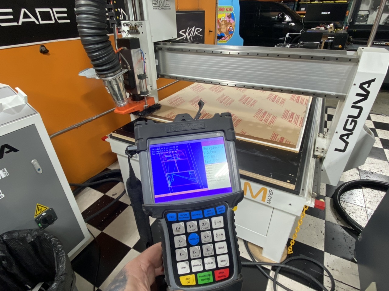

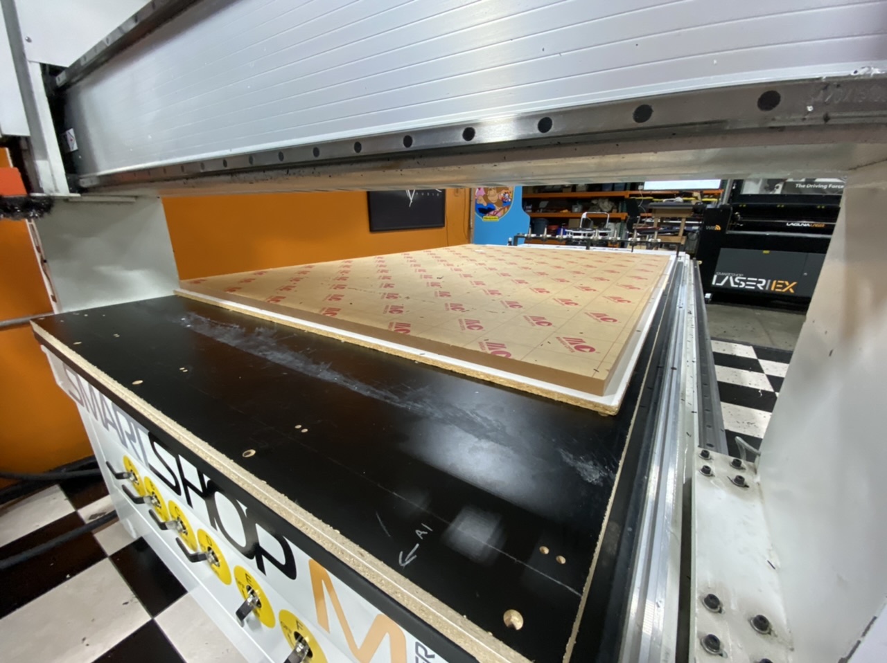

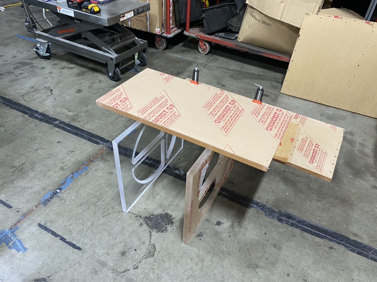

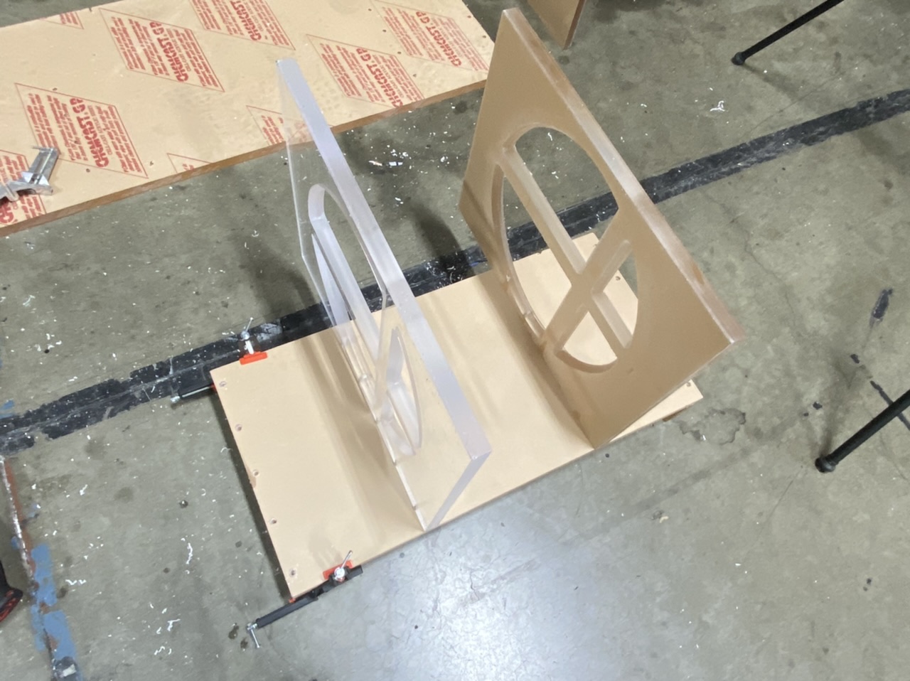

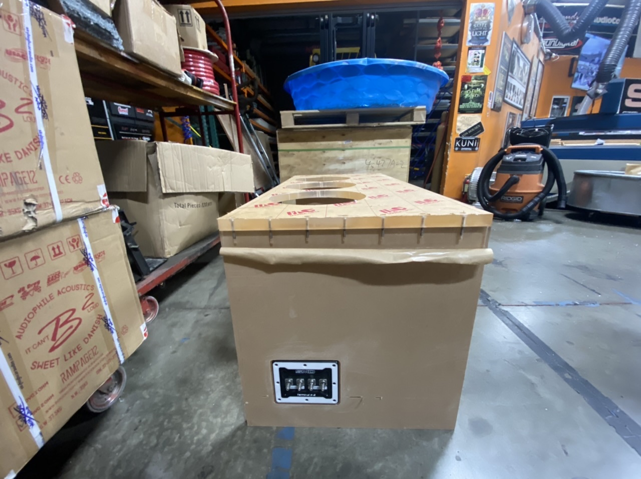

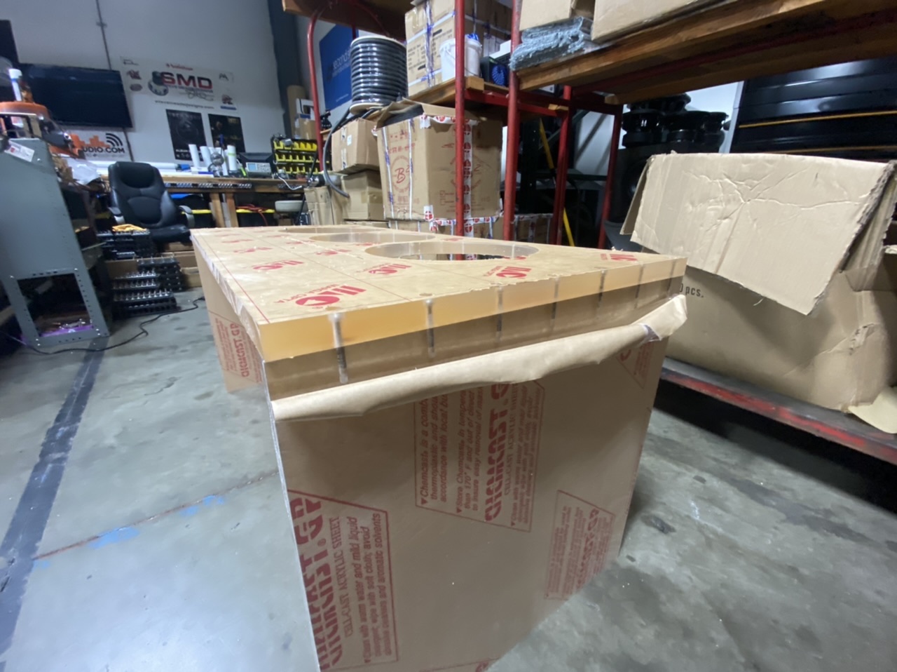

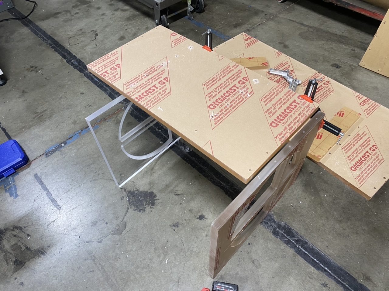

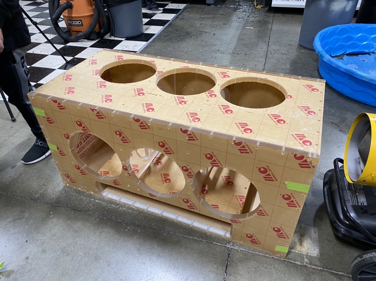

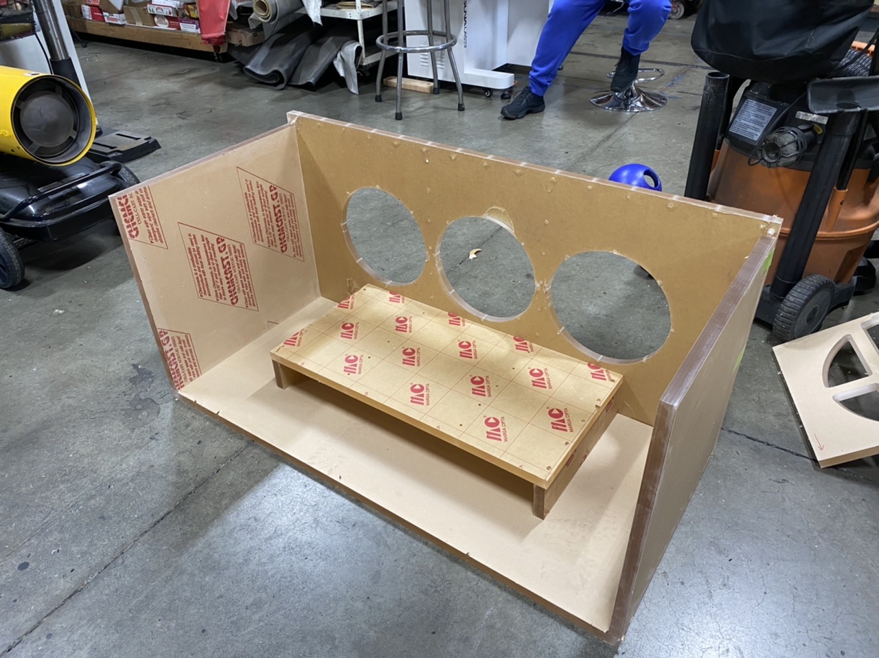

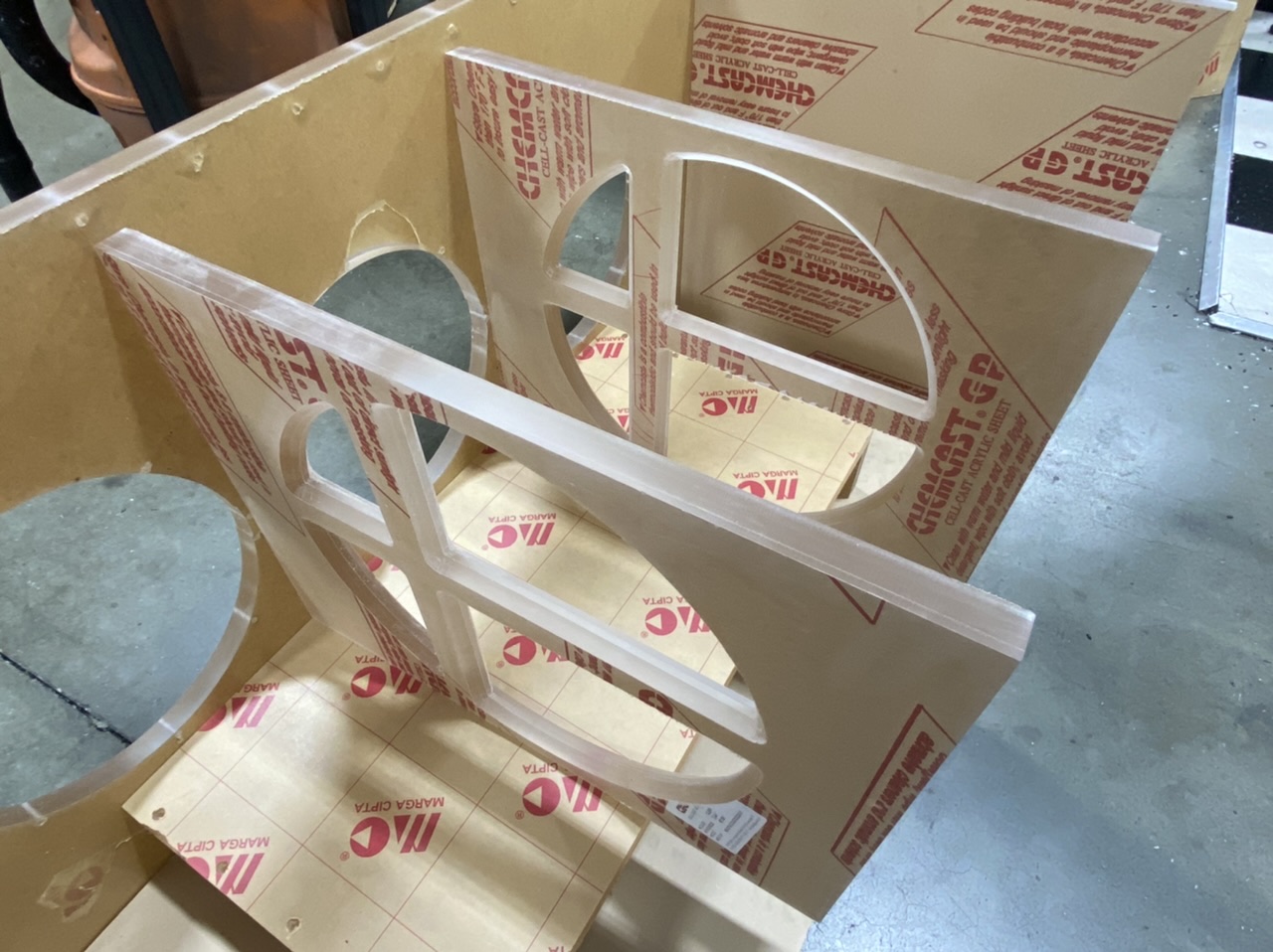

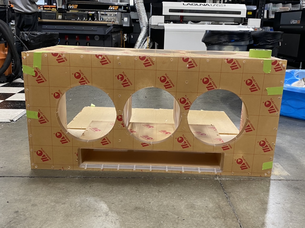

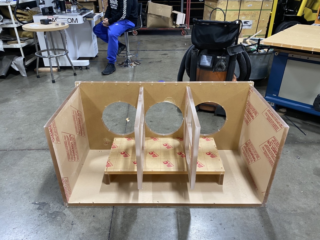

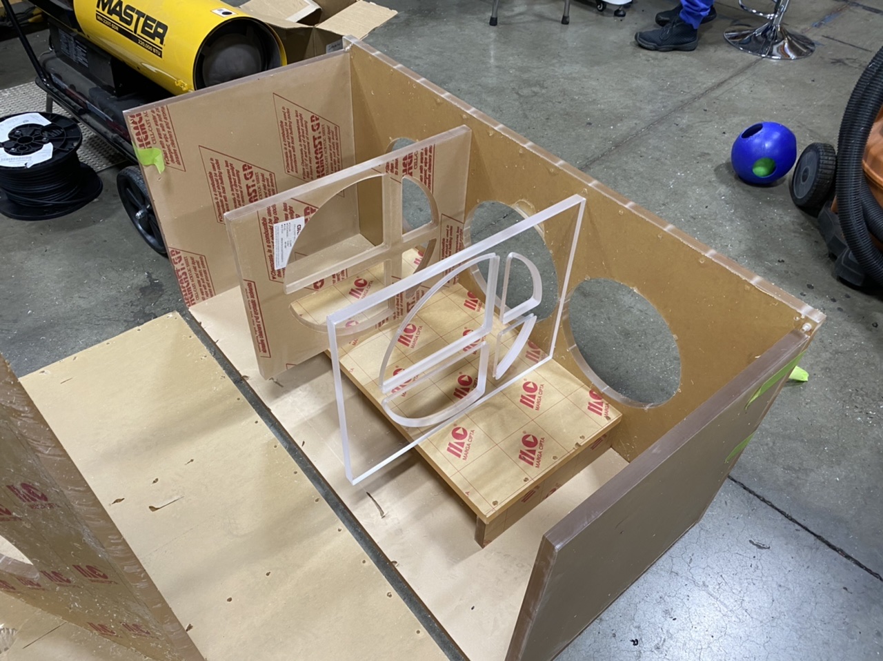

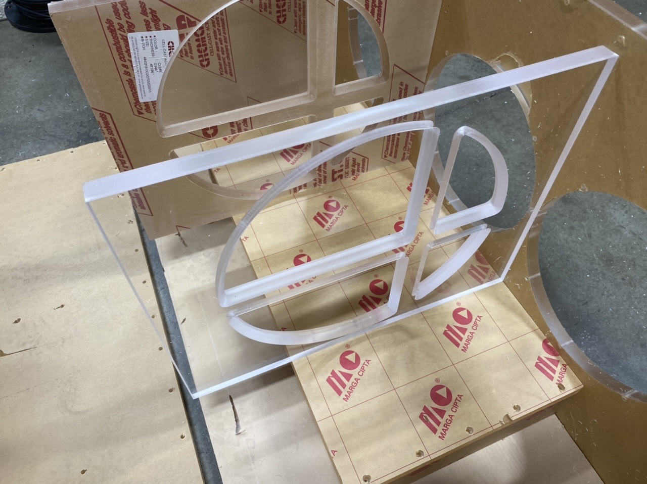

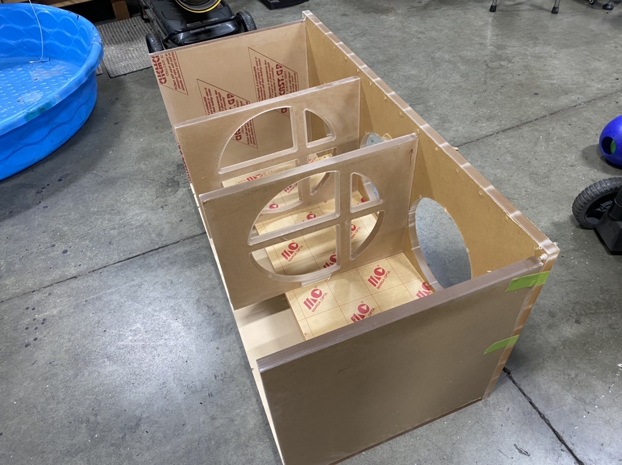

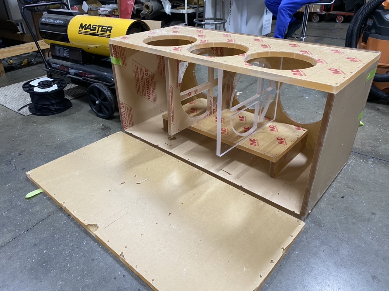

6 12’s for the caddy - 1” Clear Acrylic box CNC cut (sneak peak) check out the progress!

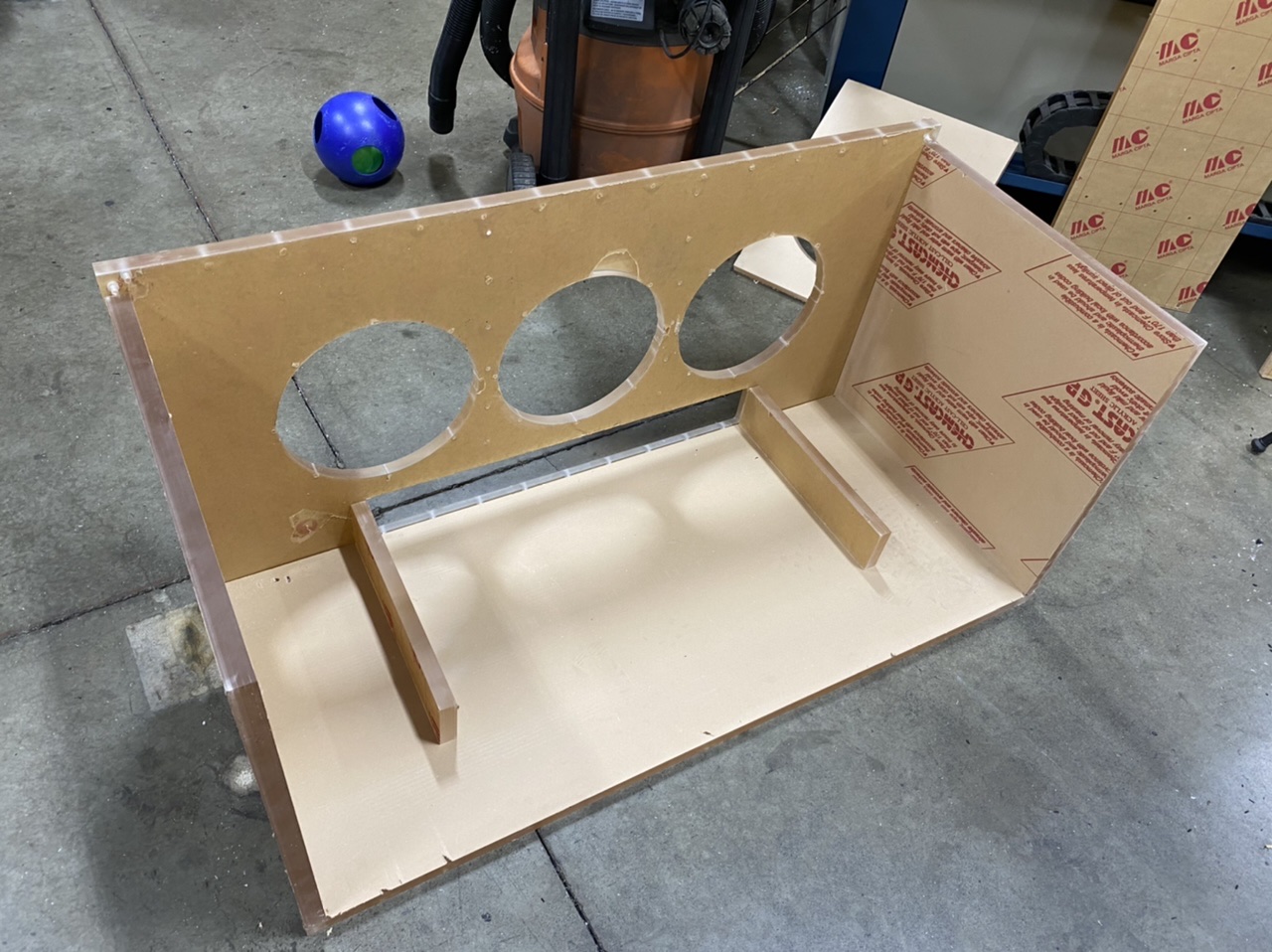

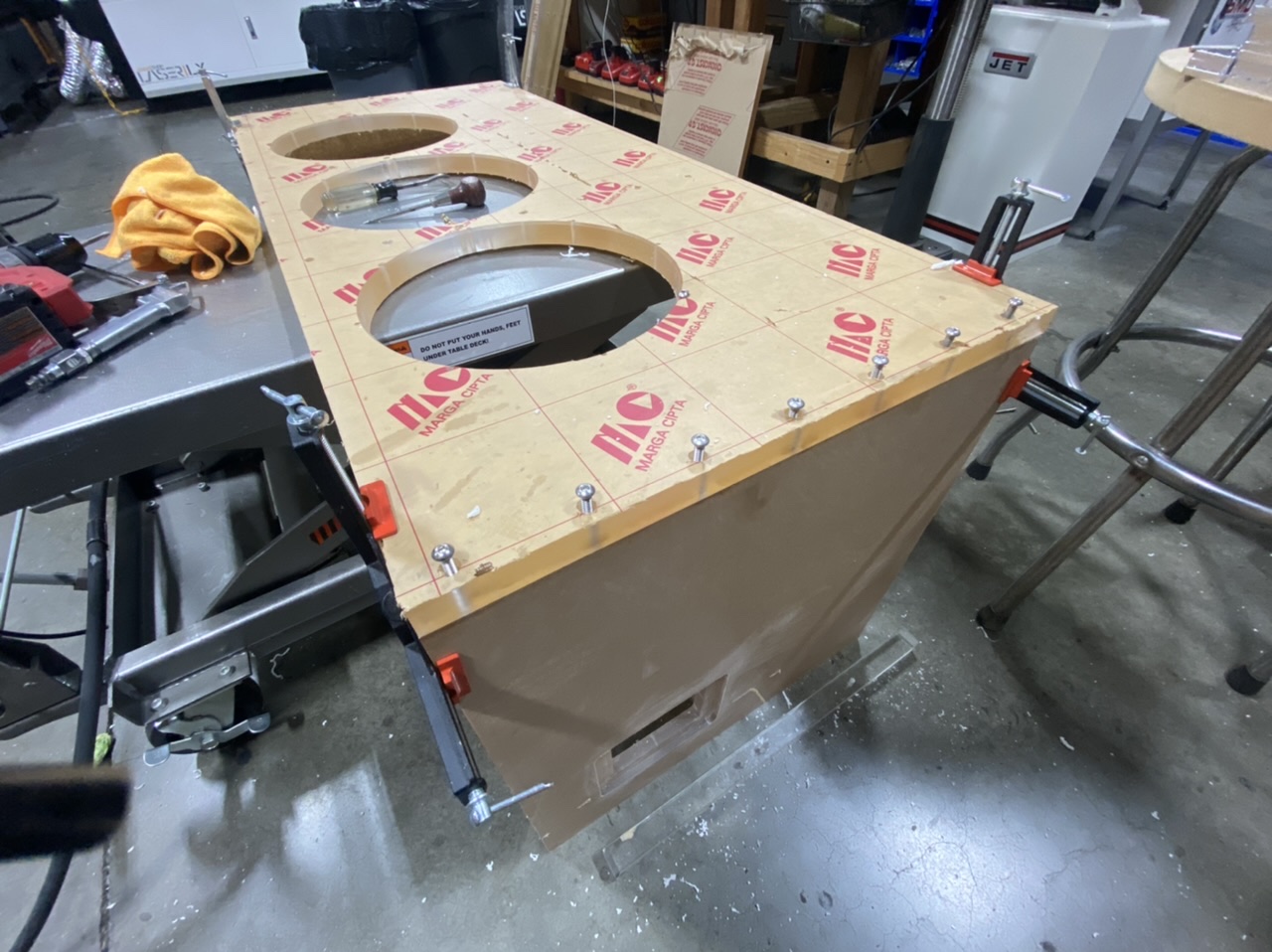

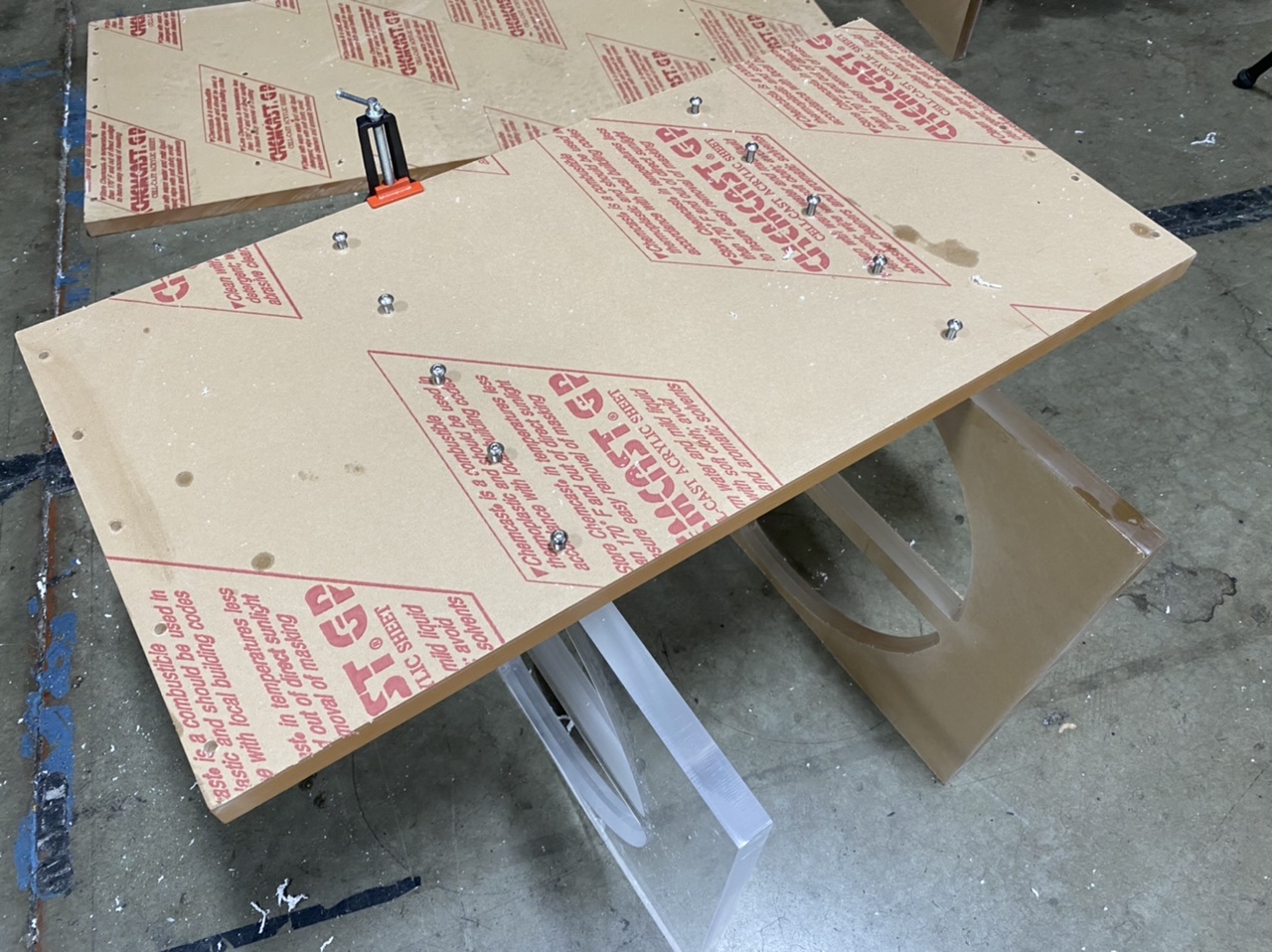

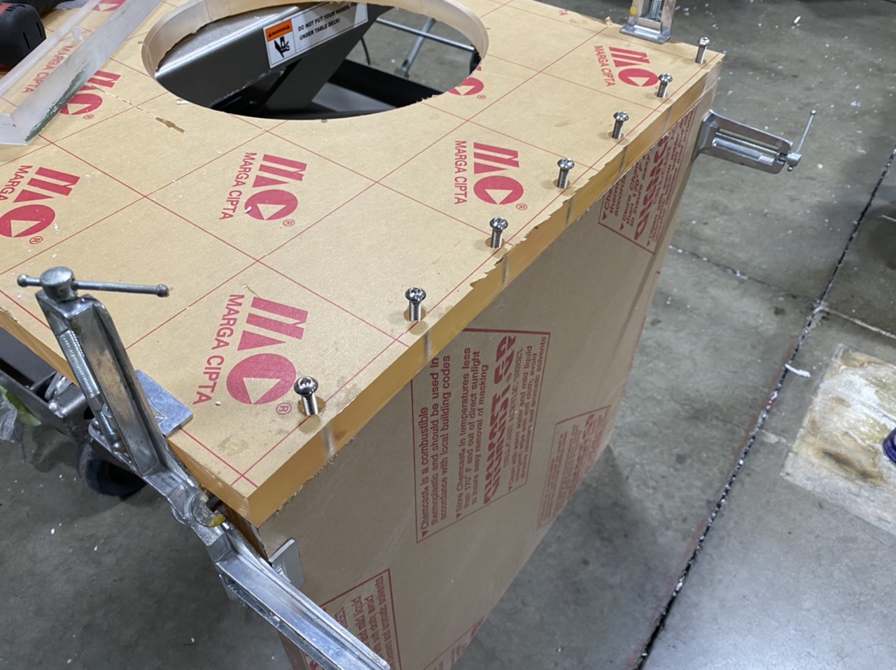

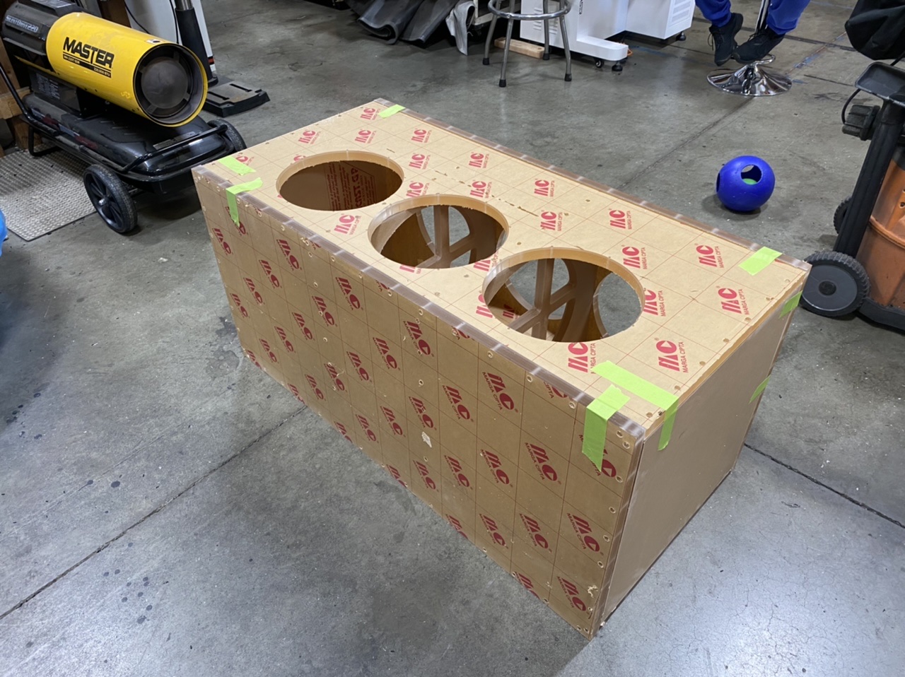

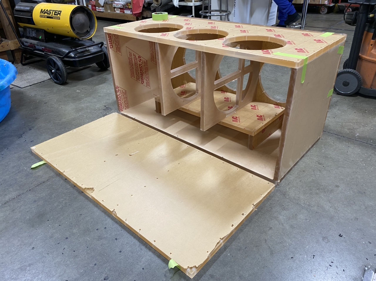

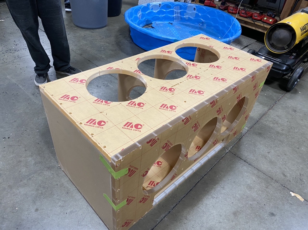

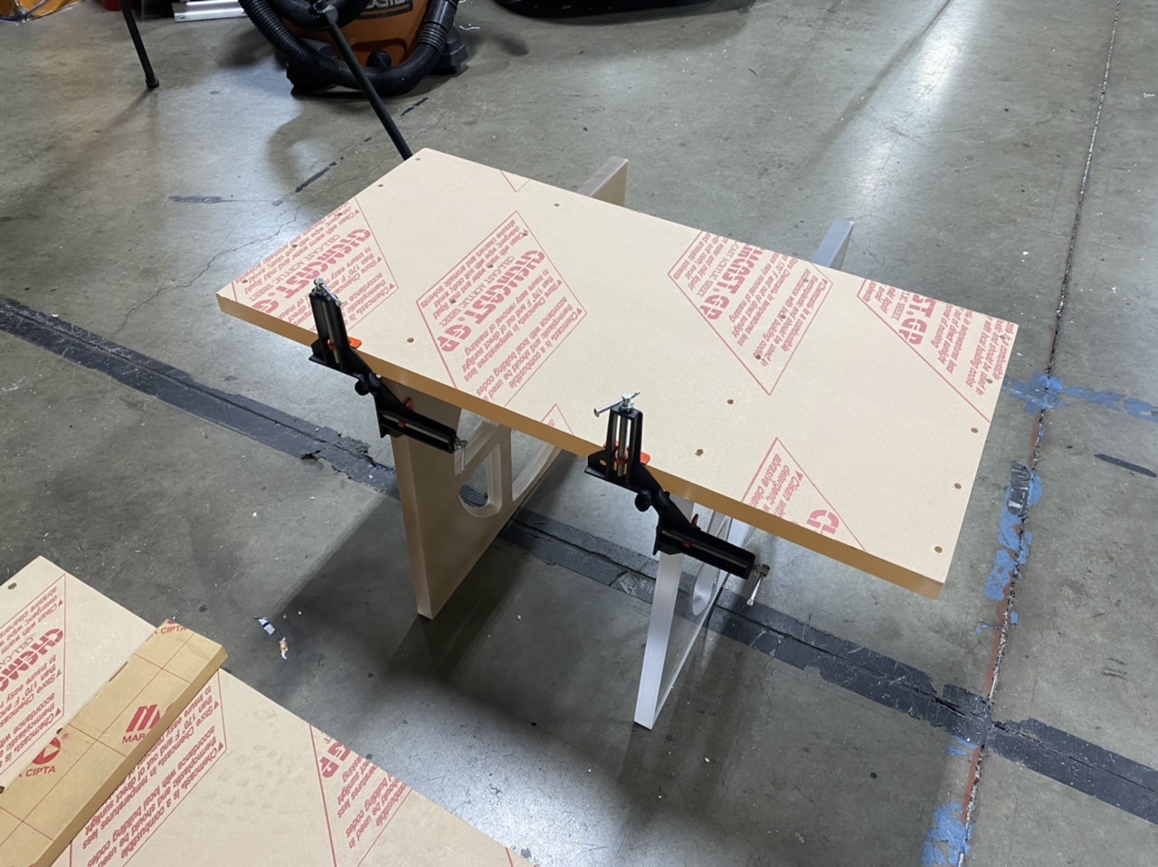

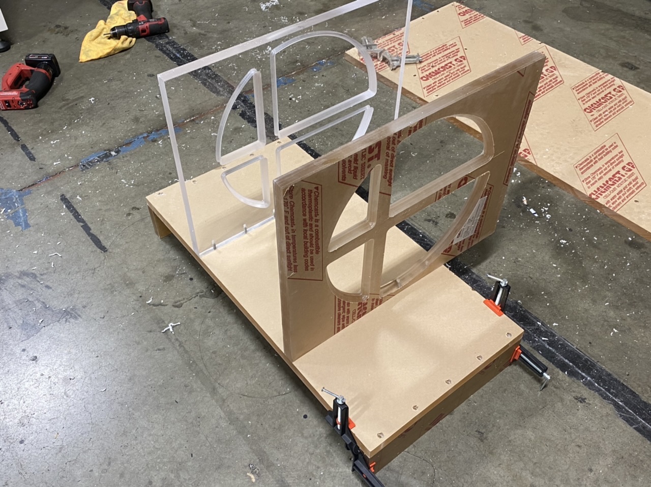

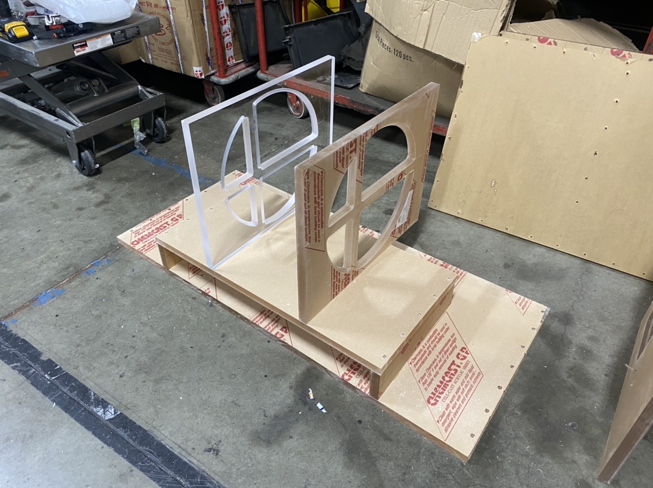

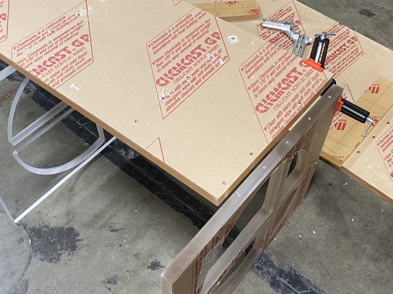

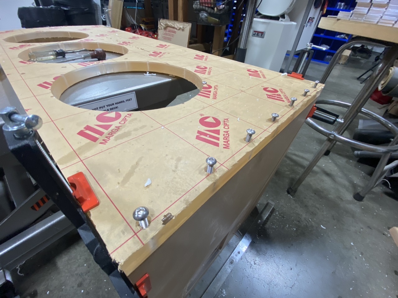

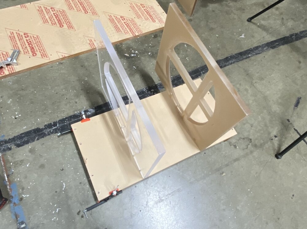

1/4” x 20 Stainless Steel button head allen bolts tapped into the 1” acrylic. Not actually bonded yet i have to do all the drilling and tapping first. Then i will clean the edges and join them together for good.
