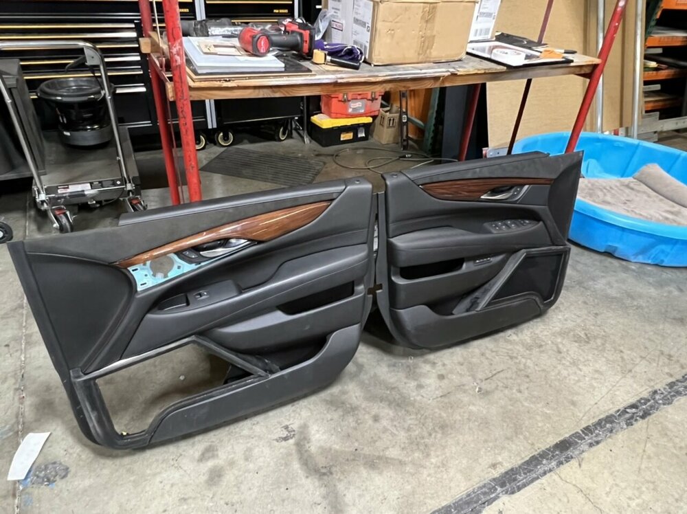

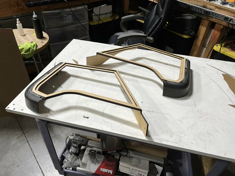

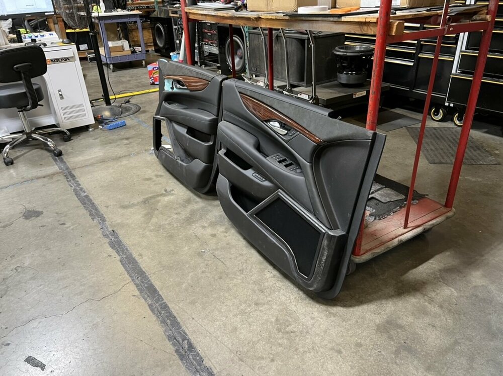

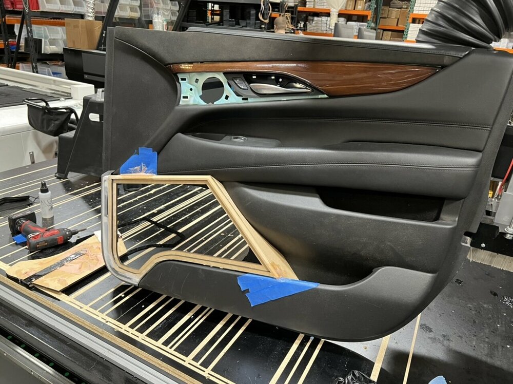

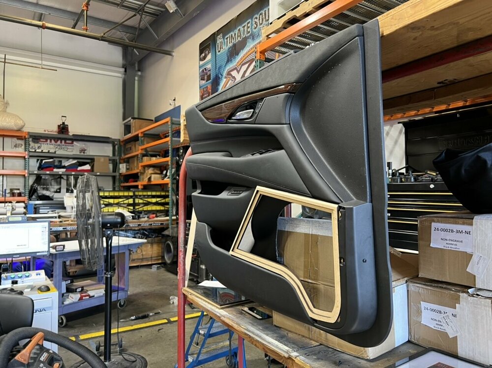

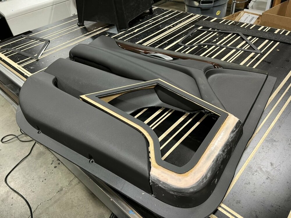

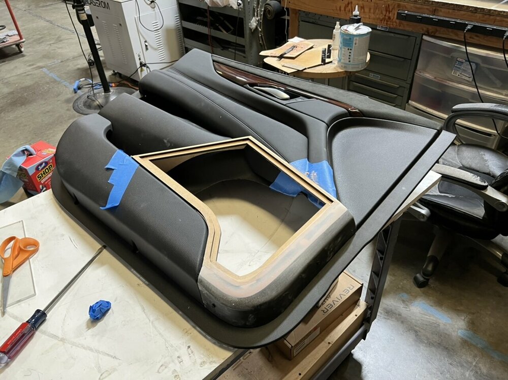

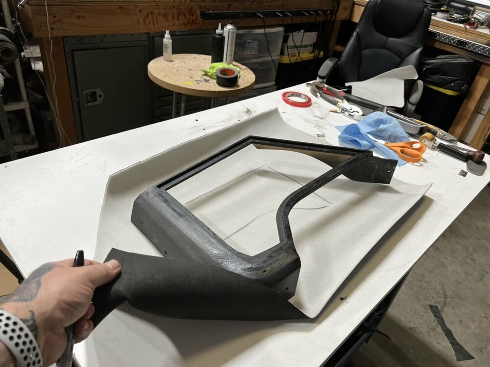

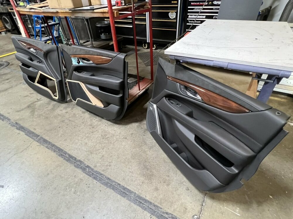

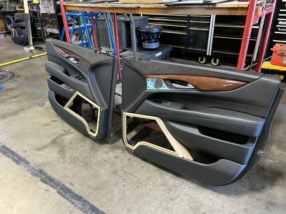

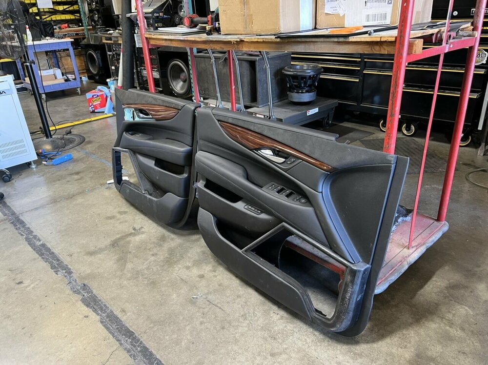

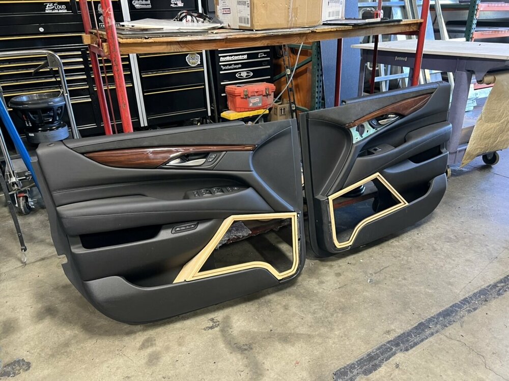

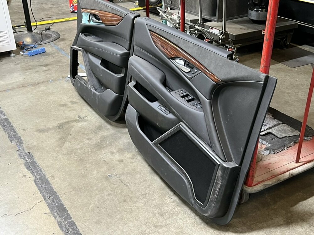

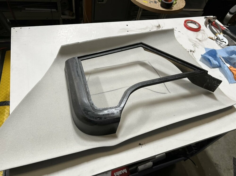

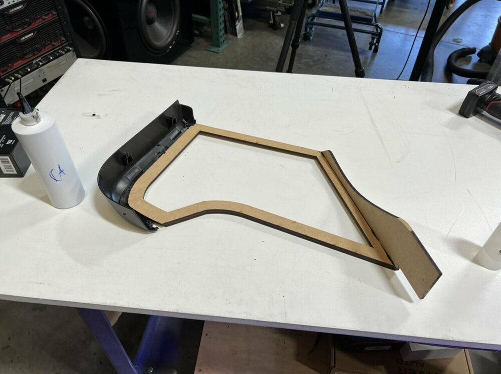

time to start tying in these pieces that were dissected from the panel

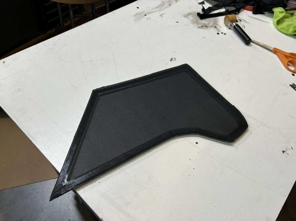

*SCREEN SUBJECT TO CHANGE i am still experimenting with what i want to do.

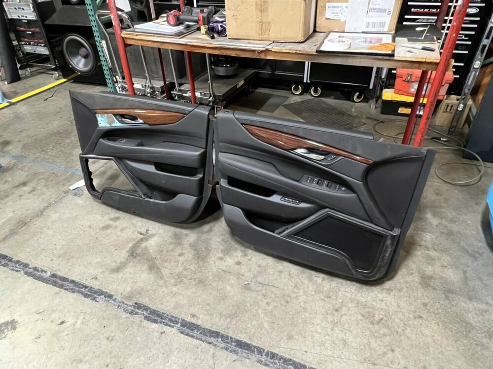

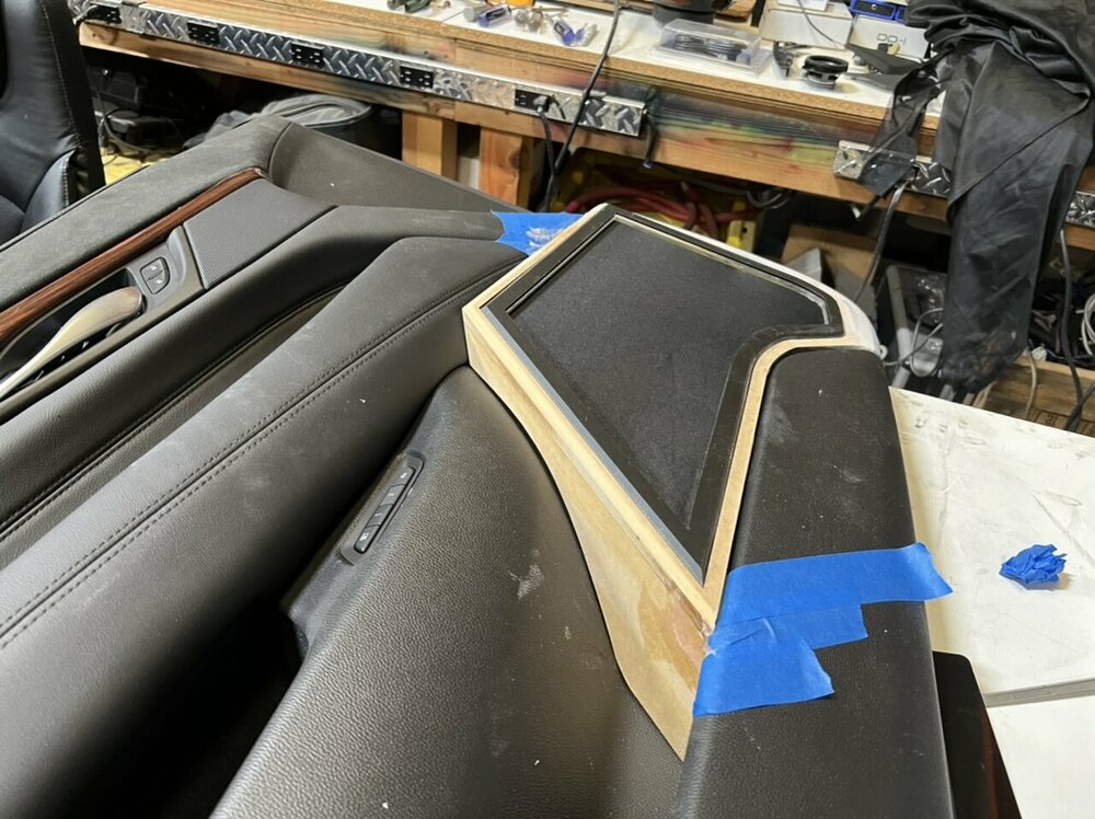

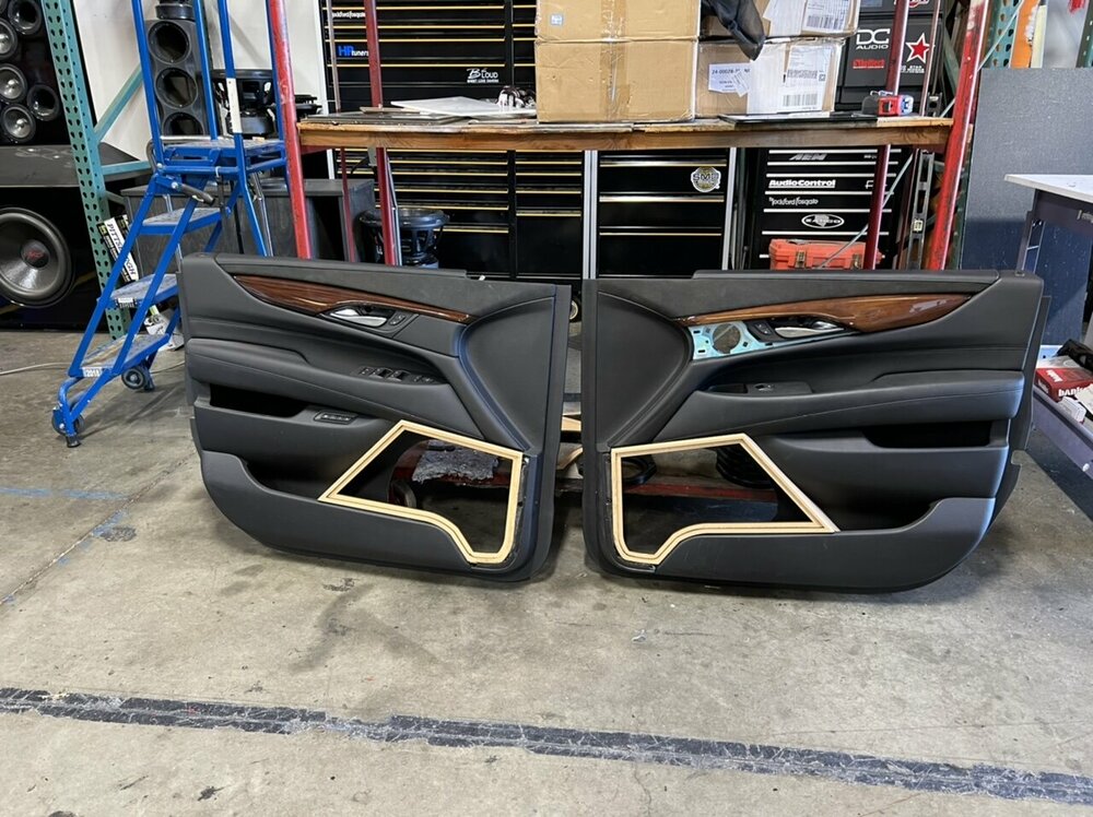

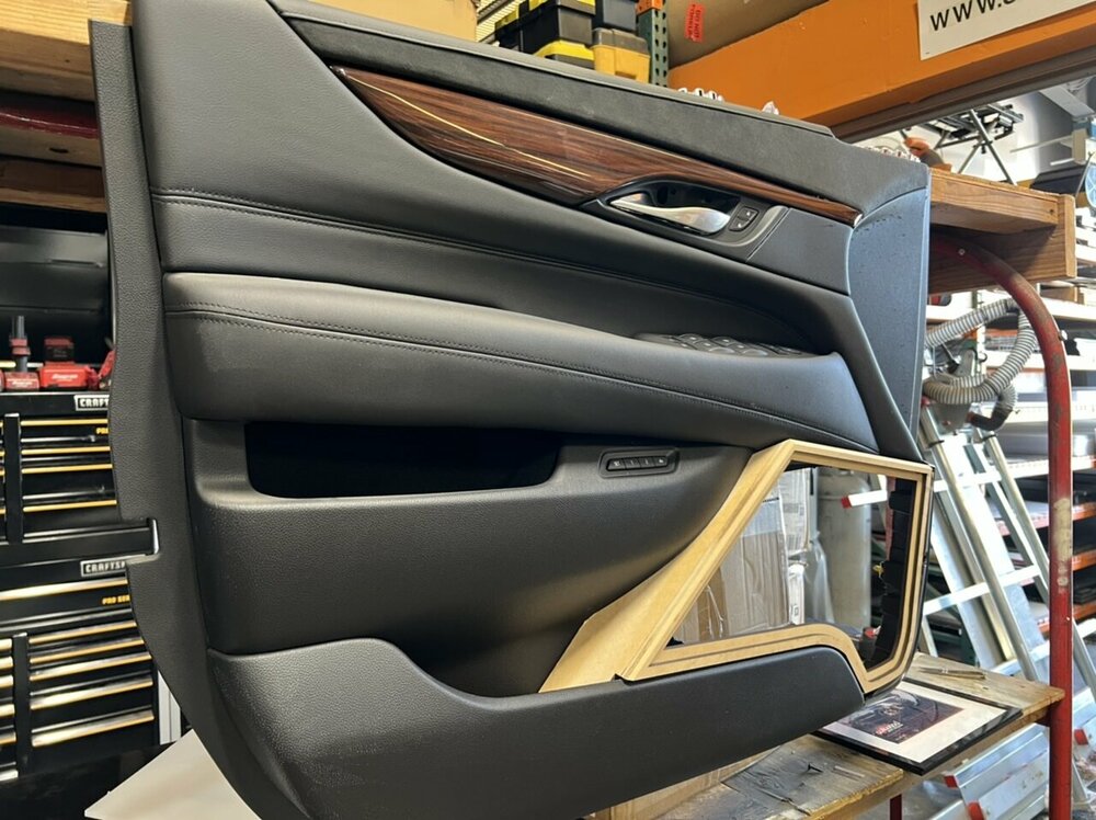

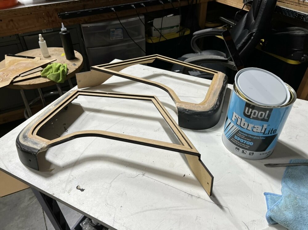

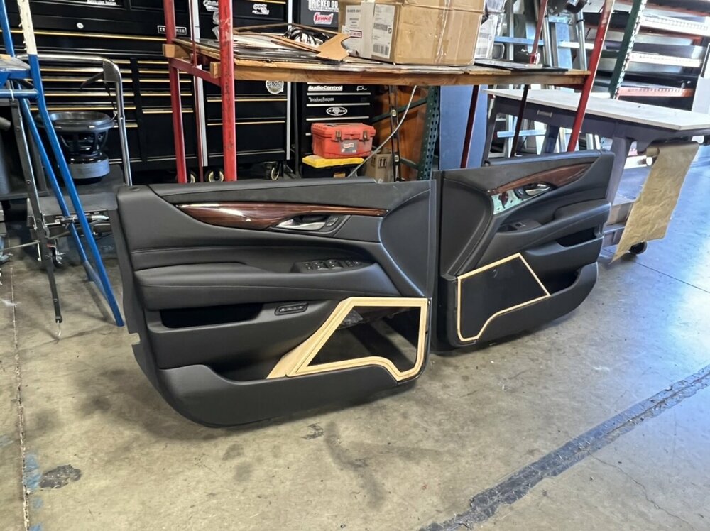

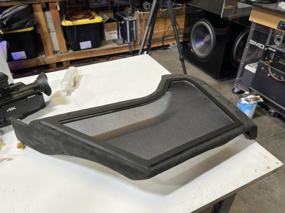

a little bit of kitty hair, some sanding and it is starting to become one!
i rattle canned them black so i can see how they will look NOT wood.  Then i sanded some more.  As of right now they are still ugly but starting to take shape,  If you squint and ignore my sand paper marks you might be able to envision my vision.
These will be wrapped in black suede to match the upper piece in the door panel.  Hopefully tomorrow.

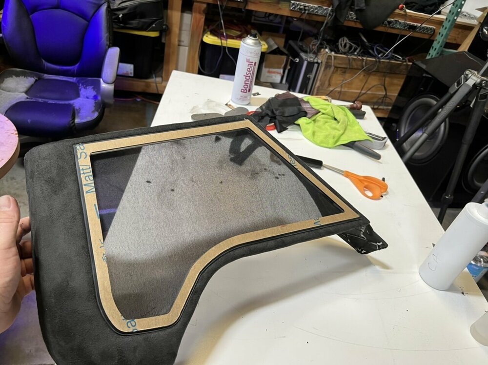

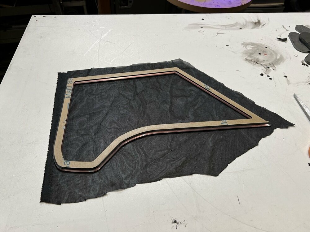

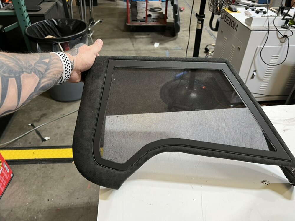

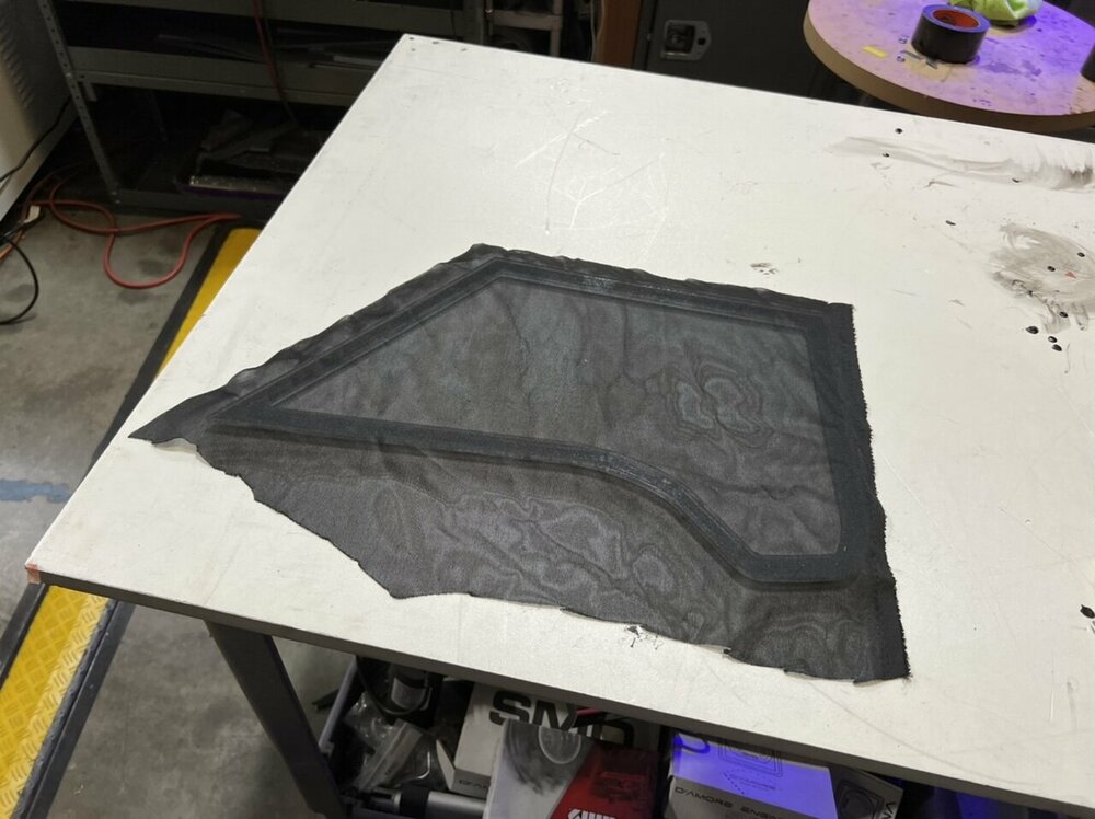

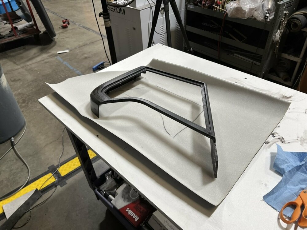

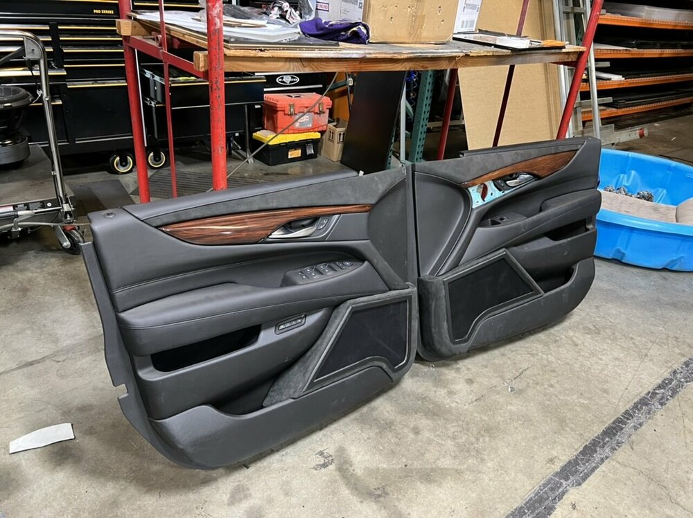

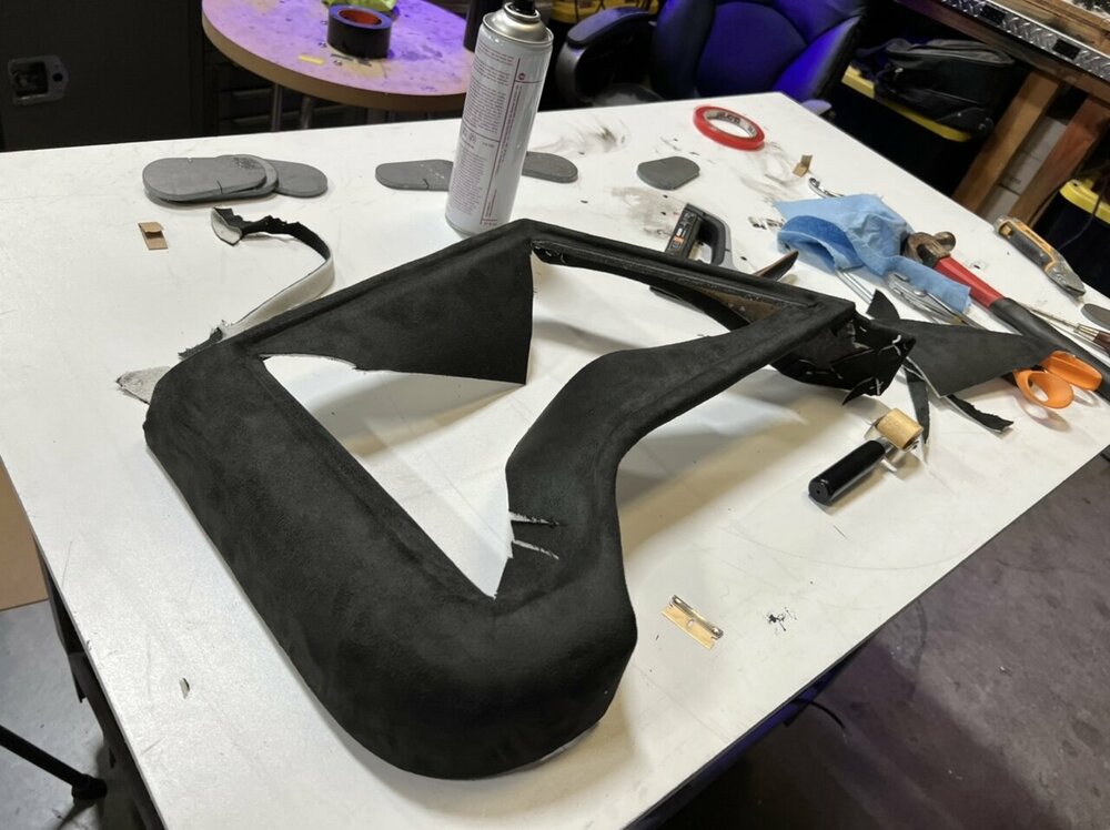

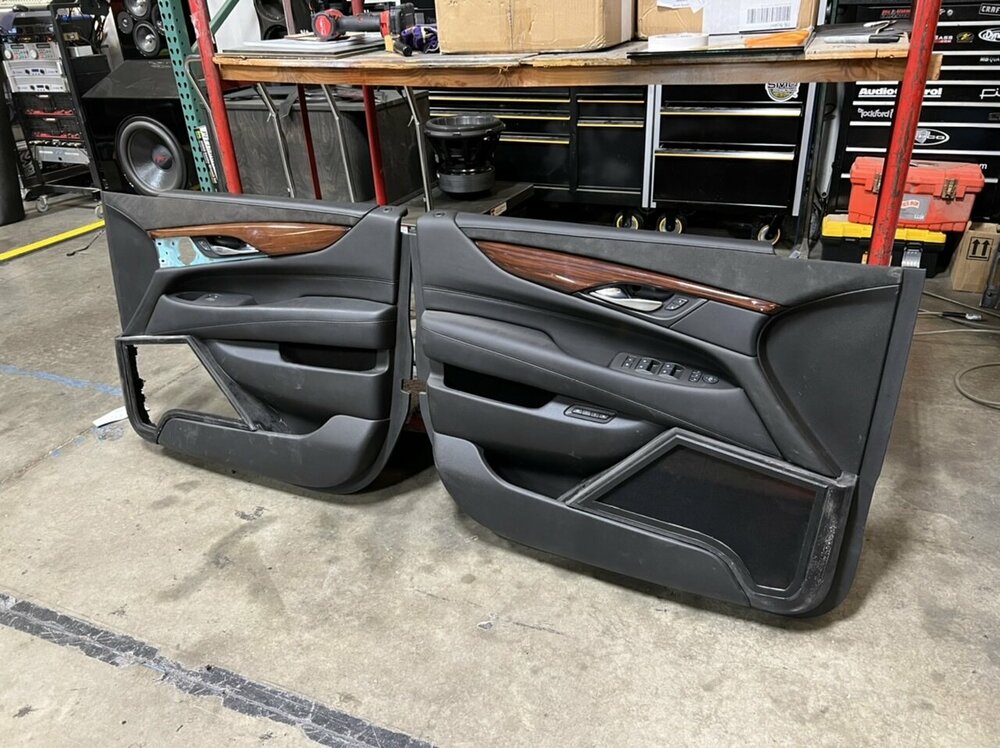

Time to wrap them in suede.

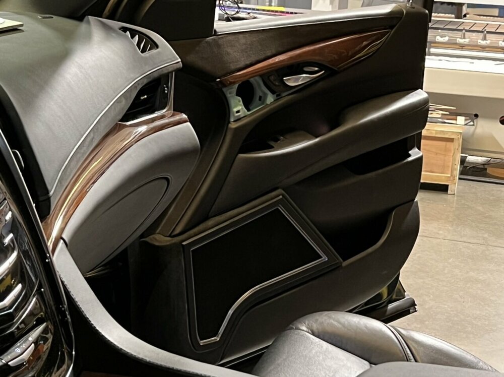

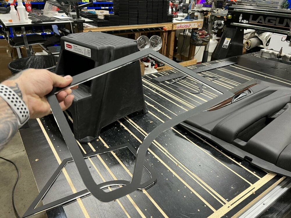

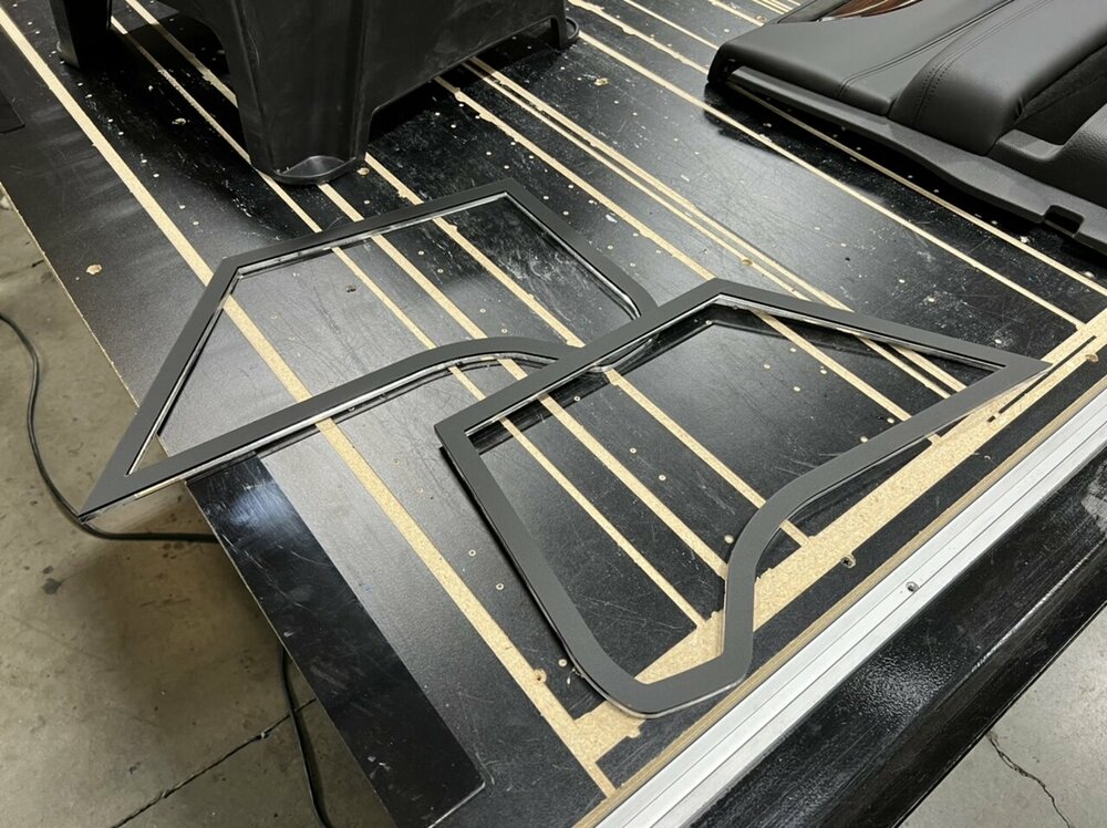

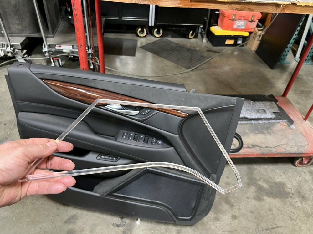

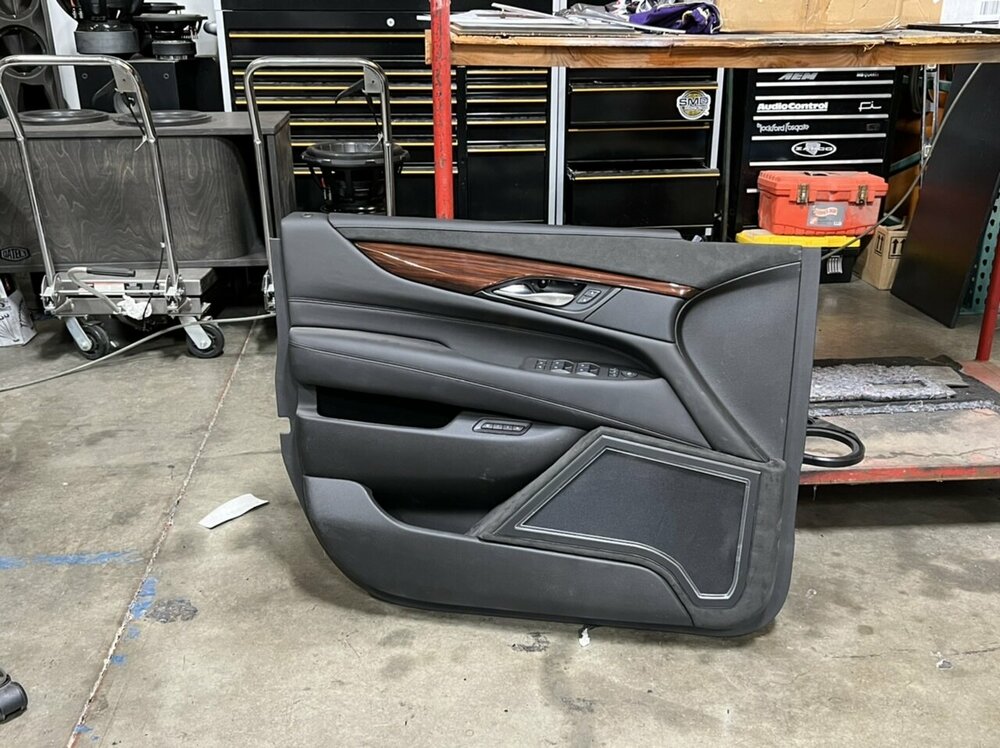

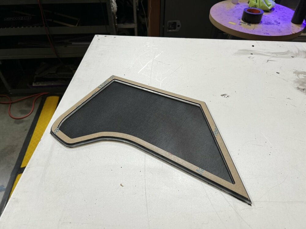

this screen frame is made of 1/4" clear acrylic with 1/8" matte black acrylic over the top.  I also beveled it.
Follow my Tweet (Twitter)
I love it! I think it is missing something though. So i added this clear acrylic trim piece just to see if i would like it there.  I think i will probably keep it and make it out of aluminum or stainless.  I think it breaks it up nicely.

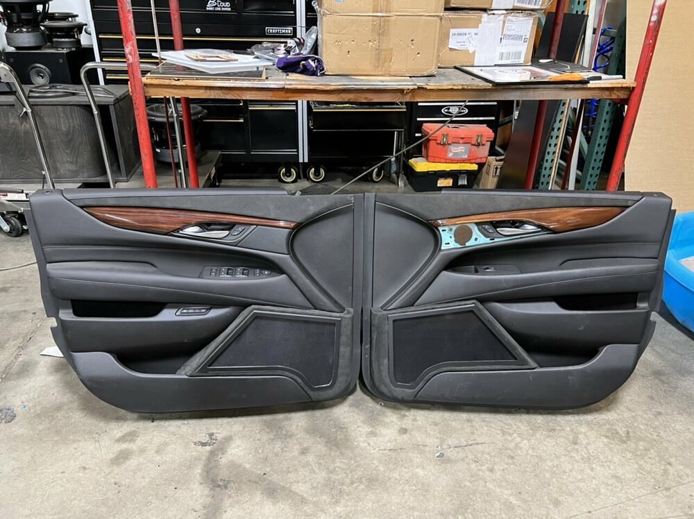

do it man i got faith in you! i just laid down the blueprint for you in those pics....:)
