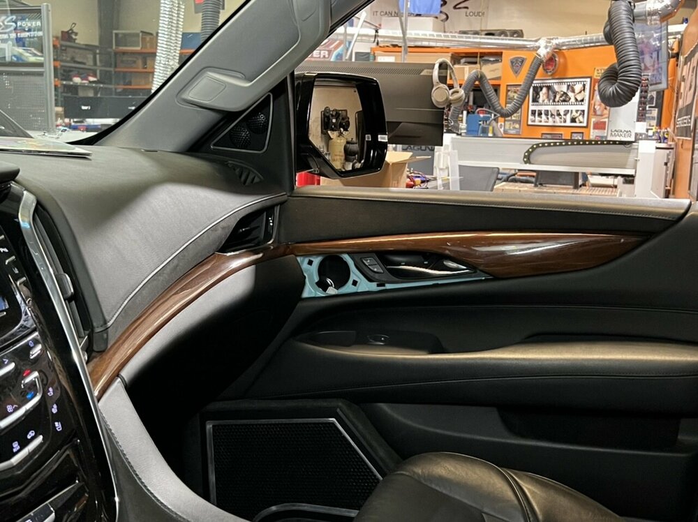

DAmn I am jelly of the skills. Great work as usual, good sir.
I know what the doors are missing. The SMD touch; Small SMD emblem! lol, but man, I love that clean, stock look. I do that type of stuff and it looks like non-stock, and porous like Illinois roads.

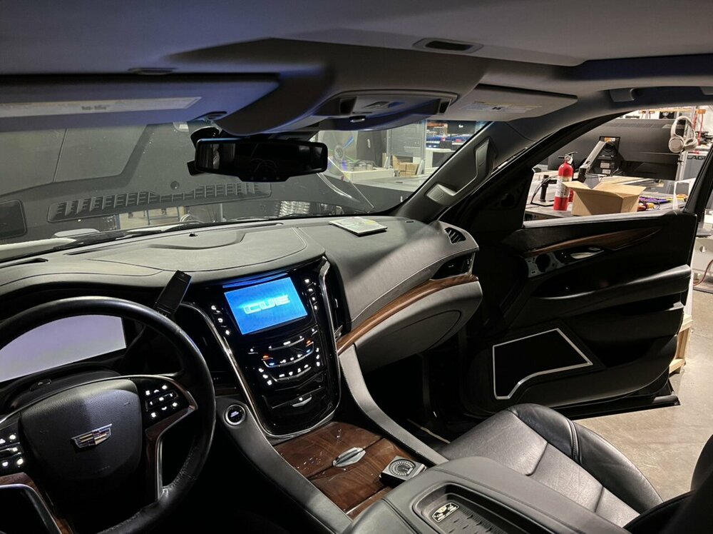

oh it's gonna get a small emblem...either Cadillac, SMD or B2 i haven't decided....thanks my bro! :)

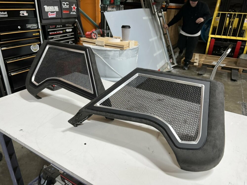

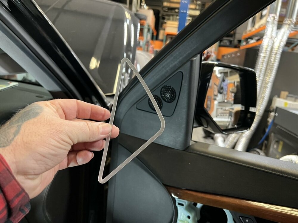

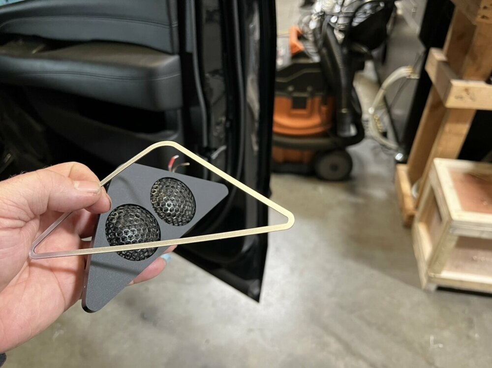

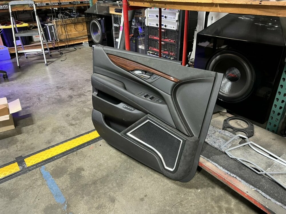

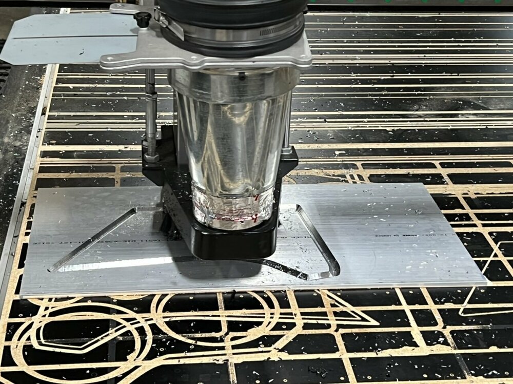

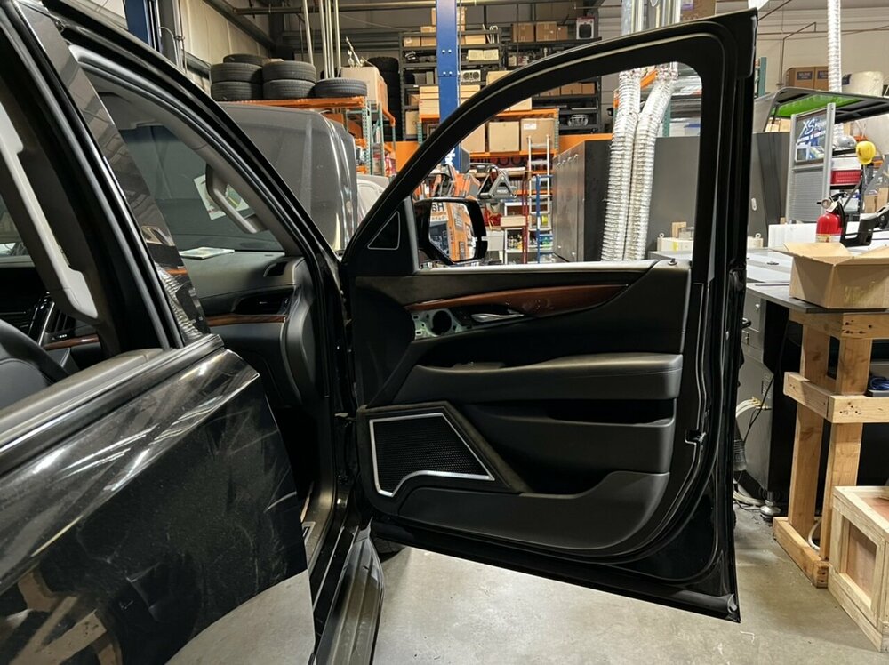

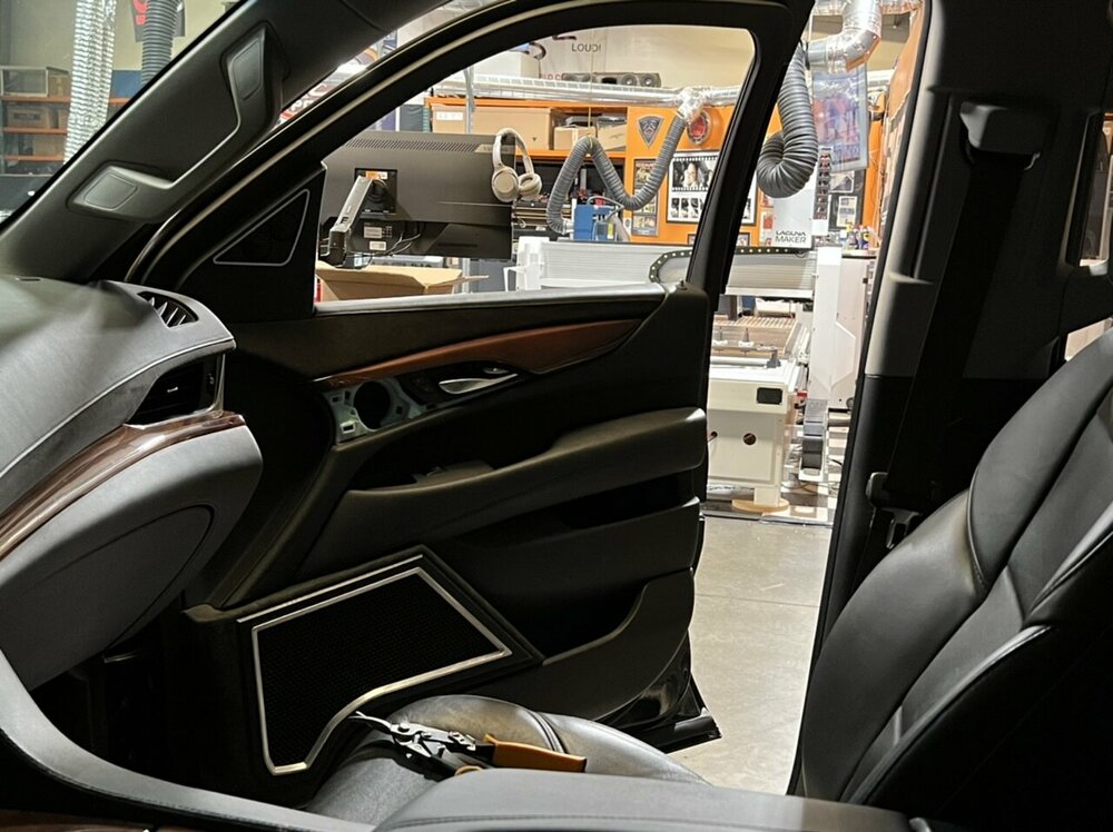

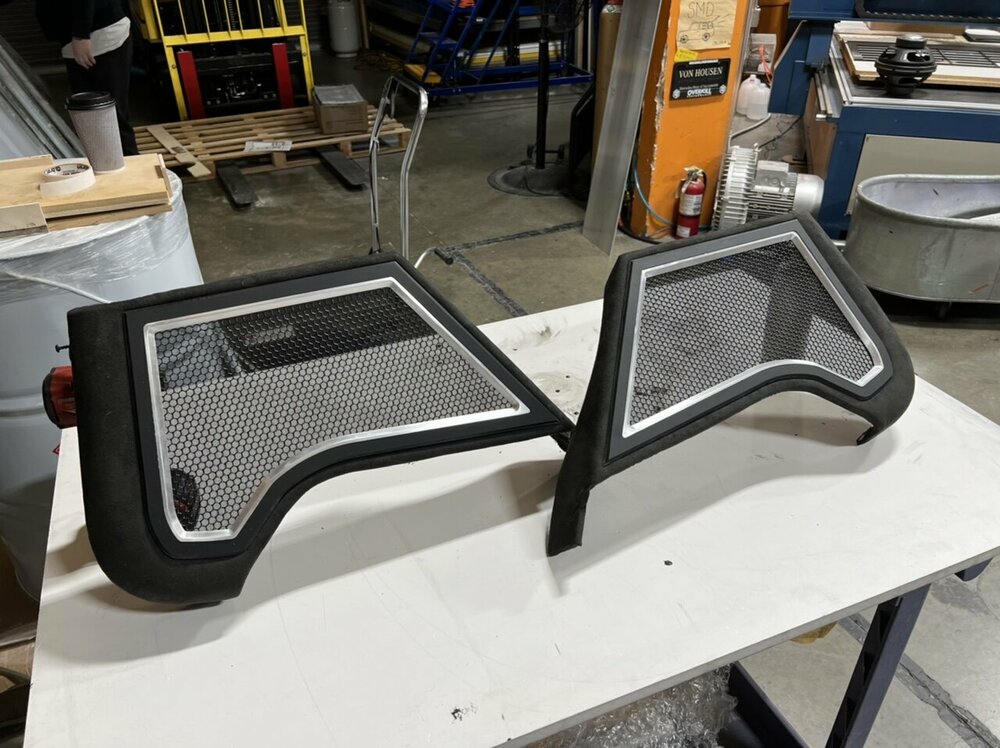

At first, i made this trim ring out of acrylic.  Then out of ABS (and painted it). But i wasn't happy.  It looked nice, but it was just not blowing me away.  So i scored a slab of 1/4" aluminum and made it out of that.  I like it MUCH MUCH better!
Follow my Tweet (Twitter)

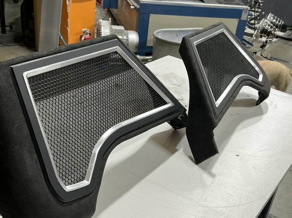

I think the aluminum looks much better as it matches the door handle.  The suede matches the top piece that is also suede.  It just looks like it belongs now IMO.  Maybe not Y.O., but IMO it does.  Next, i gotta finish the speaker pods that go behind the grills (see above pics) and pick a nice spot for the tweeters.  Then i can run wires and call this project complete.

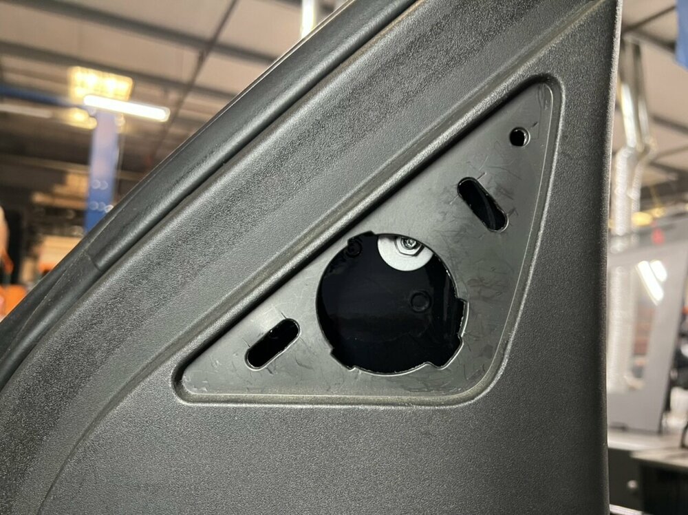

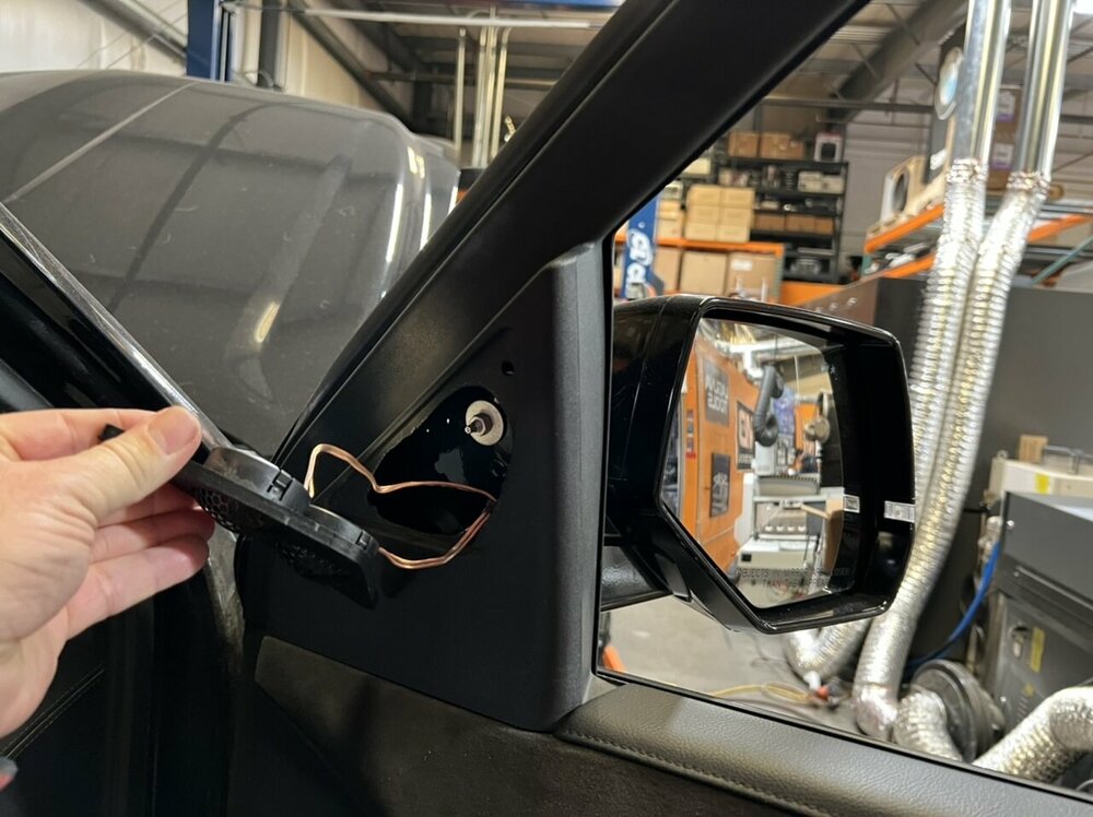

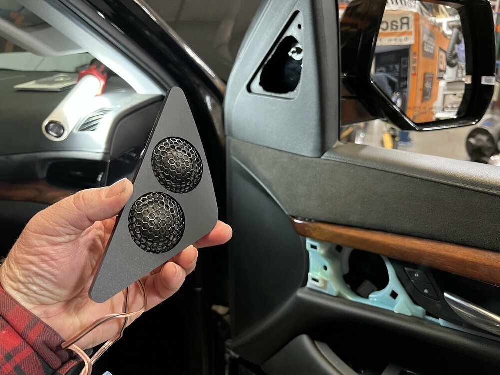

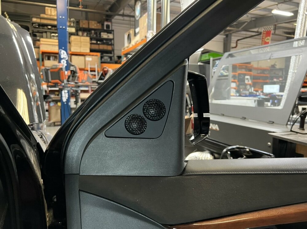

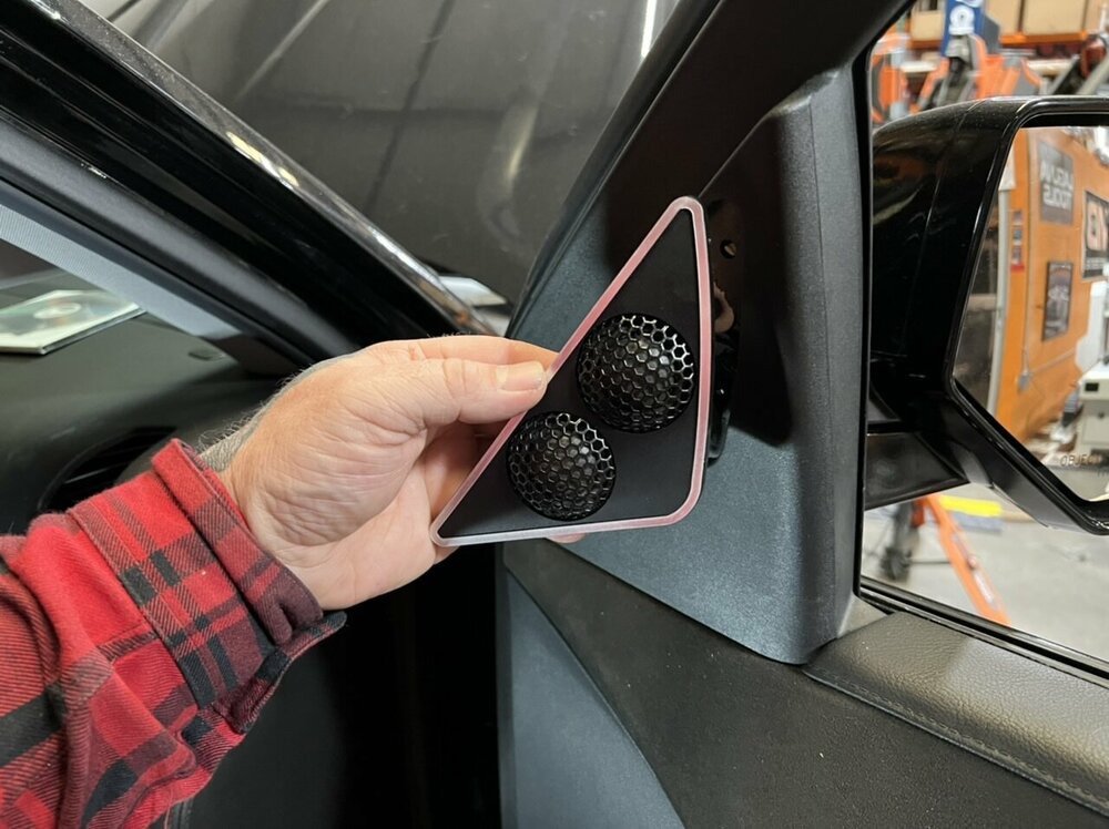

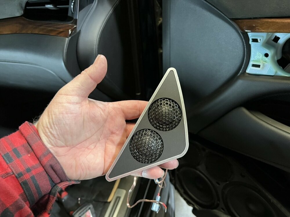

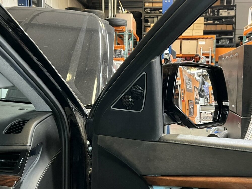

there used to be one factory tweeter in the sail panel. Now there is 2 B2 Tweeters in it. I used 2 pieces of 1/8" flat black acrylic offset to allow the tweeters to just barely poke through at the screens.

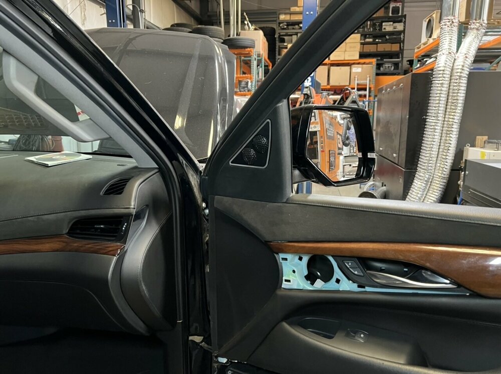

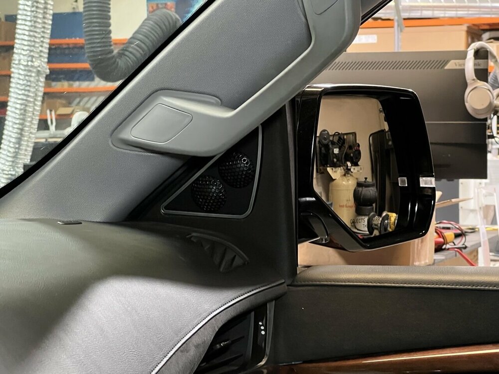

I actually really like it just the way it is (black on black), but i think it needs a little brushed aluminum trim piece to break it up a little.

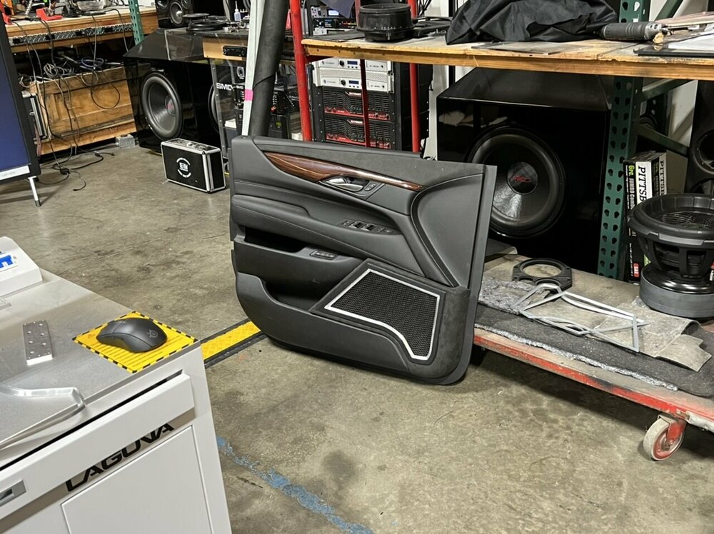

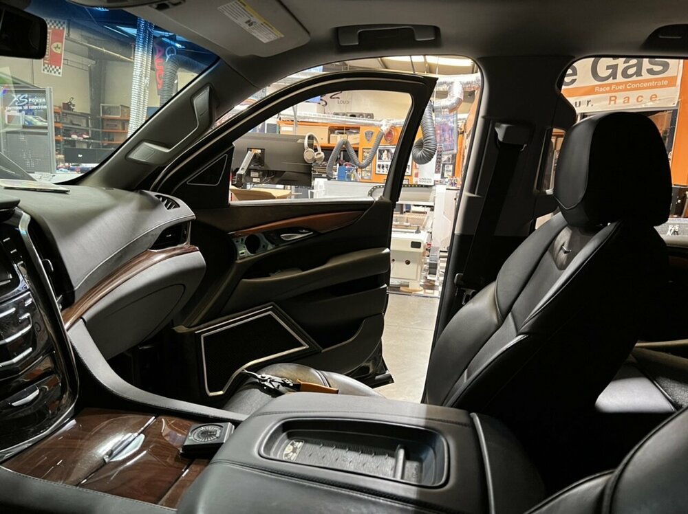

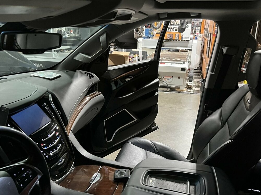

I think the top compliments the bottom pretty nicely and i love the placement!  Now it is time to do the driver side and FINALLY think about running the wires!
Dude, absolutely perfect. Fits right into a luxury vehicle. Top notch work. That aluminum really pulls out all together in my opinion. I'm sure it will sound as good as it looks.
