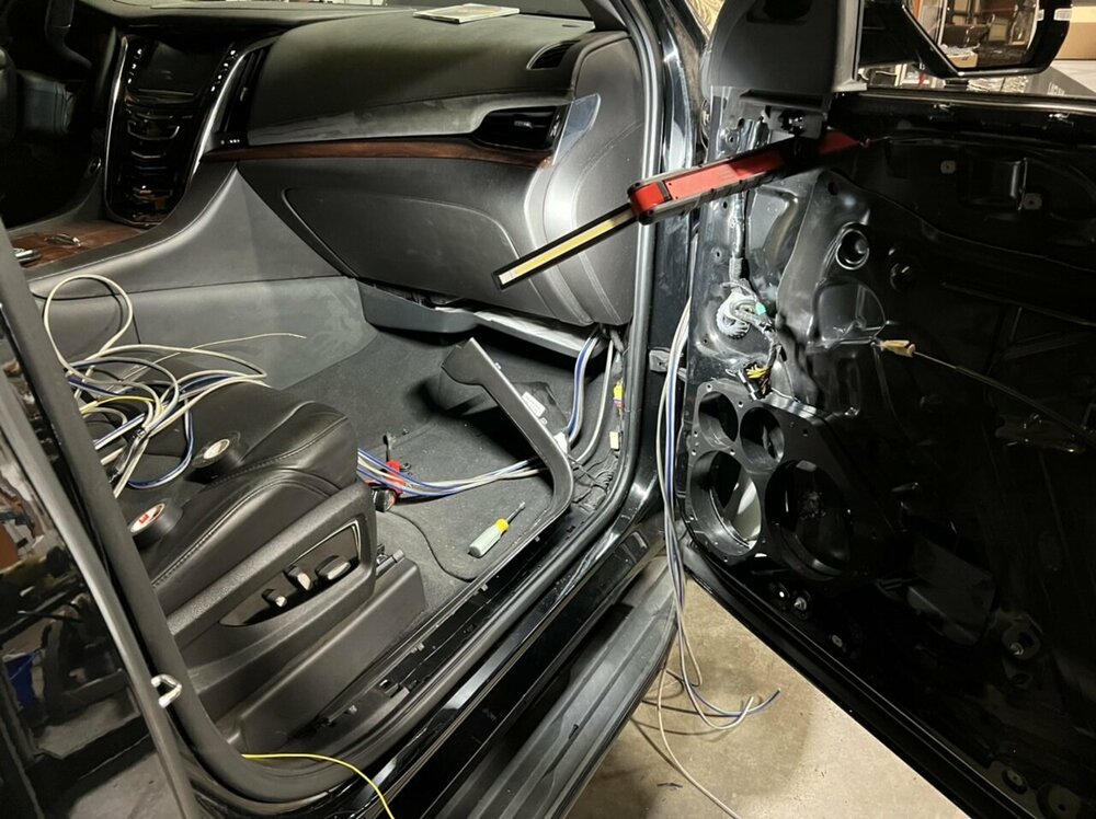

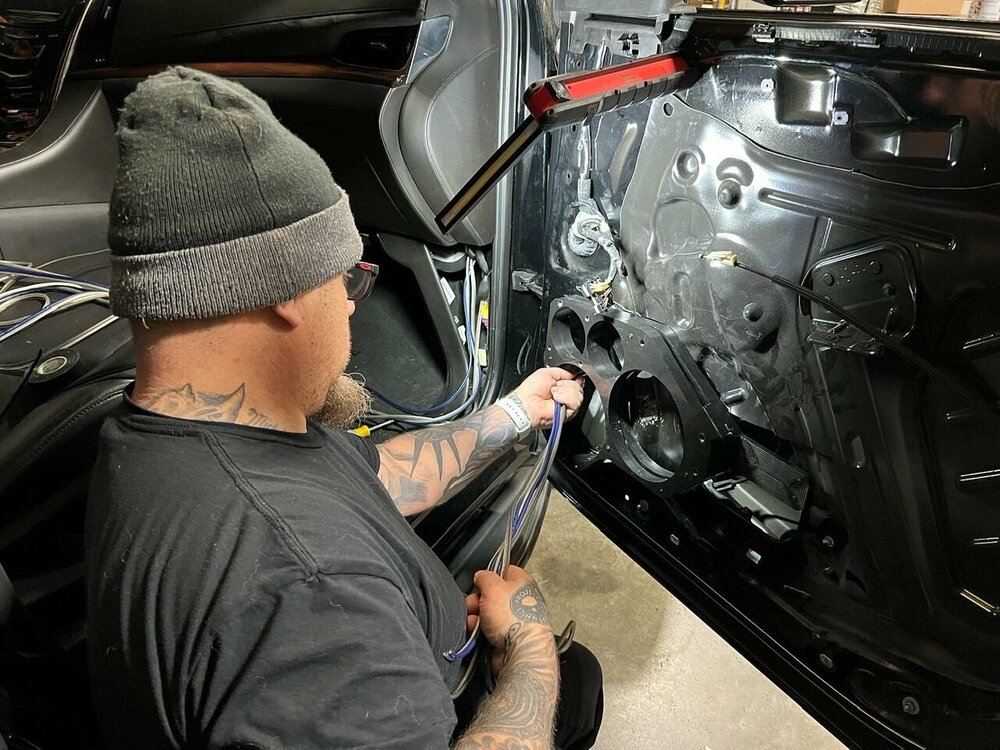

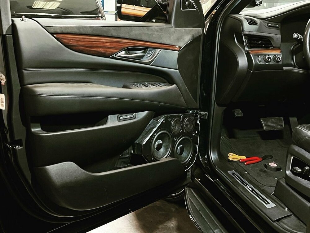

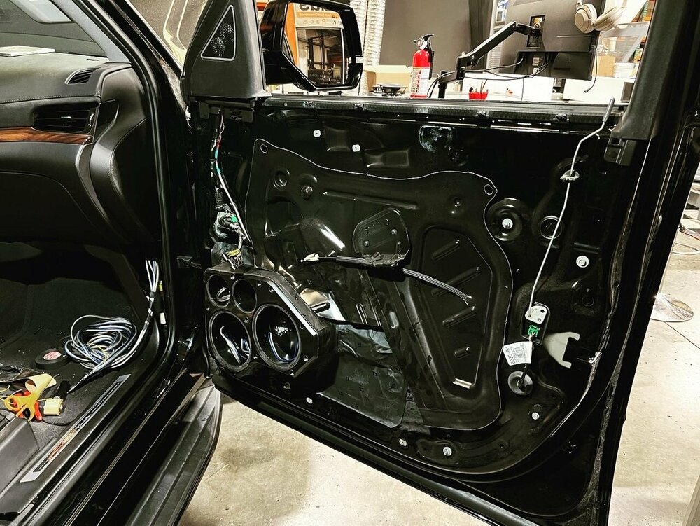

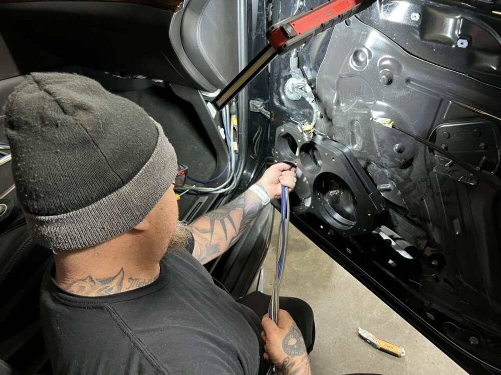

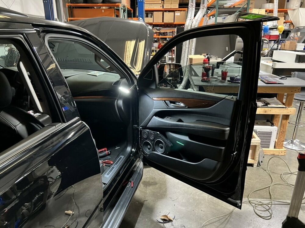

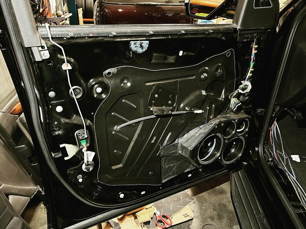

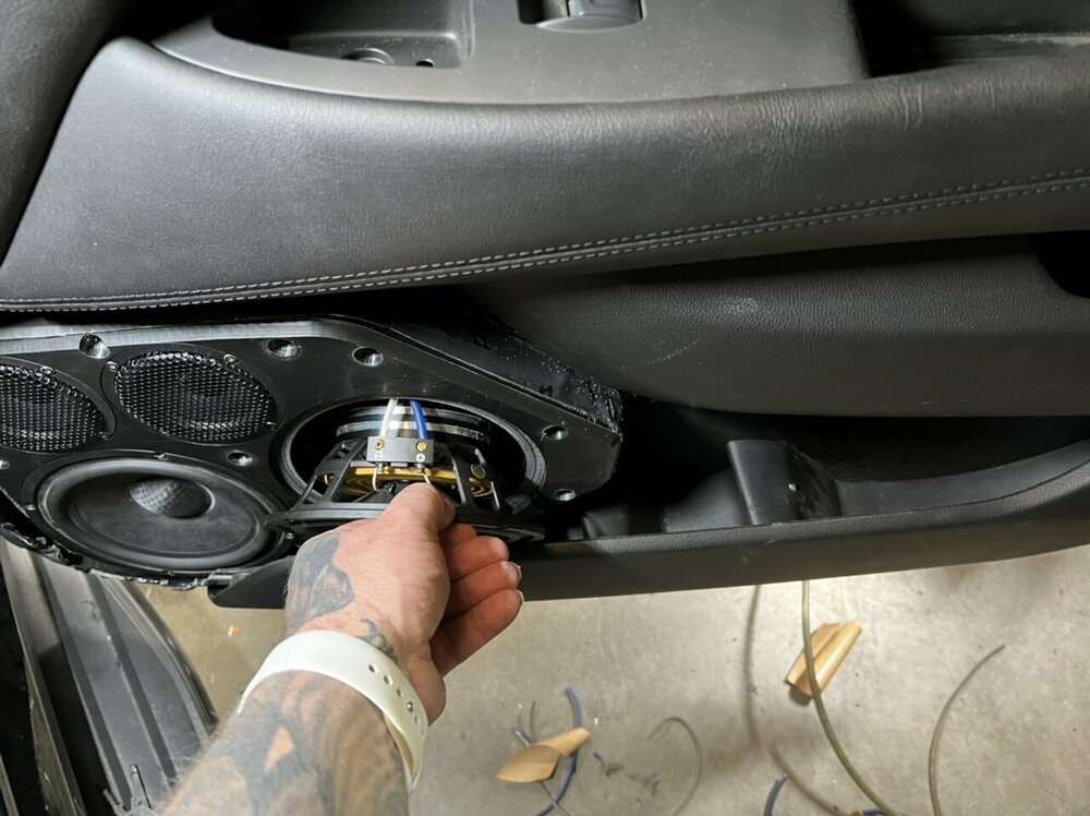

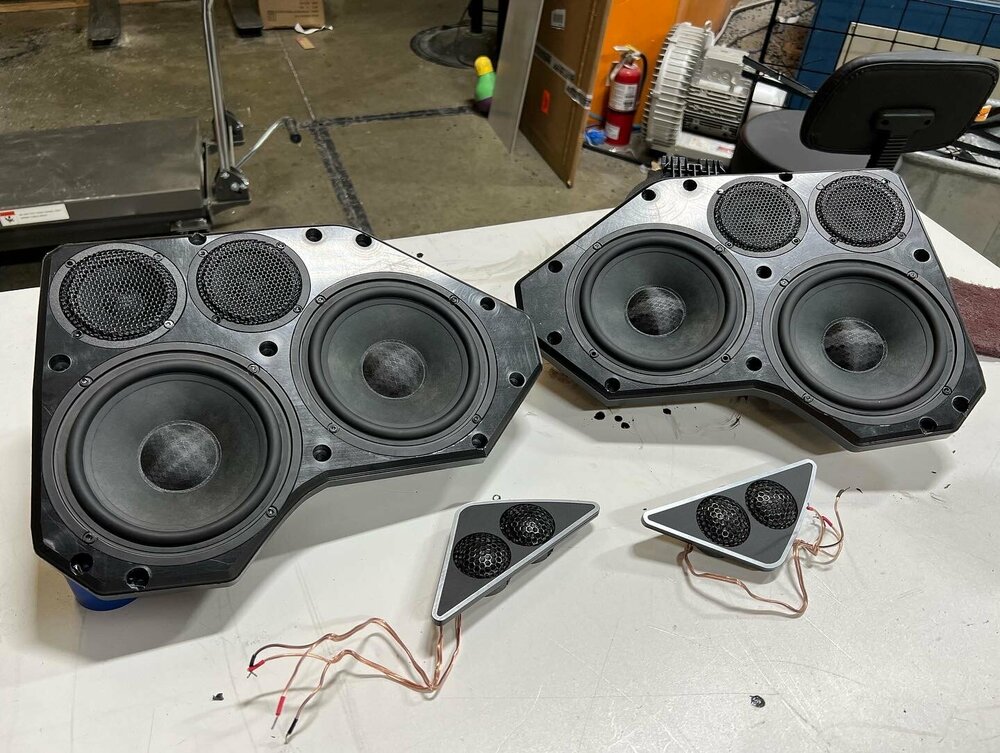

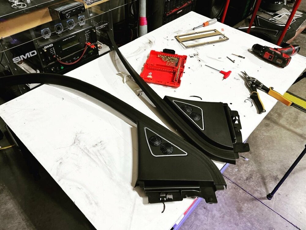

found my way in. 2 12ga skyhigh caraudio OFC for the 6.5’s and 2 16ga for the 3” mids and 1.5” tweeters. Each pod is made of 3 layers of 3/4” HDPE and bolted to the door. Ill get to hear them soon after i wire up the top layer (speakers already mounted). Getting close!

Those 3 ways look so good.

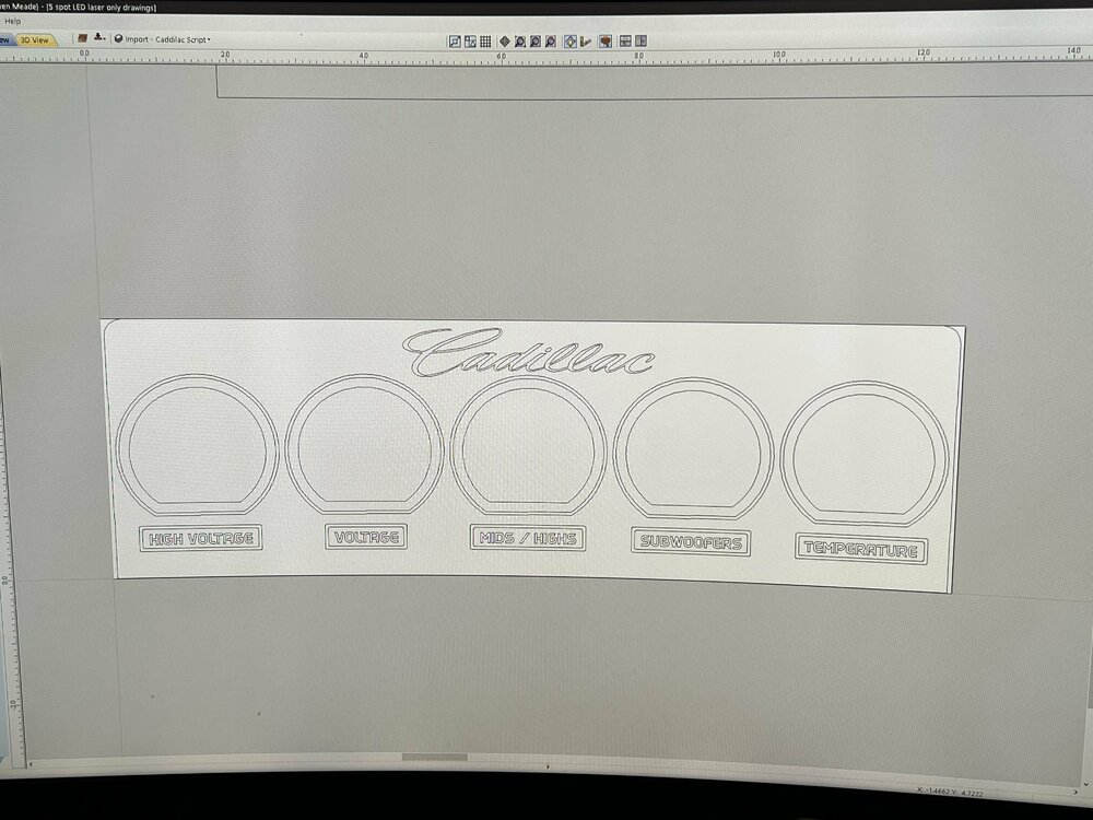

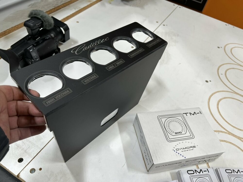

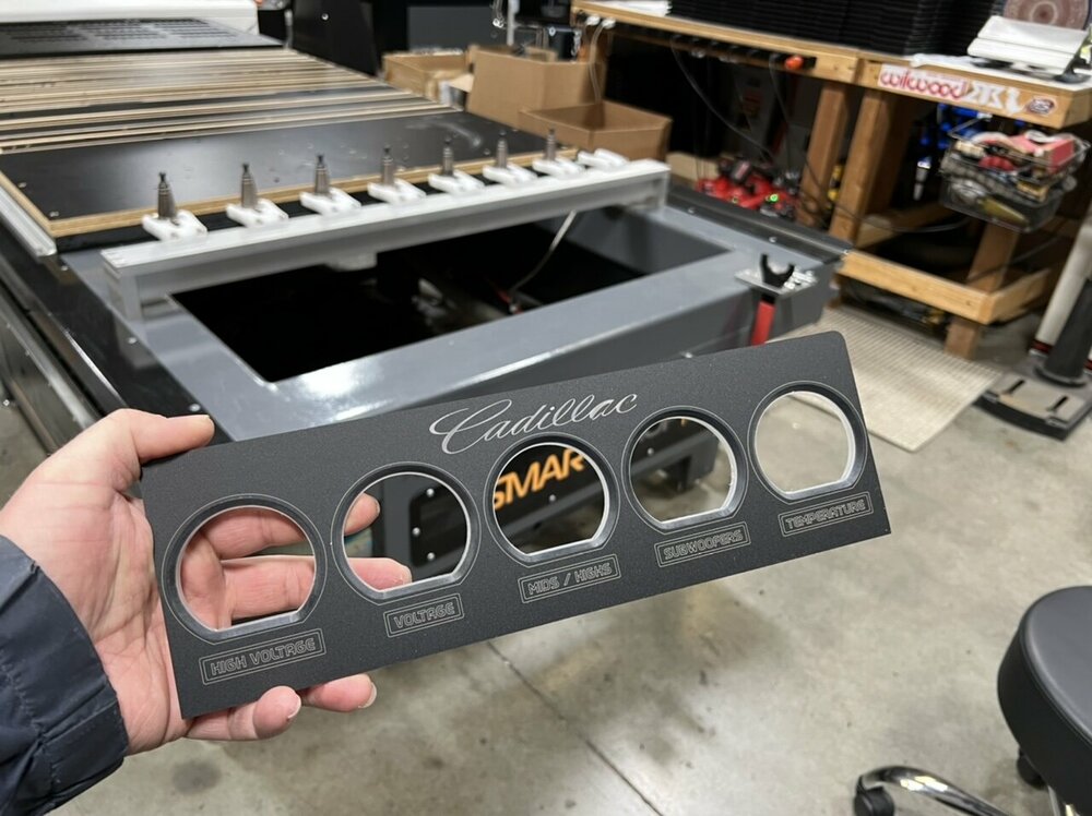

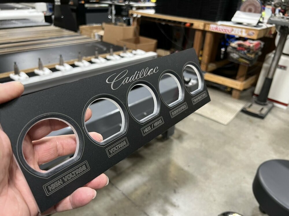

Pretty awesome watching those machines turn out what you get them to. Crazy departure from the days of watching you gnarl up your finger with the router making rings in the backyard, but results still just as sweet! Fun build to watch!!
