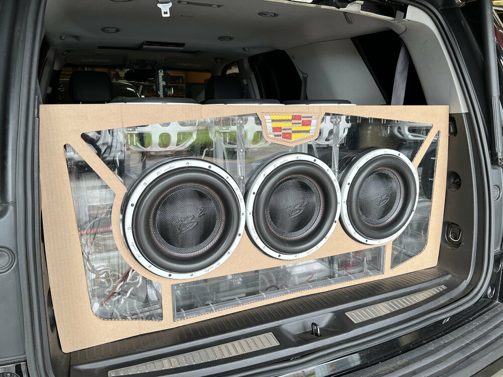

2 hours ago, meade916 said:
I can't wait to see that done. I wish my mind had style like that

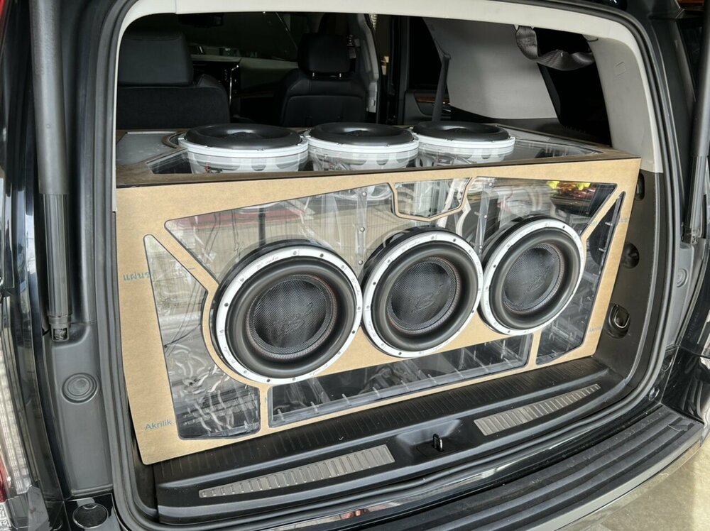

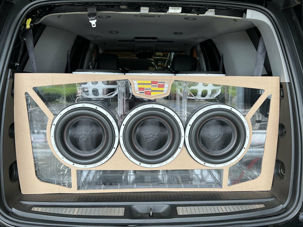

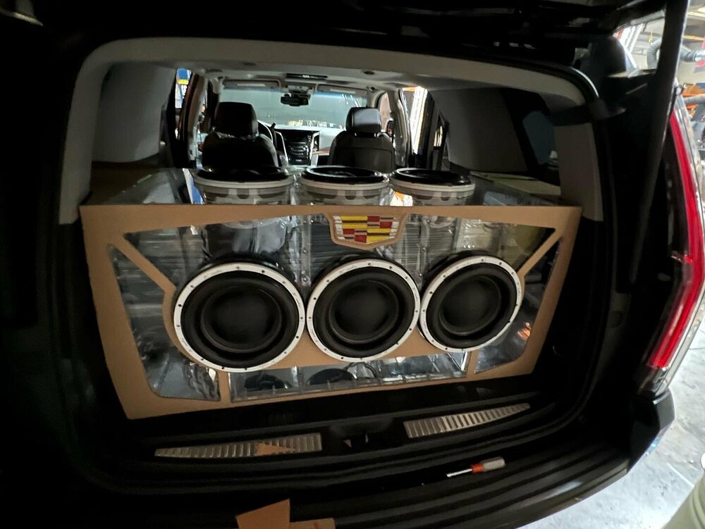

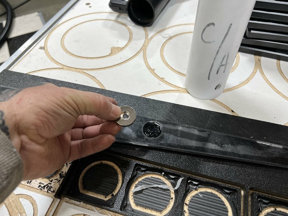

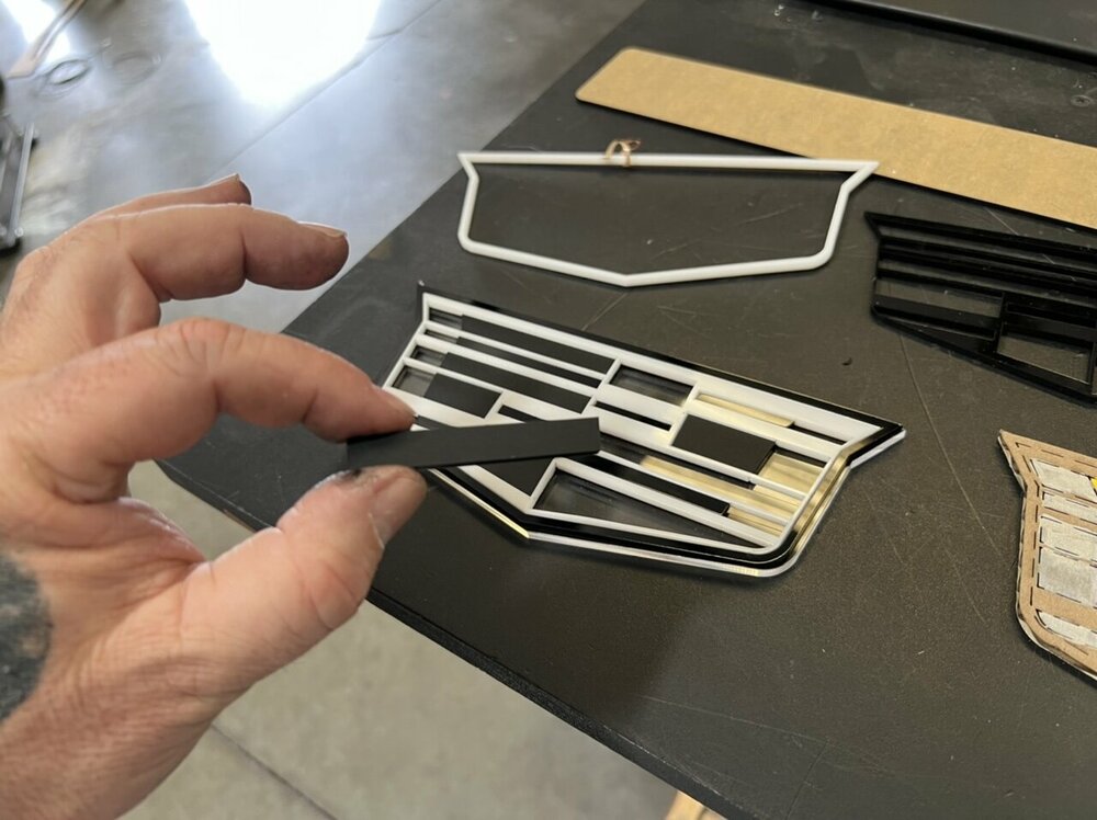

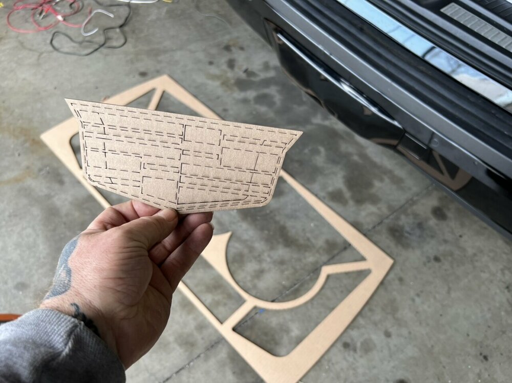

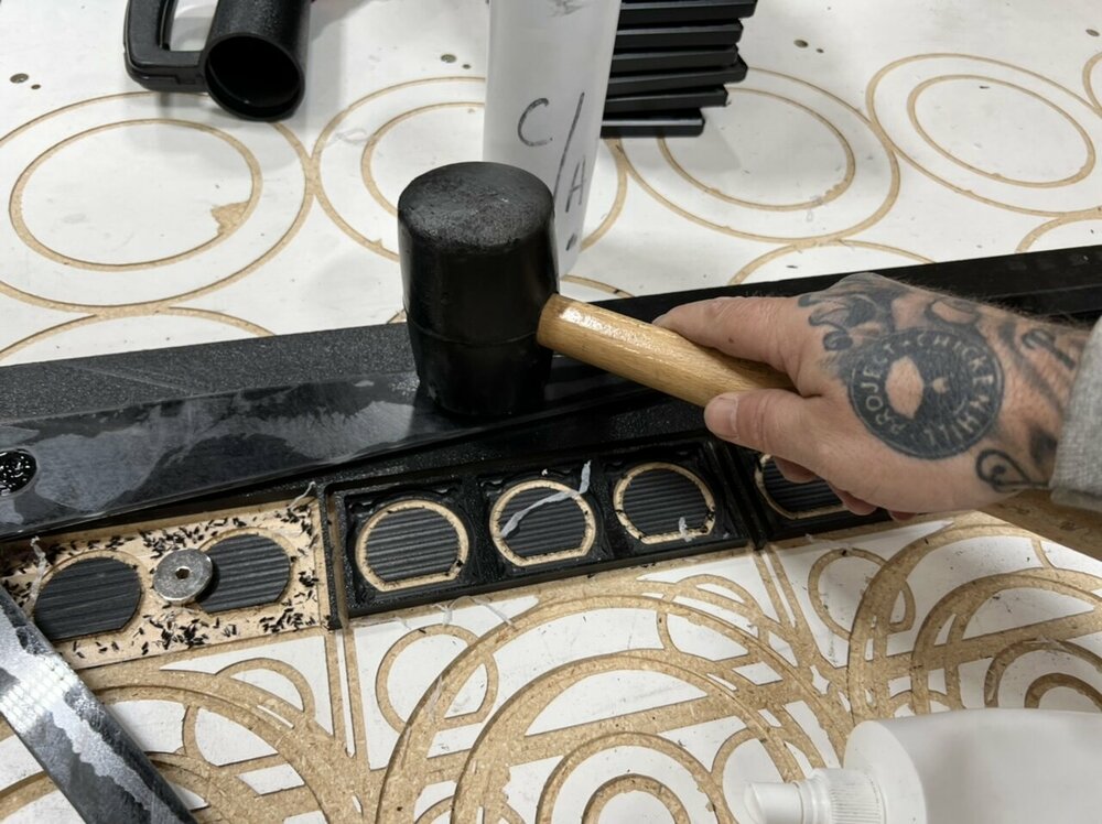

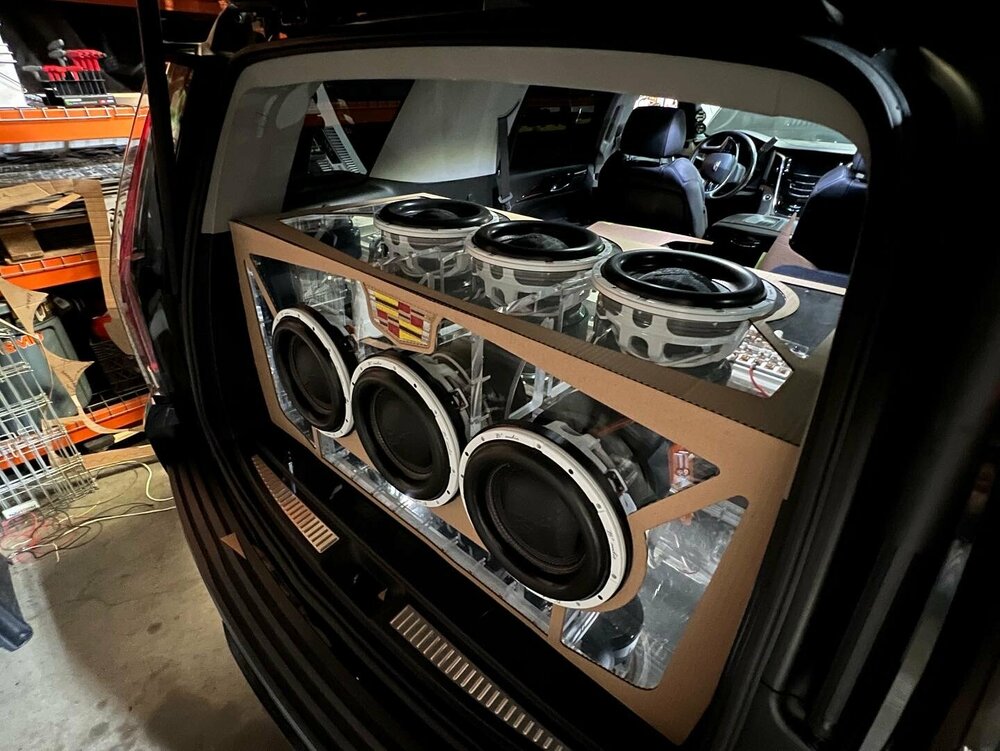

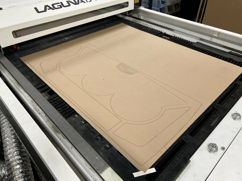

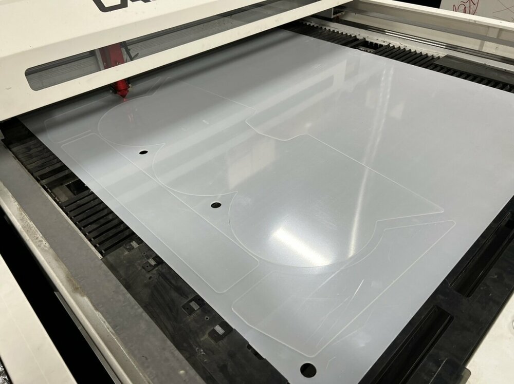

3/16" Clear with 1/8" matte black over the top.  The holes are for neo-magnets.  Yup, neo magnet removable trim panels.  Something that i came up with YEARS ago that lots of people do but nobody ever gives your boy credit.  Oh well, if you know you know.
Follow my Tweet (Twitter)

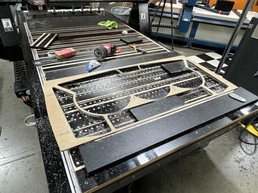

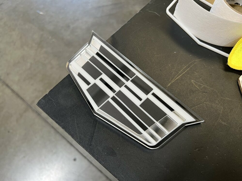

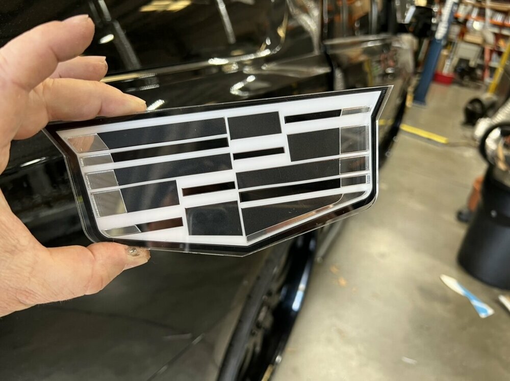

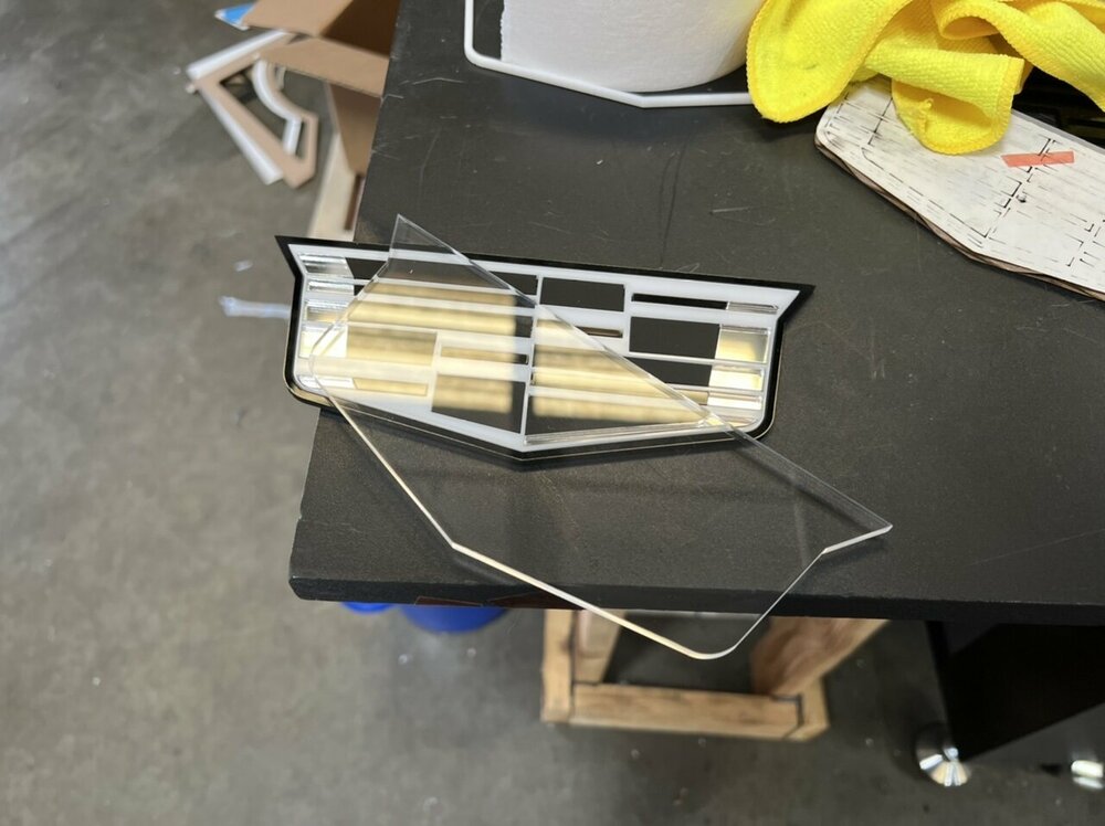

there is about 10 different ways i had in mind to do this logo...but i need to get this job finished. So i am going to go with this for now.  I have made it removable so i can get it out and make something different if i don't like it. So far i LOVE IT.  White, matte black, gloss black, mirror and clear.  Just enough of an offset to make it look grey-scaled out.
