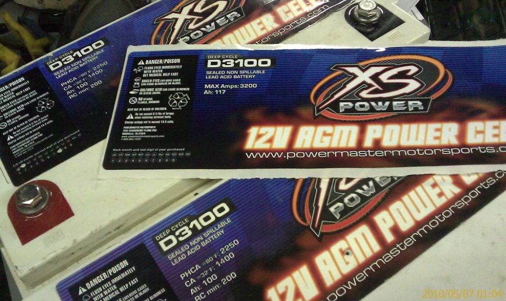

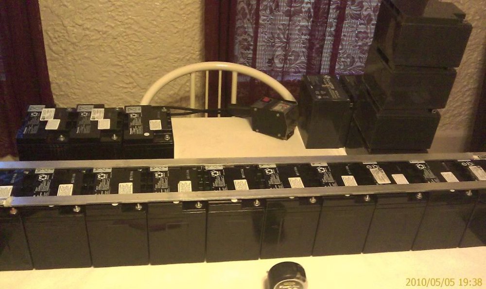

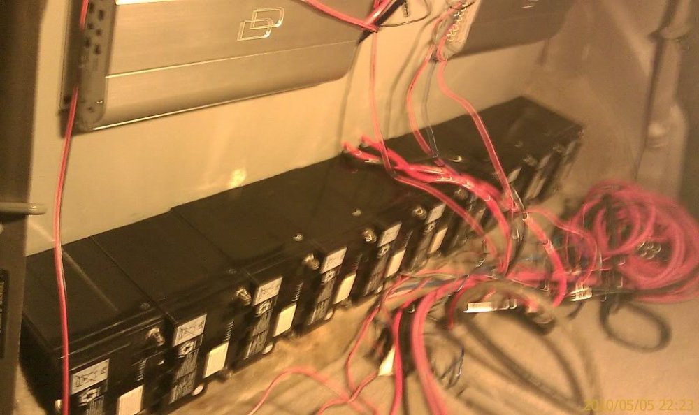

audiofanaticz Posted January 30, 2018 Report Posted January 30, 2018 a low internal resistance is also key Ive tried a bunch of batteries years ago, something like 22 of some smaller sized agm batteries (used in XRAY machines). I lost over 1 db from them. Even with way more reserve and more battery power in general my 2 old school d3100s where still better and louder on the termlab. By old school D3100s I mean the ones that were only 2250 PHCA (pulse hot cranking amps) not the 5000 max amps. These where even before the 3200 max amp rating like the sticker shows (my stickers got ugly and got some new ones from XS and they had a different rating than my current 2 d3100s), Even the AH rating was different from 100ah, to 117ah, and now the new series are 110ah I think. I had 2 rows of 10 stacked on top of each other, thats what it was not 22. I had to dig for some pics or else it would of bugged me. LOL Im not saying it will be the same case with those batteries but it is something to be aware of. Reserve means nothing really if you cant get the juice where it needs to go so if the discharge rate is slow its going to hurt you BIG TIME. That was my issue with the 20 batteries vs the 2 old d3100s
