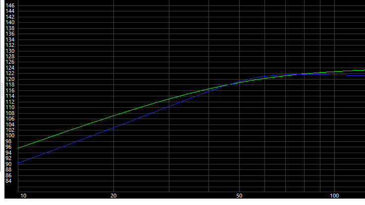

Hey, did you happen to do the graph on the 4 JL10w0v3 1200w to the e10s 2400w sealed?
Blue line is the JL 10W0, green line is the Sundown E-10

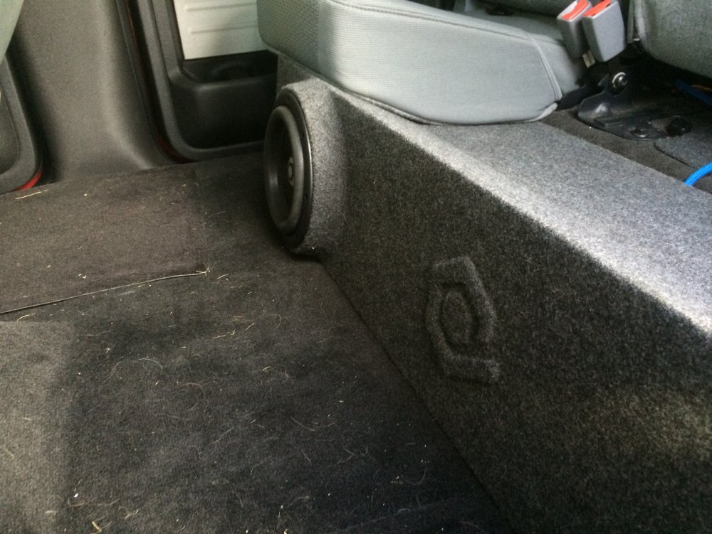

Coming from a 2013 but I beleive the back seat is similar. Without a seat lift this was the best I could do. Single 8 with around 1.25 cubes, took some extra work but angles the top of the box to match the seat to get every sq inch I could. 8 barely fit and still had to stick out for the magnet to clear the inside of the box.
