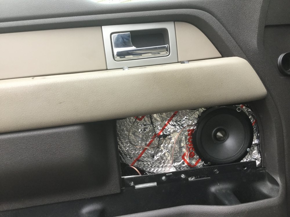

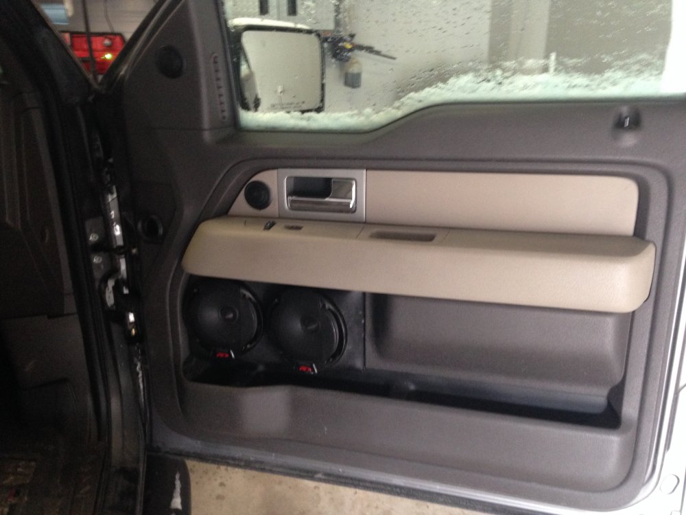

I’m reposting my bolt on door pods I made earlier lost all pics because of the stupid photobucket bullshit. So here we go . If u own an old body style F150 the speaker grills are huge and a giant waste of space .

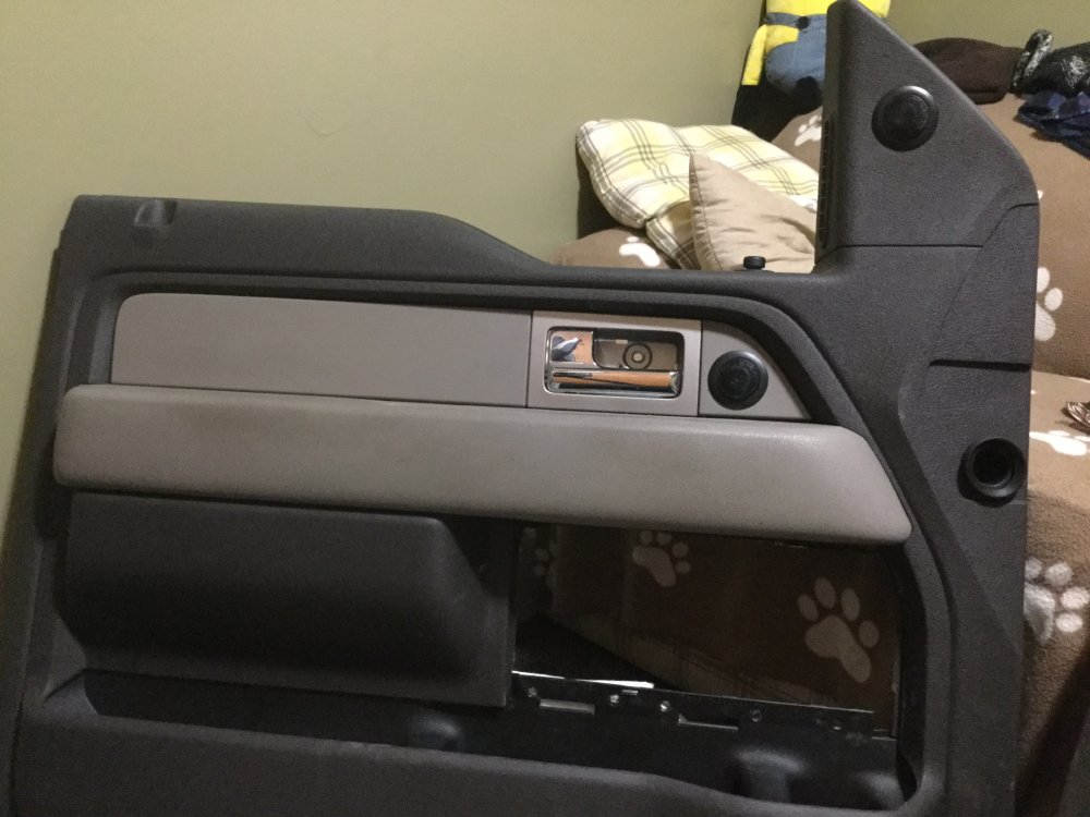

All that wasted space , so I got to work

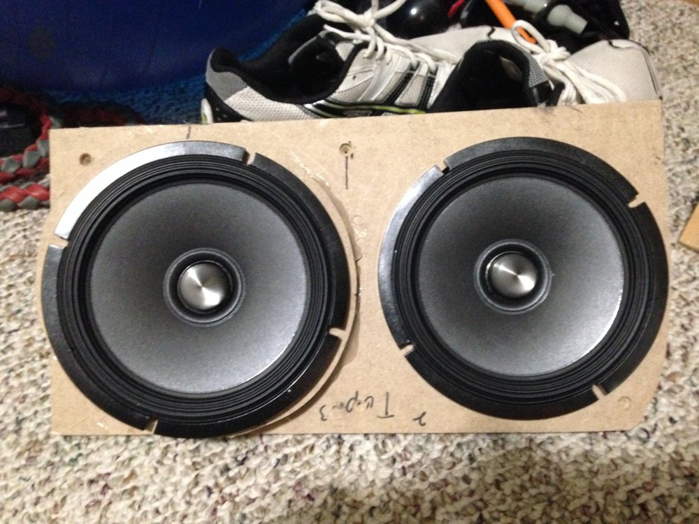

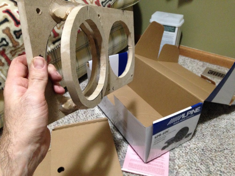

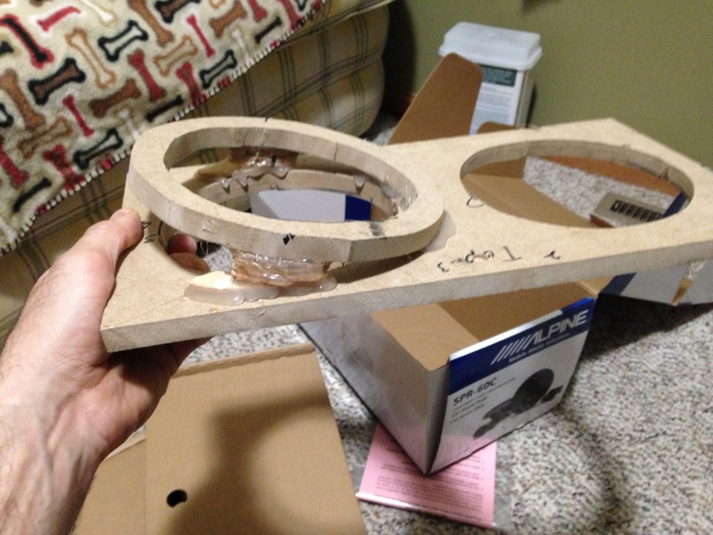

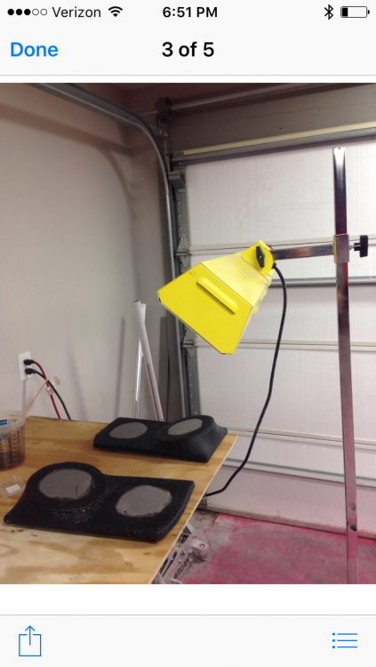

That’s my quick mock up now to fiberglass, had a buddy who’s a painter show me the ropes .learned a lot.

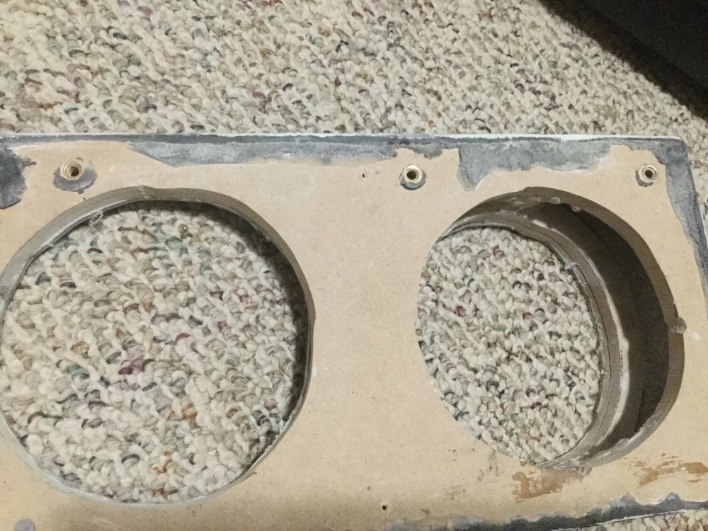

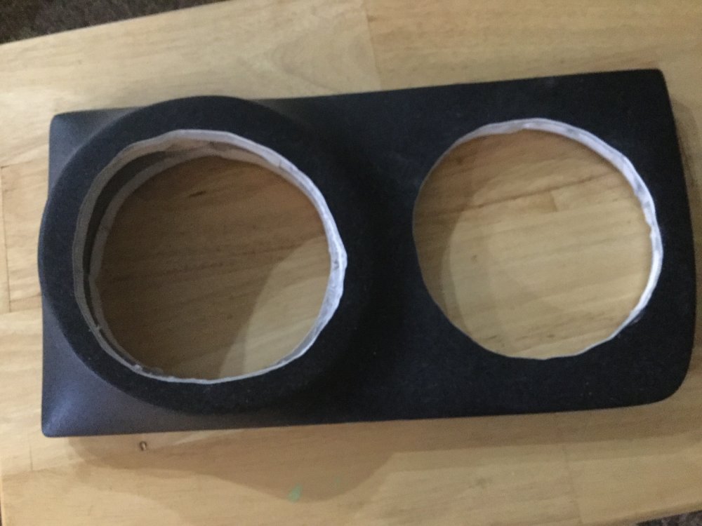

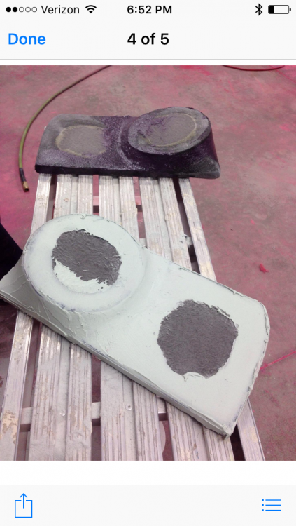

Finished fiberglass and mock up for bolt on

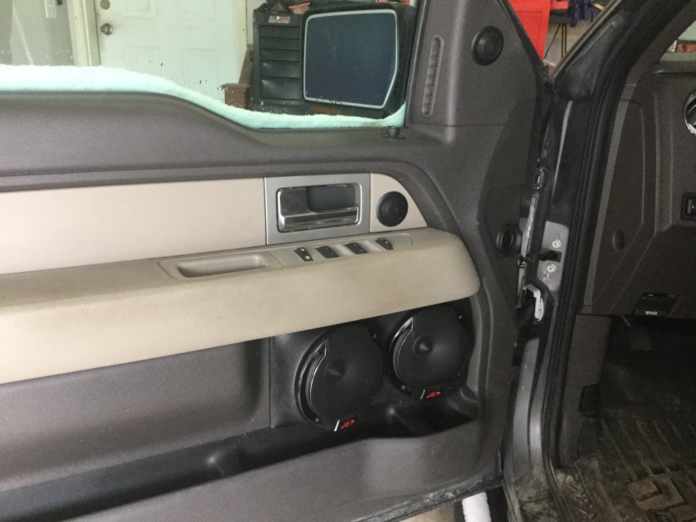

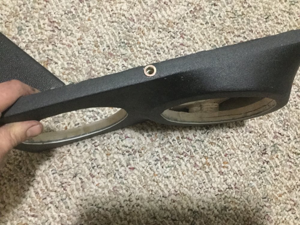

Ready for  install tweets mounted.

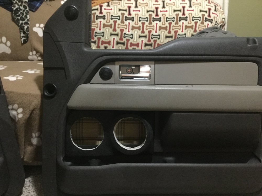

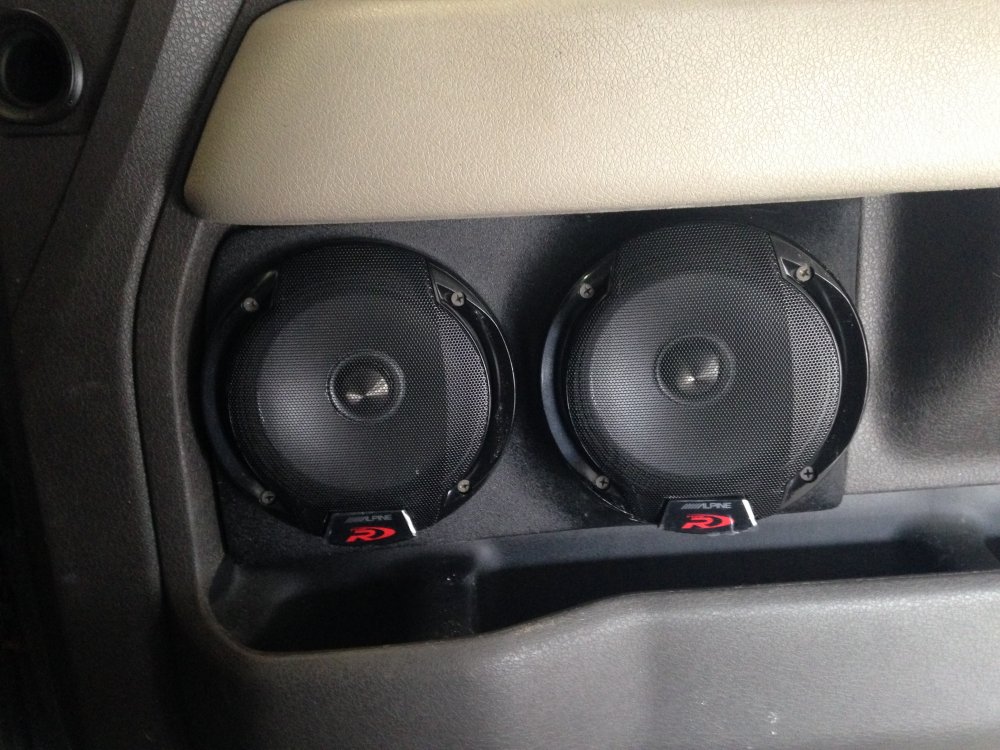

This is the finished product hope it helps some guys with ideas in case your afraid to start cutting shit up on your rides and not be able to go back to stock when u want to sell your ride.
Nice Work on those doors. Very Clean.
