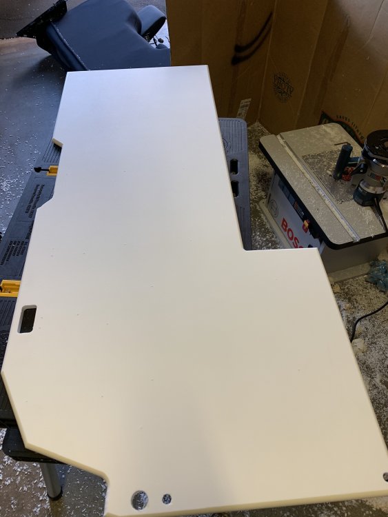

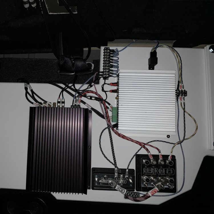

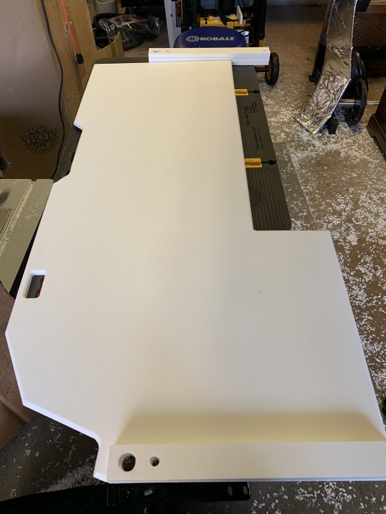

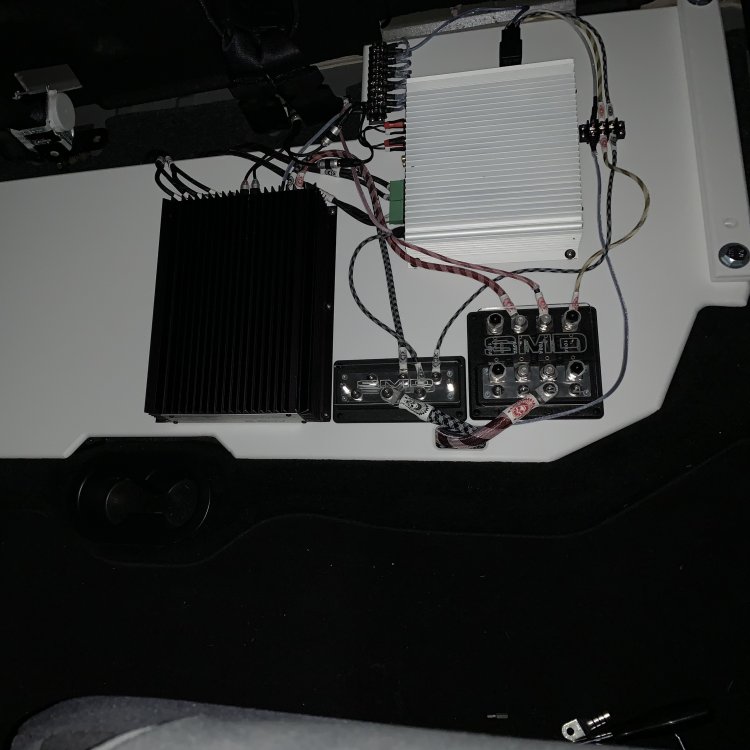

06RTCharger Posted December 17, 2018 Author Report Posted December 17, 2018 Finished and smoothed panel. With my custom selfmade seat lifts lol This close edge of the panel with be mounted under the seat with the bolts going thru it. The other end doesnt reach to the other ends bolts. So this closer side will have just two lifters ontop of the panel, for a total of 1.5inches of seatlift. Then other end will have three lifters for the same total lift. Bought longer bolts too.

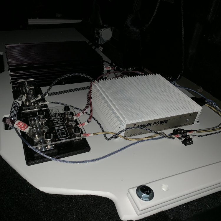

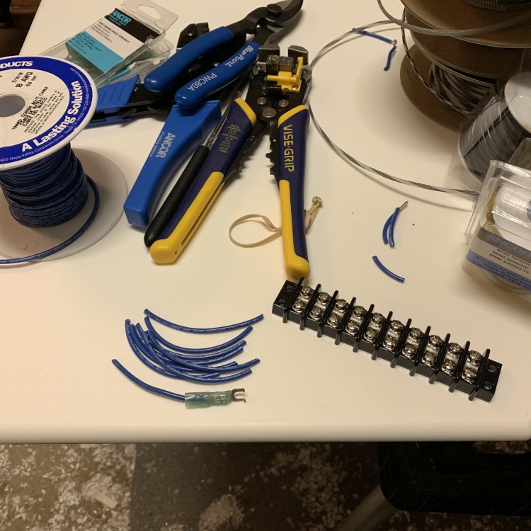

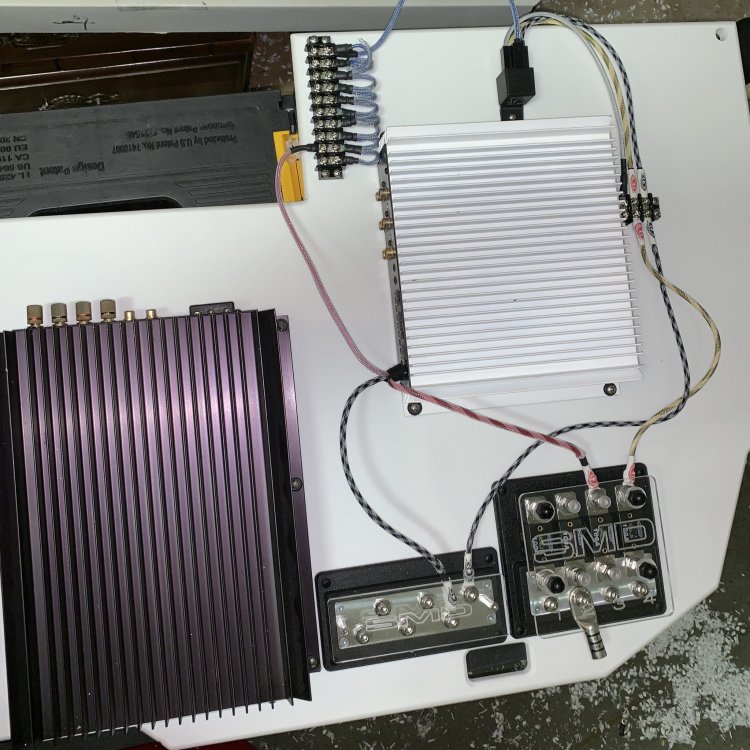

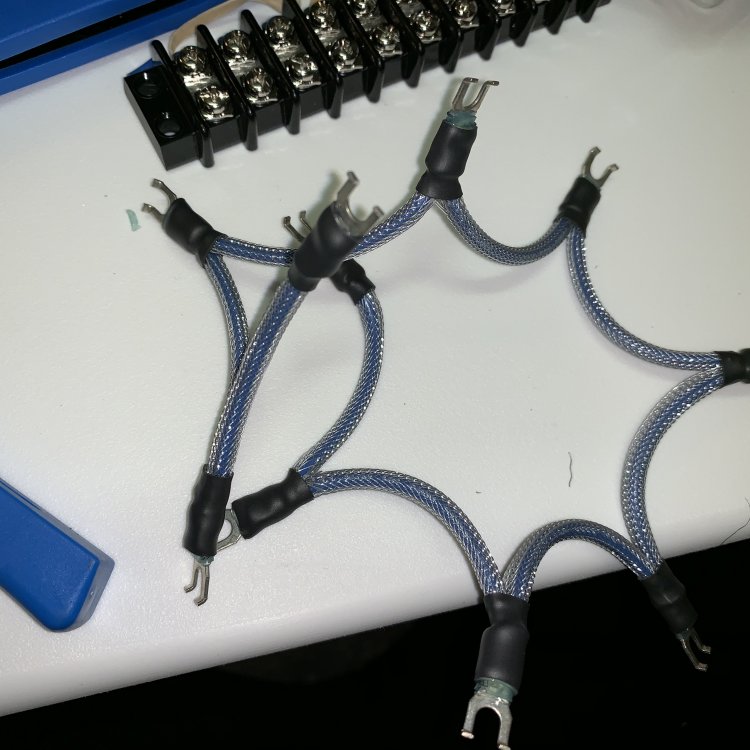

06RTCharger Posted December 17, 2018 Author Report Posted December 17, 2018 Started tryna make a relay distribution for the remote turn on wire. Cool lookin wire thing it turned out to be lol. Everything mounted down and ready to go back into the truck.

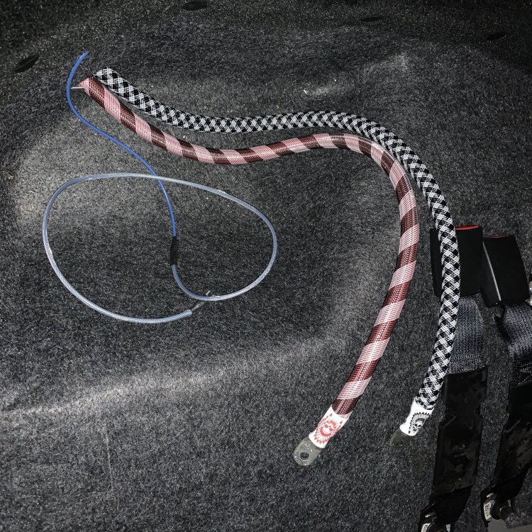

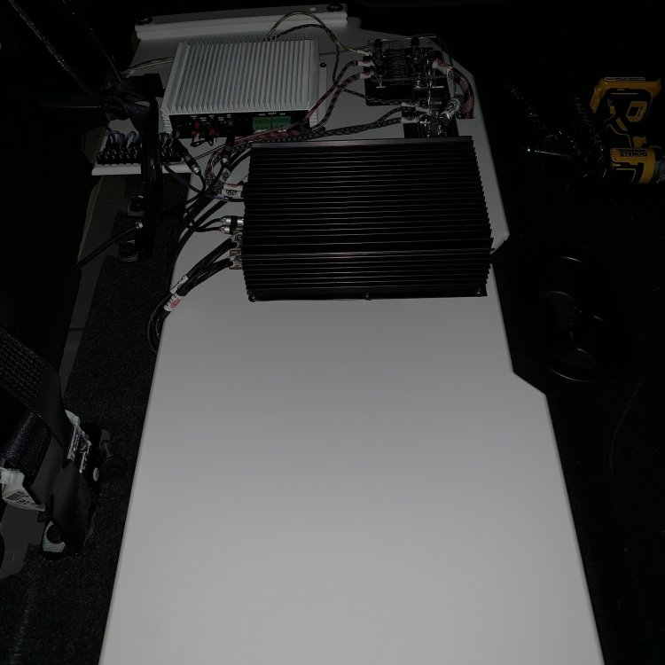

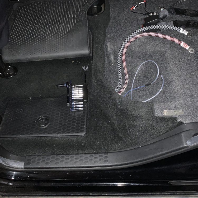

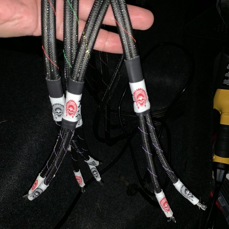

06RTCharger Posted December 17, 2018 Author Report Posted December 17, 2018 Prettied up the speaker wires. Power and remote wires prettied up too.

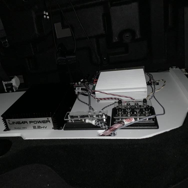

06RTCharger Posted December 17, 2018 Author Report Posted December 17, 2018 Amps, distros and relay mounted and ready to go under seat. Tested the panel by bolting it down and it works, fits and looks great.

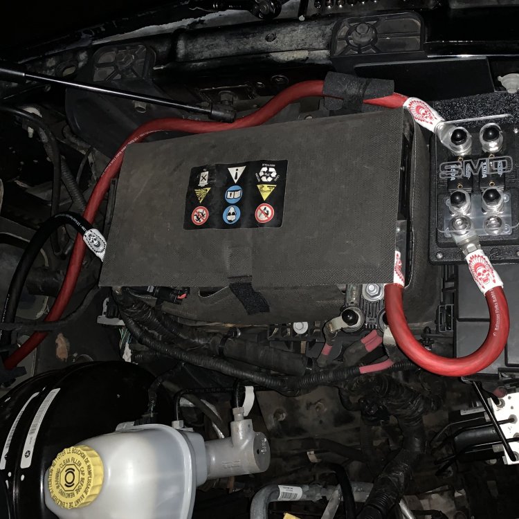

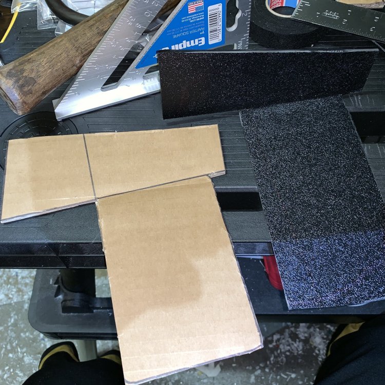

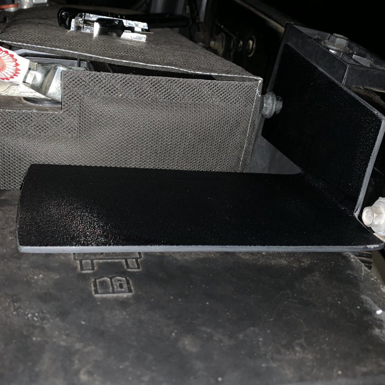

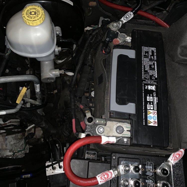

06RTCharger Posted December 17, 2018 Author Report Posted December 17, 2018 Since i was about to have more power draw now with two amps. I wanted to make sure i fuse it uo front first. So i made a card board template then cut it out of abs, bent it with a heat gun and sanded the edges smooth becuase i used to razor and hammer technique. Score a bunch of lines where u want the cut, then hit it with a hammmer to break it off lol worked good.

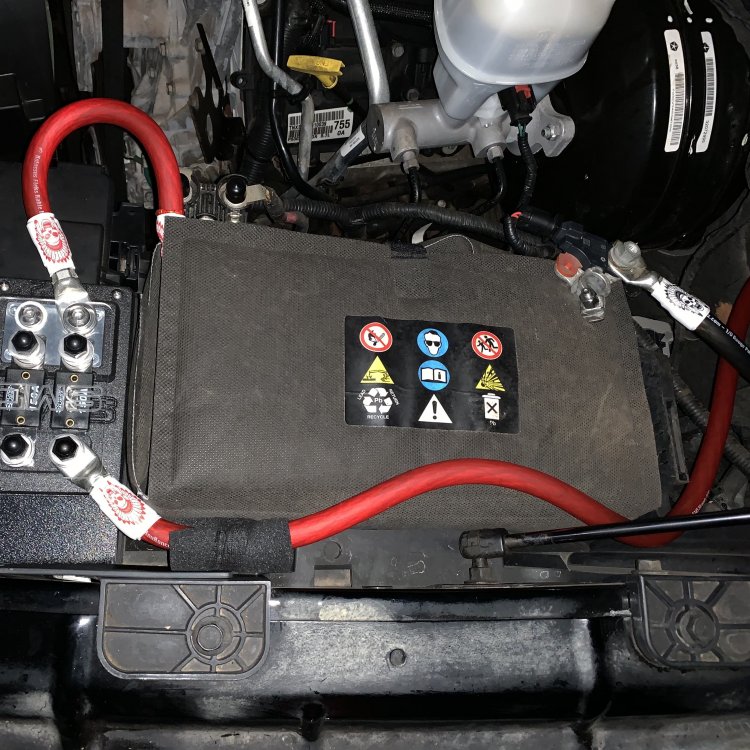

06RTCharger Posted December 17, 2018 Author Report Posted December 17, 2018 Fuse block mounted and wired up. I chose this location becuase the bracket i made floats right above the trucks fuse box and the bolt location allows me to rotate my smd fus block up and out of the way without removing or unbolting anything, id just have to slightly loosen the bolt that holds my bracket then it can swing/rotate upward easily.
